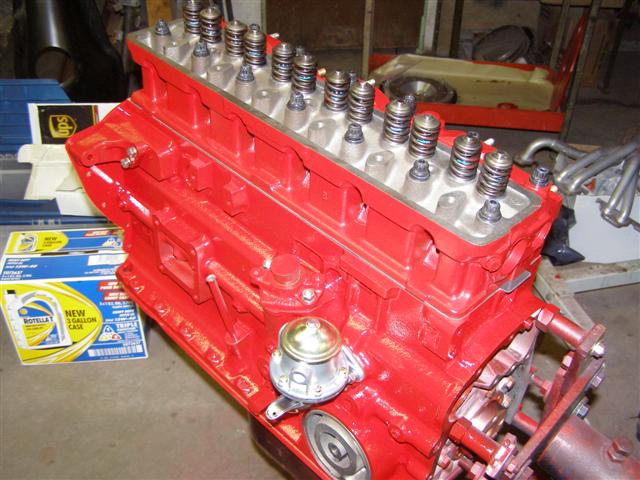

Hey Boss,
Here's a picture of mine, prior to torquing head down.

I have ARP studs in my 1500 motor and I do not remember running into this problem? Is it only because of the engine lift bracket? Does the engine lift bracket serve any other purpose. Im sure My front bracket was a part of the alt mount and dont have a rear one. Never have. Perhaps thats the difference?
