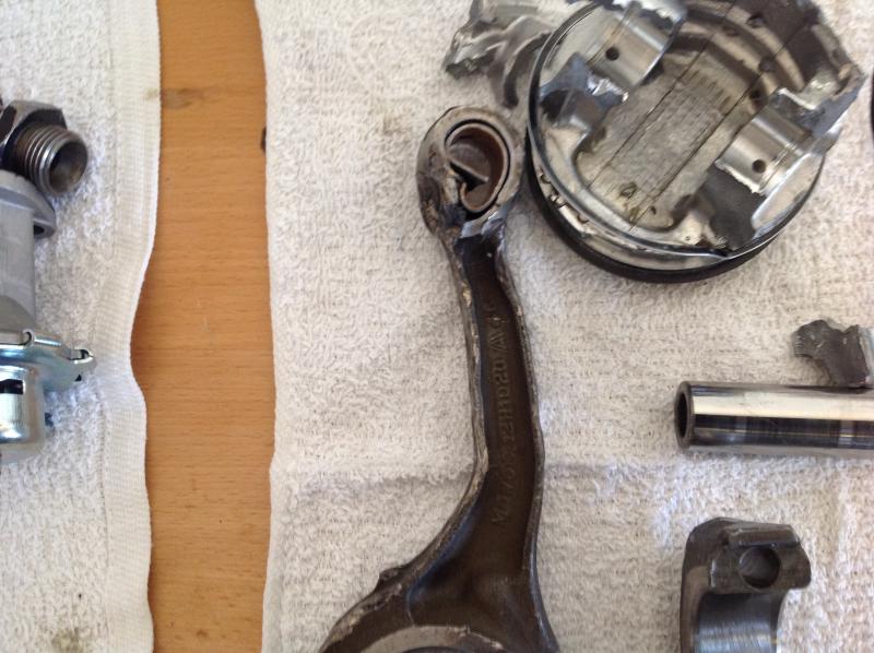

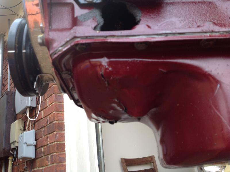

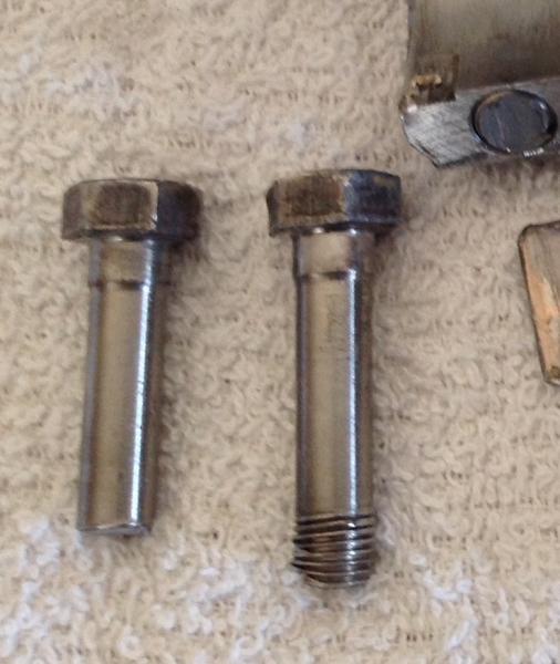

I've built engines with and without ARP studs/bolts and the only failure I have had was on an MGB original rod bolt. To me rod bolts are a must have ARP since a broken one causes catastrophic engine damage...head and main bolts not so much. Standard practice from the leading engine builder that I get my parts kit from is all ARP, nothing less...cheap insurance. On my TR4a engine build I'm using Maxpeedingrods and they come with ARP fasteners.
