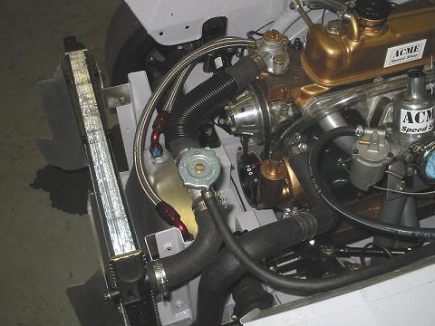

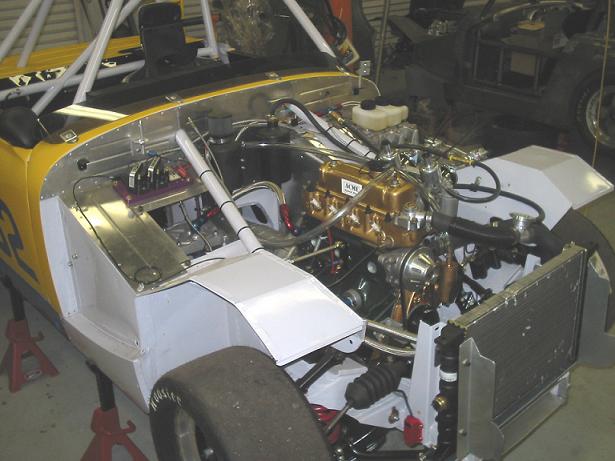

I wrote this up before here, but here goes agin, I get rid of the original radiator shrouding and use VW radiators in my Midget races, it's 77-80 VW x-flow Rabbit w/o AC, I use the Valeo brand, plastic side tanks, with a aluminum core, weights between 4-5 pounds, cost a $100, it pretty popular conversion with the SCCA guys. Her's some pictures of the set, best cooling radiator I ever run, runs so cool you don't even need duct work.
This is great info!
Thanks
Yes, 75 Midgets have cooling issues.
Looks like this conversion will do the trick.
