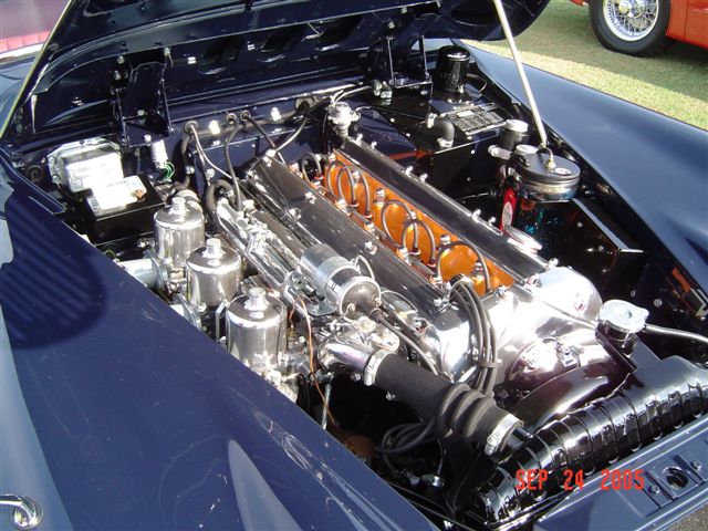

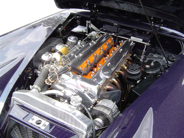

This is a pic of the 150 with the Griffin radiator. It is a quality piece and yes it was about $900.00. I don't think a properly rebuilt stock S engine really needs it. But this car is not stock as one can tell by the alternator and the power steering fluid reservior.

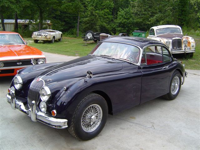

This is a pic of a stock 150S Radiator. So far it is keeping the engine cool but I only got to drive it enough for testing before it went on the show circuit for the next year or so. It is the engine that received the nice Ross pistons.

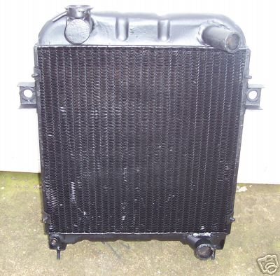

I did remove it and re-installed it myself, so I saved a bit on the R & R job, not to mention I did it very carefully because it's my car and I wanted it perfect. I also installed a new Water Pump and Thermostat as they and others recommended. (mine were very old anyway). Before filling the system, I did a Prestone Super Flush, drained the system, then did a water flush, drained it again, then filled it with a 60/40 mix of Prestone Coolant. (60% Coolant, 40% water).
The result? I have noticed the engine does not get as hot as before, the temperature is more stable and predictable even in bumper-to-bumper traffic, I like to drive my 'S' type no matter what! Perfect temperature? no, the 3.8 engine runs hot no matter what, but it is better now, much better.
I am not putting down aluminum radiators, only the price. My understanding is that the small benefit you get from an aluminum radiator is not worth the extra expense, and with the savings, you could install an Electric Fan kit...

Exotexs, I also have a 3.8S (image in the photo section) . It is black with black leather and A/C so it needs all the cooling it can get. About 12-15 years ago I tried a 'modern' re-core but did not get the results that you did. By now there may be a more efficient core available. I plan on driving the S-Type again but not until I move out of the Metro Atlanta area. Driving for pleasure around here is a thing of the past.

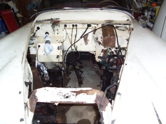

I don't have a shot of the radiator but the attachment is a progress shot of the underhood clean up. The attachment is AFTER considerable washings, brushing with strong chemicals etc. It is much better than when I started! It will be a long hard road to bring my car to anything close to your work. This was taken about a month ago.

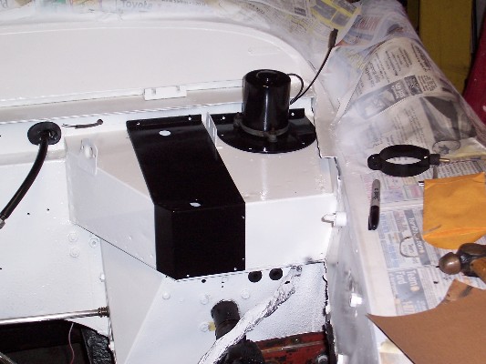

After more work, I am getting something to show for the work. Still a long road ahead.

This car started restoration as a fairly solid rolling chassis. Yes it is a long road ahead but the results can be outstanding.
