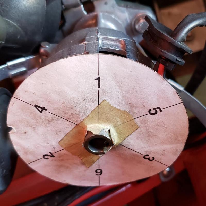

--if you remove the plugs and have the stock generator, you can turn the engine over by hand using a wrench on the generator nut while pressing down on the fan belt.
--you can divide a circle in sixths and make a timing disc (photo). You can google an image for a circle divided into sixths.
--position the #1 cylinder at TDC with both valves closed (observe a little play in both rockers), position timing disc mark lined up with a designated reference point (such as the left side of the square hole here) adjust valves, then follow order of timing disc for the rest. It takes two full turns of the crank, but you get both valves at each numbered position.

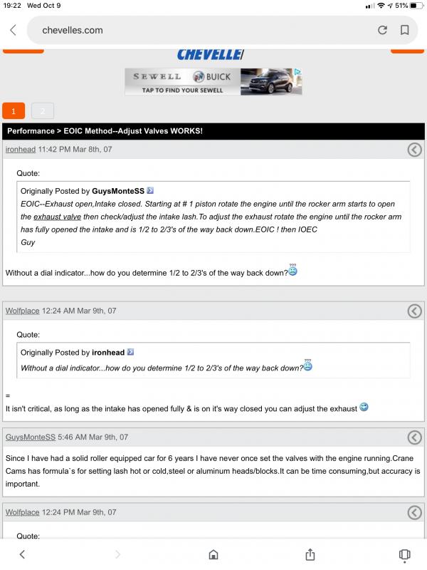

Try this, EOIC method.
https://www.onallcylinders.com/2012/02/28/lashing-out-how-to-adjust-valve-lash/

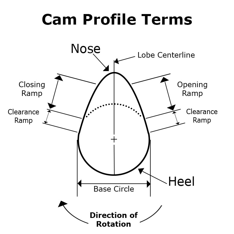

I have attached a generic picture of a cam profile, half the rotation of the cam is in what is called the base circle in the diagram, if the lifter is resting on the cam anywhere in the base circle valve clearance will be the same and can be set precisely. In other words if you are just learning this procedure, the seat of the pants method of watching the opposite valve identified by the rule of 13 and stopping when the opposite valve (as opposed to the one you are setting the clearance for) appears to be somewhere around fully open or pushed down as far as it will go by rocker arm, that is all the data you need to get a precise valve clearance setting.

Exactly what glemon said. This is not precision work. There is plenty of leeway on the cam to do the valve adjustment.
And not to complicate matters, if one set of valves is at overlap, about equally open and closed, you can do both intake and exhaust on the corresponding cylinder that has fully closed valves (firing).
Overlap is easy to spot as one valve is opening and the other is closing.
... the seat of the pants method of watching the opposite valve identified by the rule of 13 and stopping when the opposite valve (as opposed to the one you are setting the clearance for) appears to be somewhere around fully open or pushed down as far as it will go by rocker arm, that is all the data you need to get a precise valve clearance setting.
