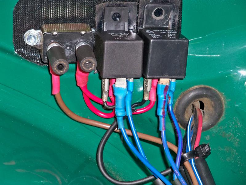

I have a Delco alternator on my TR6, so I tapped into it's 12 volt terminal for the battery connection. That's where the Brown (N) wire connected to the circuit breaker is connected.

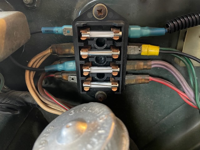

The top slot in my fuse box was empty so I used it. The original headlight circuit is second from the bottom. The brown wire on the left is power (from the alternator/battery) and the purple harness on the right runs through the dash switches and feeds the headlights. I jumped the brown wire (3rd row left) to the empty slot (top row left), added a fuse, and then ran two wires from the fuse to the relays (top row right).

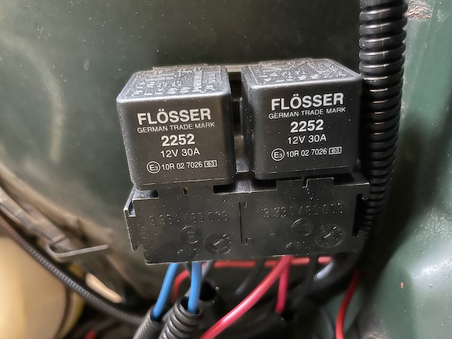

There are two relays, one for the high beam and one for the low beam. Each relay controls both sides. I mounted the relays on the front of the wheel arch, behind the left headlight, because it was easy. Each relay has four wires: power (from the fuse box), switched output (to the lights) and trigger (from the switches inside the car), and ground.
The power is a straight line along the edge of the hood from the fuse box. The ground wire is connected to any convenient spot. The trigger and output wires are connected into the existing wiring harness.

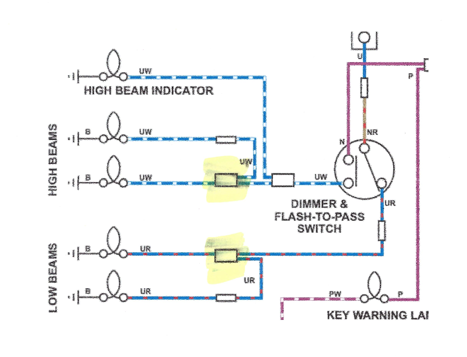

Here is a diagram of the wiring harness (for a 76) with the junctions highlighted in yellow. Note that on some cars the output wires from the connector are on the same end (with the source at the other end) and in other cars this isn't true. You should trace and identify (and label) all six wires before you start.
