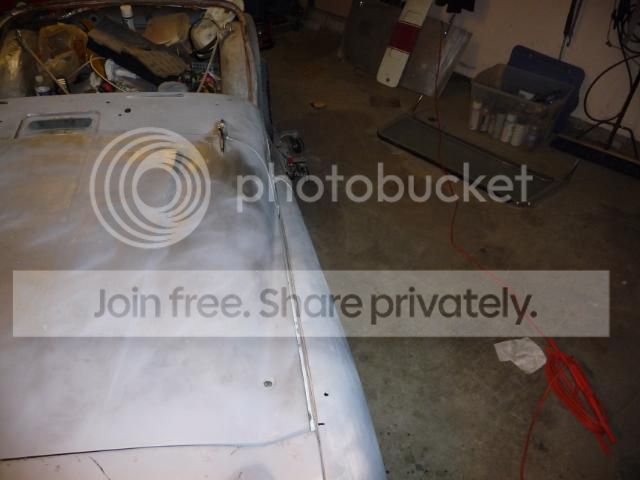

Played around with it a little bit tonight. Best I can get is about a 1/2 inch gap on each side. Might have to live with that.
Yes the front valence has been replaced at some time. In my avatar photo of the PO vintage racing the car, you can see that the valence that was on the car then has a small air intake under the original grill. The valence in the car now doesn't have the cut out or repair area so.....
Here are a couple of pics of what I have to work with.
I guess with a skim coat of filler some primer and paint plus the beading will take up a little bit of that gap....
Cheers,
David

I wouldn't worry about it. These cars were nowhere near perfect when new, and replacement body panels never fit quite right. My gaps are about like yours, caused by the replacement front apron.

How does the leading edge of the bonnet line up with the apron? Could the bonnet be bowed or the apron flattend out? I'm still working on my rusty shell and not quite ready to test fit bolt on panels. I measured my apron out of curiosity and came up with 46 1/2 inches. The front edge hood measures 46 1/8.

Looks just like mine does. It also looks like the gap is the same all the way up, which is the way it should be. When you put the bead on it will be a smaller gap. You want a little wiggle room to open and close the bonnet. You should be good to go.

Hey Dave,
It may be the angle, but it looks like the forward arch of the bonnet is slighlty higher than the arch on the apron. If it is, you can reduce the arch on the bonnet by pushing the center down to line up with the apron. That will have the action of spreading the front of the bonnet, thereby reducing the forward gap.
Of course, if it's just the angle of the photo and the two arches are even, then I would recommend altering the apron instead of the bonnet. The curves of the apron will reduce any distortion if you have to cut and weld it to size...vs. the bonnet, which has large flatter areas that will make extending and welding much harder.
All the above is dependent on you worrying about it. The bead hides the gap from all angles except dead on from in front. I was less critical with my bonnet gaps (compared to, say, the door gaps), since the flimsiness of the bonnet makes whacking it against the wings when closing it more likely. I did work hard to make sure the gap was consistent along its length, though, and centered evenly from side to side.

I have 2 aprons, a small mouth and a large.
My bonnett is 46"
Large mouth 46 1/4"
Small mouth 46 3/8"
I can see in your picture, the mounting points at the apron are a little bent at the captive nuts. You might straighten those and get a little less space.
