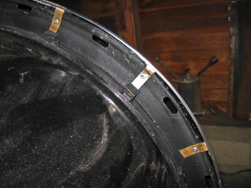

I totally agree. You might also consider pop-rivieting the beading right to the wings. It makes assembly and dis-assembly so much easier.
