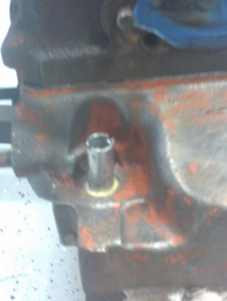

Bypass nipple on the underside of the head is broken off flush. Tried WD40, heat and "easy" out with 4 foot cheater to no avail. Anyone know what the thread is on the nipple? Seems to be sort of 5/8 but with a thread between fine and regular. If I can find the right thread chaser I can drill and clean out the threads. Otherwise, any good ideas on how to seal it? Weld patch, bash in a copper or brass plug?...... :madder:

Thread is 3/8" BSP, British Straight Pipe. Not tapered and doesn't match with SAE stuff. Matches with some JIC/plumbing and AN type threads. MM's suggestion is a good one. Use a Dremel tool and cutoff wheel and then a punch and hammer to curl the piece into the bore. Probably can drill with a 1/2" on the drill press to thin a bit more. I usually drill with a 9/16" on the mill and then thread for a 3/8" NPT plug since I'm usually doing this for racing purposes. If I've centered really well on the hole, the 9/16" drill will cut everything out and leave the threads in good condition. Just a cleanup with a dental style pick.

Being somewhat impatient.........I drilled out the aluminum with a 12" 1/2" bit. The chuck of the drill was up against the crank, as it drilled in it offset some and I was left with some aluminum on one side and engine block on the other. It was smooth and since there was no way the alum thread was coming out without some real effort I went ahead and tapped with a 3/8" pipe thread. Gobbed on some thread sealant and screwed it in. Fingers crossed.....hope for no leaks.
