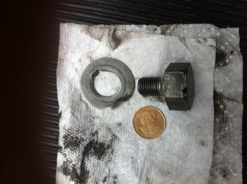

Is the locking tab similar to the big nut on the rear axle? Cause I don’t see anything like that on the damper pulley. I hope this wasn’t put on with permanent LockTite.
RickF
Locking tab is very much like the rear axle lock tab. You tighten the nut and bend the washer over one flat. The tab on the ID of the washer fits in a slot on the crank, you tighten the nut and then bend the washer up against one flat on the bolt. Here's a photo of a bolt and washer removed from the crank. IMG_3437.JPG
