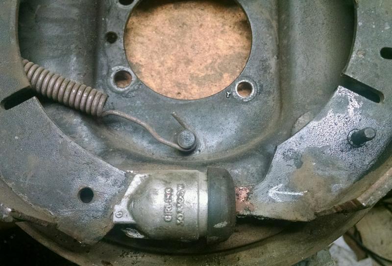

Chet - Adding to Randy's comment (maybe I'm saying the same thing) - since you already know the system is good as far as the bottom of the hose, suggest clamping hose there, tightening the shoes tight, then cracking open the adjacent tube nut. If you bought or have a plastic syringe, you could push new fluid upstream from the bleeder screw and force the air out the cracked tube nut. Be sure to wrap the bleeder screw threads with teflon tape, or pack grease around the juncture of bleeder screw threads with slave cylinder body - this will keep outside air from being admitted.
steveg
Addendum to above:
Looking at the inside, it appears that backing the shoes all the way off forces the piston inward (arrow). This would reduce the volume of fluid & air in the cylinder to the minimum, making bleeding easier.
Clamping off the hose, cracking the upper tube nut, then backing off the adjusters might have the effect of forcing some of the air out - this before you added any new fluid through the bleeder screw.
