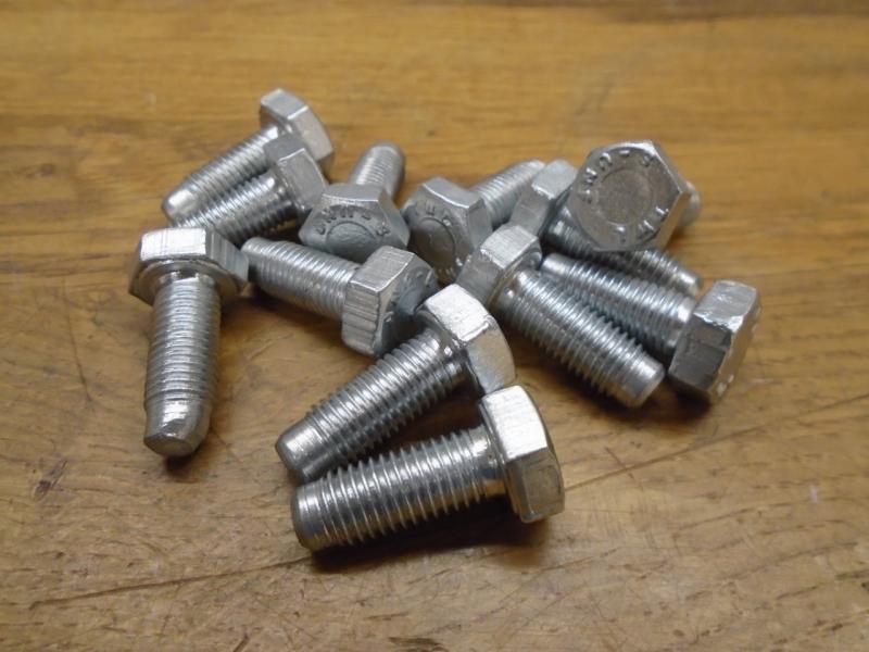

Steve presents some really good information if you want to try home plating. If you are serious, forget all the Youtube offerings using battery chargers, batteries, or wall warts. You need to control the current to get protective, rather than just cosmetic plate.
I've done quite a lot of plating on my Triumph motorcycle, and my TR6 car, including many of the fasteners. The British bolts have a distinctive head pattern that some people notice. Also, have you ever tried to find these bullet-nosed bolts at a hardware store, or even online? These are the replated 44 year old door hinge bolts. The bullet nose makes it way easier to get them started.
