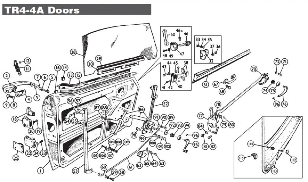

I'm beginning the long process of eventually re-painting my TR4. To start the process off I want to go through each of my doors and rebuild the channel padding,etc. I also want to PC the door hardware (items 18,22,77 in the attached picture). Mine are now body colored. The Moss catalogue showed the "B" post section of #18 and #22 as silver. Would this be correct for all 4 pieces? Especially the visible portion of the latch (item #77). Is silver the correct color?

My TR4 wears its original paint and those parts are unpainted. The four pan-head screws visible on the door jamb are painted body color.
