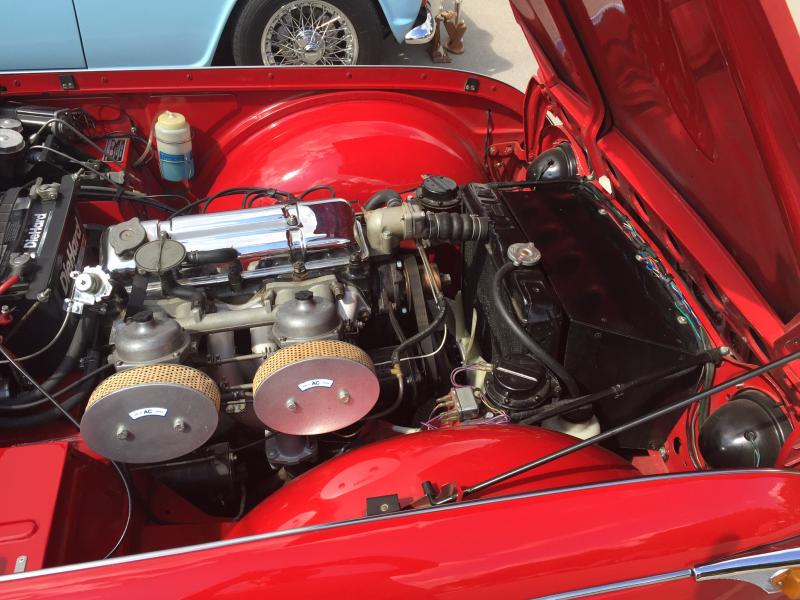

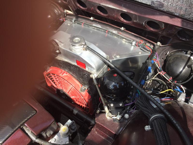

I took photos of some Triumphs at the British Car Show in Austin showing the shrouds they used to assist in their heating problems.

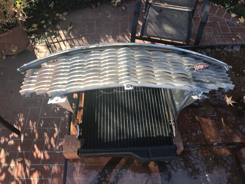

A bit of clarification on my terminology - The red Triumph doesn't have a "shroud" as such. The ducting in front of the radiator funnels air from the grill into the radiator and come stock on that model (although the ones you photographed are not original). The electric fans on the other two have a real shroud around the perimeter of the fan so that air isn't sucked into the fan from the side. The stainless steel flex fan supplied by British Car Specialists is what I'm referring to as a shroud.
I have aluminum ducting on the sides of my radiator funneling air from the grill into the radiator.

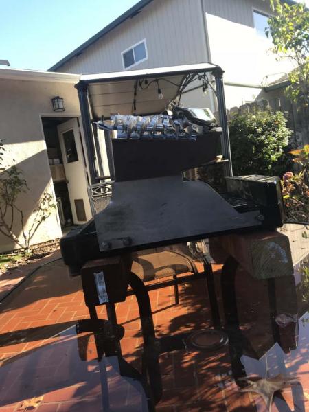

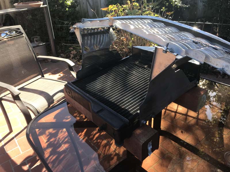

The front of the car is now apart, but it's much easier to see the ducting when out anyway.
View from top.jpgView from bottom.jpgView from bottom-left.jpgView from left side.jpg
Note that I have a Texas Cooler fan, not the one from BCS.

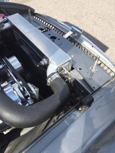

This picture was posted on 55Modified's thread "need help with custom air deflector for BN1" and reflects what I have been considering for my BJ8. Since Steve was the only one that was able to even approach sealing the radiator bulkhead, I am intrigued by the this approach taken by Healey for the 100S and, as you are proving, is highly potential.
It is clear to me that Healey engine/compartment cooling is a matter of managing air flow. To do this, it is necessary for air to enter through the grill and exit the engine compartment without diversion. Additionally, the smoother the flow the better. To do this, a fully encompassing box (sides, bottom and top) sealed around the radiator core. This approach would eliminate the cooling inefficiency at speed as well as heated air recirculation when stopped or in slow moving traffic.
The use of a fan shroud to diminish the loss of fan efficiency as a result of air leaking off the ends of the blades is critical to creating adequate cold air flow through the radiator when stopped or at low speed as well as sufficient rearward air flow through and out of the engine compartment. Additionally, by closing the opening between the lower radiator tank and cross member and a cove over the forward 1/3 of the frame bottom (approx. 1ft in front of the pan) will greatly diminish disruptive turbulence from hampering the rearward evacuation of radiator-heated air.
Note, the presence of bonnet louvers and/or fender bents will further assist easy engine compartment flow through and diminish the need for an aggressive fan.
Adding to cabin comfort, by sealing the cold and hot air ducts to the openings on each side of the radiator air enclosure box (pictured) will eliminate any hot air from entering/recirculating into the ducts. Also, the installation of a bilge blower in the cold air duct and the heater blower with the heater turned off, will pull volumes of cooling air into the cabin to make driving and riding more enjoyable.

My approach was more piecemeal. The 100S setup above (also per Randy's setup), in combination with a fan shroud in the back looks like a better way to go.
With the radiator out, one could start with the Kilmartin (BCS) shroud and figure a way to box in the entire rear of the radiator above the cross member, so the fan pulls from the whole radiator. The horns could maybe be relocated on the fender-well side of the side baffles, or moved back, BJ8 style.

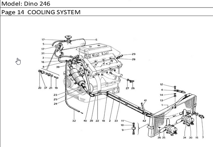

FWIW - Cobras use a couple of electric pusher fans and, IIRC, no puller fan. My neighbor's Dino 246 uses them lower down.
