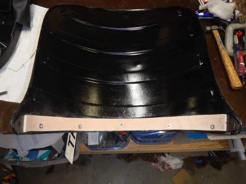

One part that seems to go fast are the seat pans and seat springs. I guess that's 2 parts!?! In fact, it is near impossible to find used in any condition worth using...I shopped Ebay and word of mouth for 4 years, and finally ordered these from Rimmer Bros. Again, only because of the exchange rate.
The bonus of getting new seat pans is they come painted. Hoorah! If yours are salvagable, they will still need to be stripped welded and re-painted. I have yet to see a pan that is not cracked around the rear bolt holes. The springs did not come painted, so I sprayed a coat of rustoleum over them to slow their demise due to occasional rain showers with the hood off.
