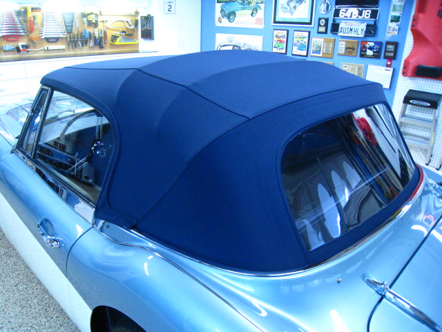

Robbins top's are top notch. I've had their Everflex and now their Sunfast top.
The fit and finish are great. Here's a photo of each on my car.

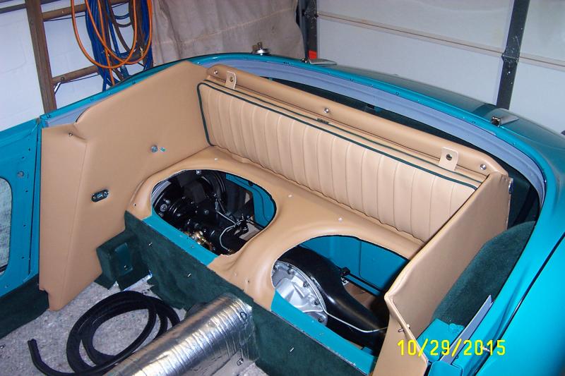

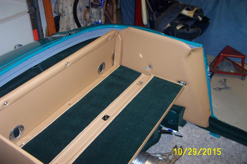

A couple of the hardest and most difficult pieces to do in BJ8 is the rear squab/fold-down shelf and also the seats. Most vinyl is thicker than the original stuff and you'll get into problems trying to use the thicker vinyl. It's very easy to spend $9k plus for a BJ8 Interior but if it's done correctly your car will reflect it the resale price should you ever want to sell it.
jjs64bj8
Patrick6jBJ8 is 200% correct in that the rear squab/fold down shelf is infinitely more difficult to redo that it initially appears. I have done several other (non Healeys) interiors in the past and this squab was a real challenge. I spent several weeks trying to get it reasonable using leather and vinyl looking at photos on line. If I had the $9K I would indeed probably go after the best, but the car is not going to be concurs and the money helps in other ways. So a less that perfect but presentable result is okay with me.
Attracted are a couple of photos as we start to assemble the interior. The squab is done and the seats are next.

A couple of thoughts for Interior info. There's 3 types of rear side panels with the first being for the Phase 1 cars. The Phase 2 cars have the early version with shoulder harness and the later phase 2 cars have the single large hole for the rear seat belts. Note: The black plastic caps for the rear seat belt hole covers are I believe the same for the MGC's. No matter which Panel you need the square grid lines on the side panels are the same for both vinyl and leather interiors. The reason I mention those grid line pattern is Heritage sent me plain smooth panels and we got into an argument about them. As it so happens I was right and the Concours folks backed me up as well as the Parts Manual. However, my wife is an Interior Designer and she said that the smooth panels work better with the smooth door and foot kick panels and the patterned rear panels would look outta place. I believe she's 100% correct on that. The first set of rear side Panels I received had to be sent back to be redone because the wood that was used was so stiff and would not bend properly and the metal front edge was bulging. The second set was done right but the foam was still thicker than the original.
For guys doing the Interior installation themselves should be aware that the Door and Rear side panels come with no holes in the vinyl and the holes in the wood do not line up! I was fortunate to have a gentleman assist me with tips and photos on doing my Interior in installation which I am forever grateful to.

Well jjs64bj8 ifin it ain't perfect it sure pretty----:applause:
