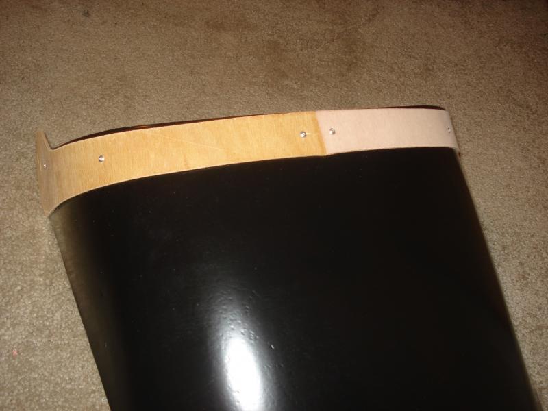

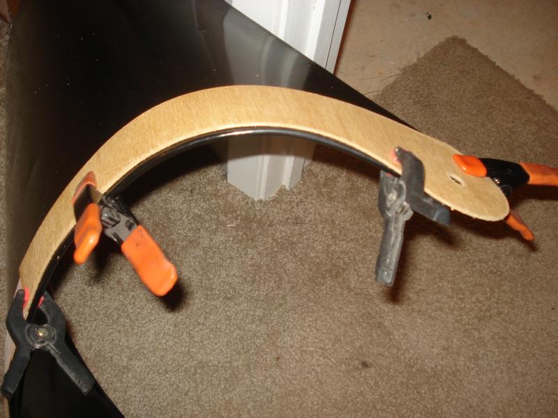

What is the application of the wooden plywood paddle panel that came with the seat covers for the 100? Info/pics would be appreciated.
RichsBN4
Please see my thread responses on page 2, "Front Setback Upholstery". Folks responded with some pretty good photos.
healeyblue
are you talking about these. They are tack strips for the upholstery.
