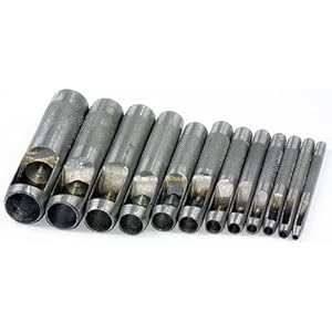

You can use thin cork or use an appropriate thickness depending on how smooth the mating surfaces are. Personally, I prefer to use Hylomar to what's been mentioned. I've never had it leak, it can be used more sparingly. When it comes time to take things apart (especially the thermostat housing), it's not such a nightmare. I also like to put a thin coat of anti-seize on the studs, especially on the aluminum housings.
I make a lot of different gaskets and find this kit is pretty useful to have around. I also make some custom punches. For larger hole I use the old school mechanic's trick of gently tapping around the sharp edge an opening.
