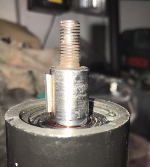

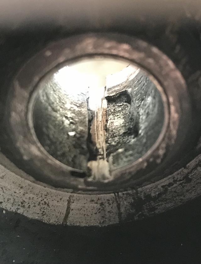

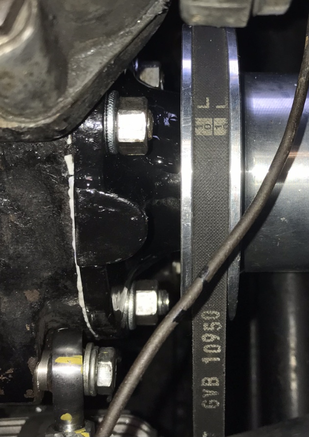

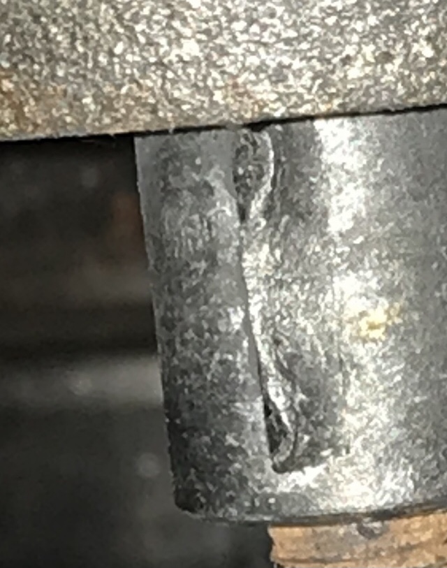

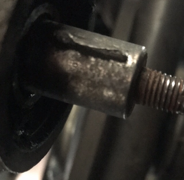

I had this with an ali thin belt water pump pulley. The pulley key way was wrecked. That’s it in the pics and did tap out also slot for the key way was ruined and the pulley was rocking and loose on the water pump shaft.
easiest was to take the pump off and deal with it on the bench.
new Ali pulley and a new key, bearing lock tight used.
I also swapped the bolt for a stud. This makes life a lot simpler in the future ( ensures you don’t need to touch it again !!!)
And don’t do the belt up too tight or it will go again.
