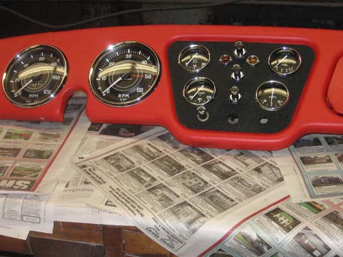

I used both 3M (in the spray), and Weldwood brushable contact cement on my leather interior.
One of the places I used the Weldwood was in the arch of the dash where the steering column resides. I had to use an appropriate sized socket and clamp to stretch the leather into position. If somethings not gonna stick, this would be the spot. The Weldwood has held fine for over a year now. Maybe it works better on leather then vinyl because it's more porous. I have no complaints at the moment.
