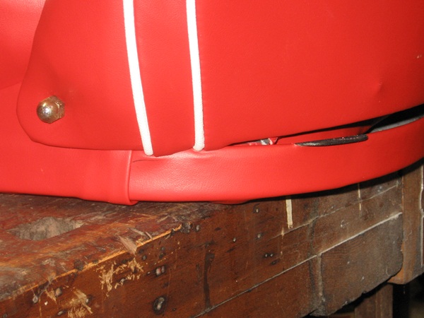

My seats pans were covered in vinyl, but when I redid the seats in leather, the kit from TRF came with extra leather to do the seat pans, so mine are now covered in leather...red leather. I don't think the pans would have looked good painted in red. As you can see in the pic, the thickness of the leather cased problems with the hinged seat not wanting to go back all the way. However, after it was sat in a few times, the problem disappeared.
