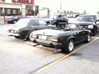

I also attached a meeting of old european cars at out local supermarket. The Saab owner was cool and we sat around chatting about our cars but I was amazed how small the Saab was.

I do love the little Saab in the pic, sporty looking and sounding
