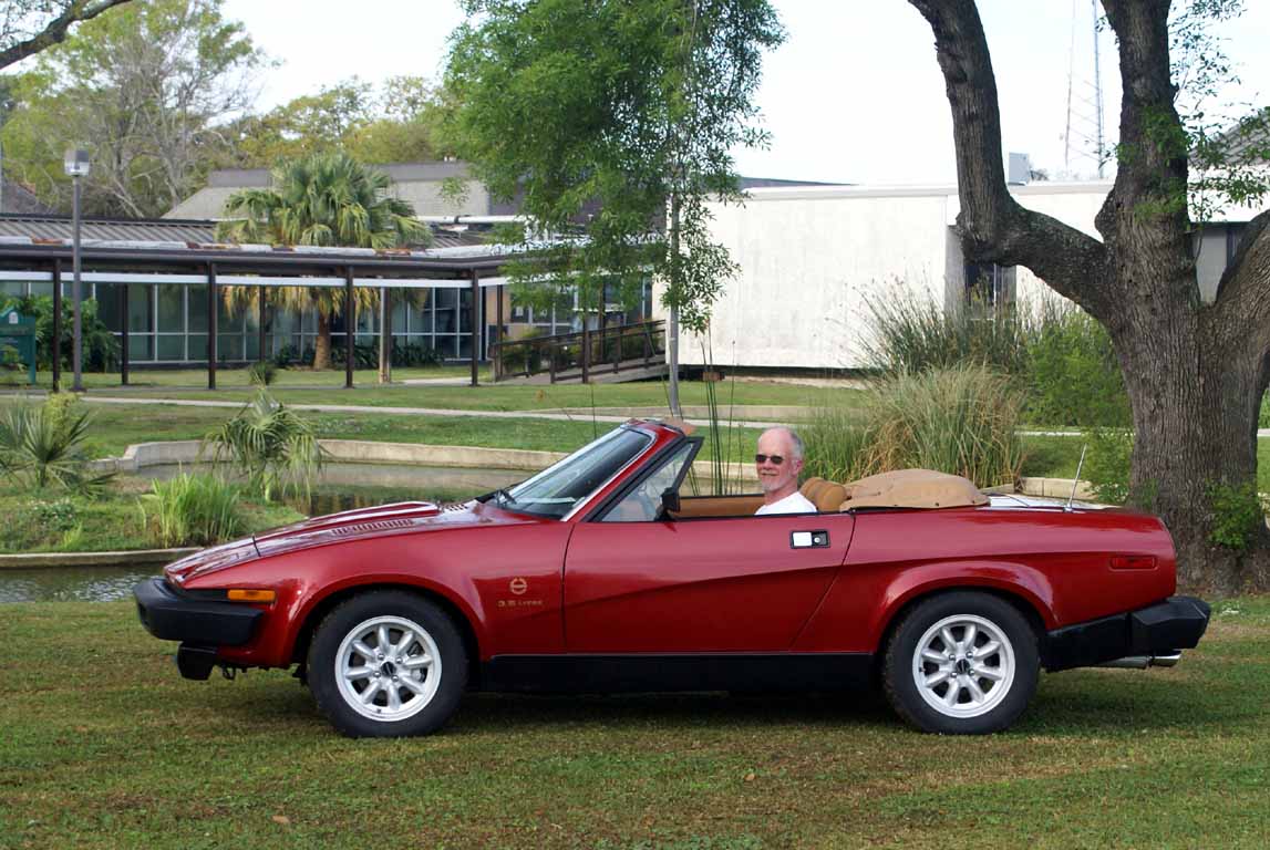

Mine has a couple glasspacks in the center, and two reverse-flow resonators at the rear. Great sound, yet pretty quiet. The resonators just fit behind the bumper, and I put two chrome extensions to dress it up a bit.
Here's a picture from the New Orleans show (pay no attention to the goofy-grinning guy at the wheel!).
