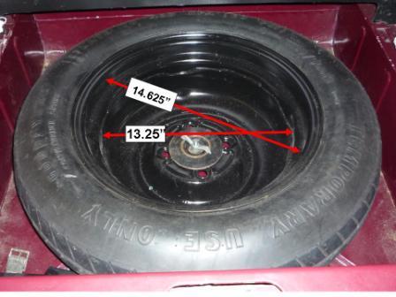

OK, here you go... the space saver I bought was from a '98 Acura (paid $20).
It is a T135/90D15. The bolt pattern/spacing is exactly like the TR6 wheel; 114mm or measured from the 3 o'clock stud to the 9 o'clock stud... approx 4.5 inches (114/25.4= 4.488 inches)
It will drag on the front caliper unless you have a wheel spacer to move it away from the caliper.
BobbyD was most helpful in helping me with this.

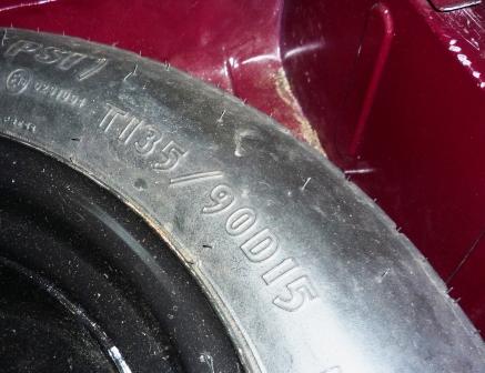

Gliderman8
The spare is T135/90D
T= Temporary
135= width in mm
90= aspect ratio
15= diameter

OK, I'm finishing a new page on my website for rebuilding the rear brake adjusters, so I'll get my space saver spare and check the size and if it's different, I'll post the dimensions of what I have.
That is if I can escape my wife's "to-do" list for a little while.
Brosky
I got a 20 minute reprieve from the domestic stuff.
I have a 125/70/D15 95MM.
My measurements are 14.5" at the first drop in the rim shape and 13.5" (tight) on the next drop.
The stock TR6 wheel has one major drop and it measures 14.25".
Do you think that I will need a spacer to clear the calipers?

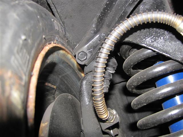

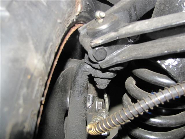

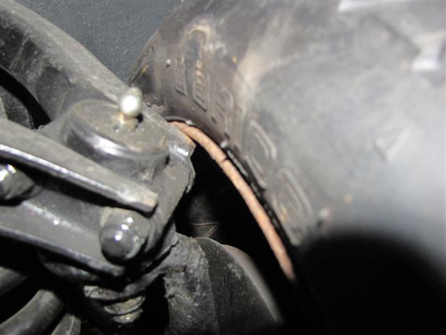

Paul,I am using a space saver spare as well and I'm using a wheel off of a Nissan Maxima 1985-1988.Marked on inner rim lip as J DotN 1407 6 16 Nissan 4TX15 AO300 28E00 It has the same measurments as what Gliderman posted.Tire size is T125/70 D 15 I did not have trouble with caliper clearence but did with upper A arm when turning from side to side.I use 5/16 spacers for the front,nothing in the back as that is a good fit.You can see in pics where the rubbing occurs when turning.

Gliderman8
Opa.... I just assumed it was hitting the caliper. I never gave it a thought of hitting the upper A-arm.
After I finish my present work on the car, I'll put the spare on the front and have another look. It's up on jack-stands so it should be easy to see.
edit: with the 5/16" spacer, did you have to get longer studs?
