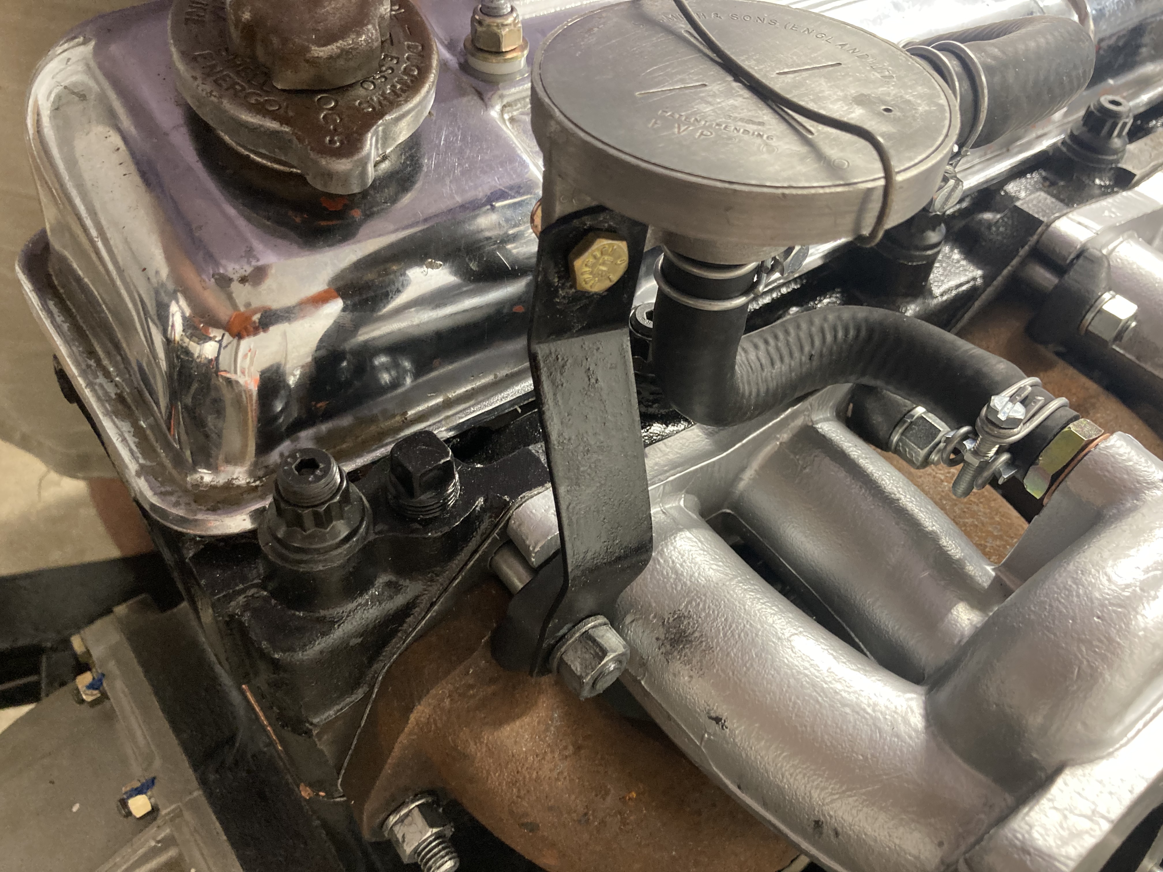

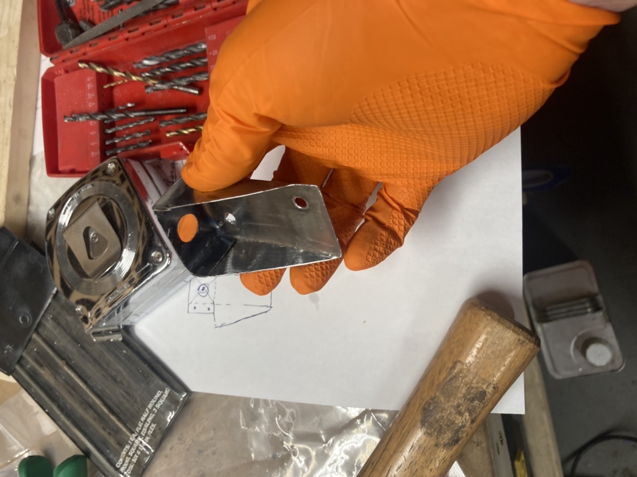

I also installed the egr system. My bracket seems to have a funny bend in it - but it works as-is (and the band seems precise if it was accidentally bent), so I left it be.

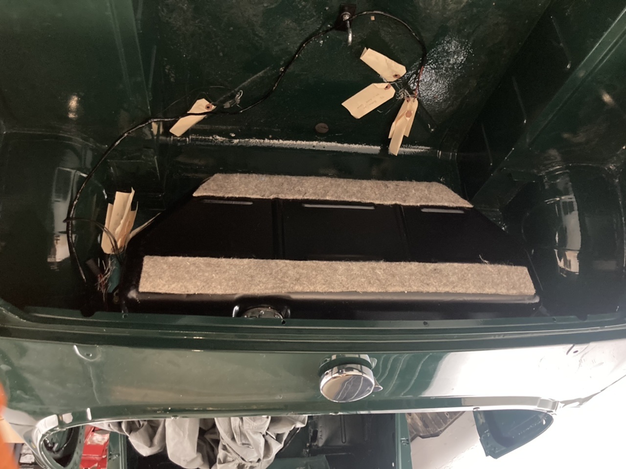

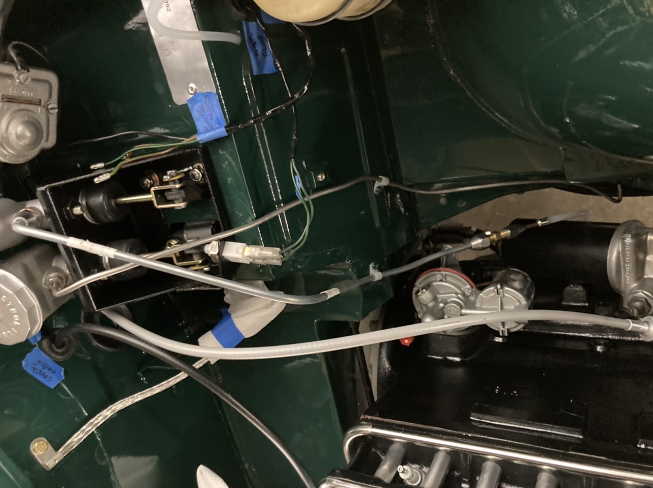

A few small updates: installing the wiring harness, pretty straightforward, once I got things positioned (I connected the panel voltage regulator and the big voltage regulator in the front - and this pretty well positioned the harness forwards/backwards). I had labeled every end of the original harness, and transposed to new labels on the new harness. This took a good bit of time! Interestingly, the old harness wire colors do not perfectly match the new, but the new matches the wiring diagram from Advanced Wire.

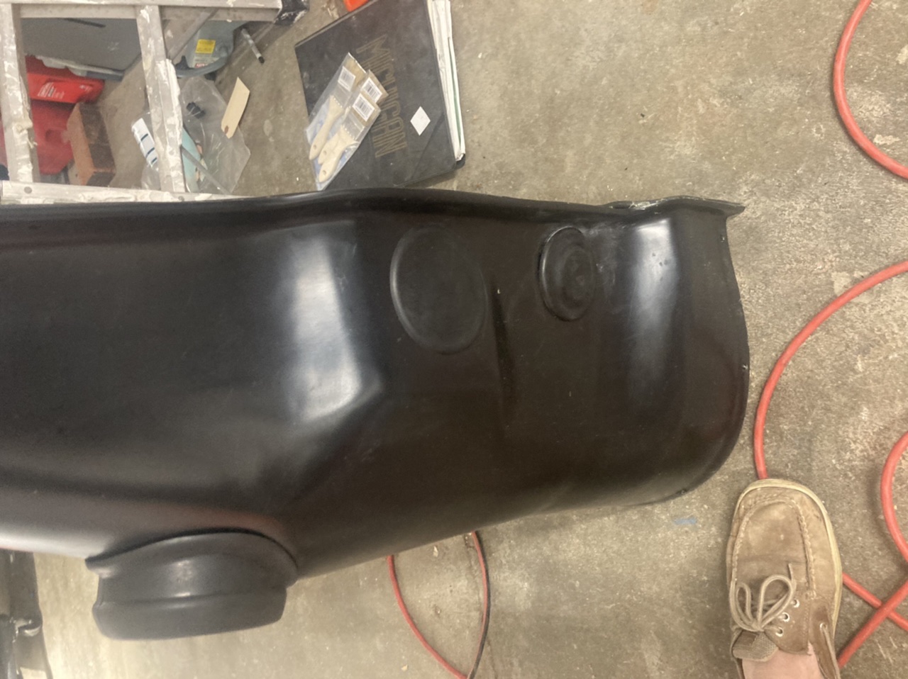

I installed the fuel tank, mainly because it is a large box on my storage shelf. I also put the spare tire in, for the same reason - to clear space in the shop.

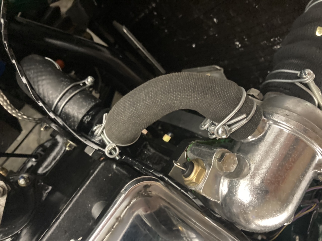

I received a new thermostat and housing from TRF, and the water pump arrived from Oregon. That part of the engine will be buttoned up shortly. As an aside, the new thermostat housing looks great. I expected I would have to do some finish work to match the other half, but no need! (The old one was significantly pitted.)

I am completing the cooling system. I got the pump back from the Flying Dutchman. I then promptly realized the keyway on the matching pulley was knackered (not part of the rebuild by the Dutchman; he only had the bare pump). I ordered new from TRF. There is discussion on the interwebs on matching key dimensions. The original pump has an 1/8” key and so does the replacement pulley. I also happen to have new a replacement pump, and it has a 3mm key (0.118”). I’m not sure how things would end up if I used new pump and new pulley? Anyhow, thanks to the Dutchman I don’t have to worry about that. (Less than $200 - and four months - for a rebuilt pump with an uprated impeller.)
One half of my thermostat housing was significantly pitted on the inside, so I ordered a replacement from TRF. I am impressed with the new unit: its finish matches the old. (I feared I would have to polish the aluminum casting on the replacement part - but instead I was tempted to polish the mating original piece! I decided that aluminum oxidizes pretty quickly, and installed both parts as-is.) I am using a sleeved thermostat (expensive!), despite some debate on its necessity vs an ordinary $7 item from a FLAPS.
Also a local radiator shop repaired a few holes in my radiator - ones I accidentally made while replacing my garage door… argh! (But $125 is much cheaper than near $500 for a replacement.)
After installing the water pump, I mounted the generator. I have a few extra bits from the TRF install kit (RFK638), so I need to study this a little more.

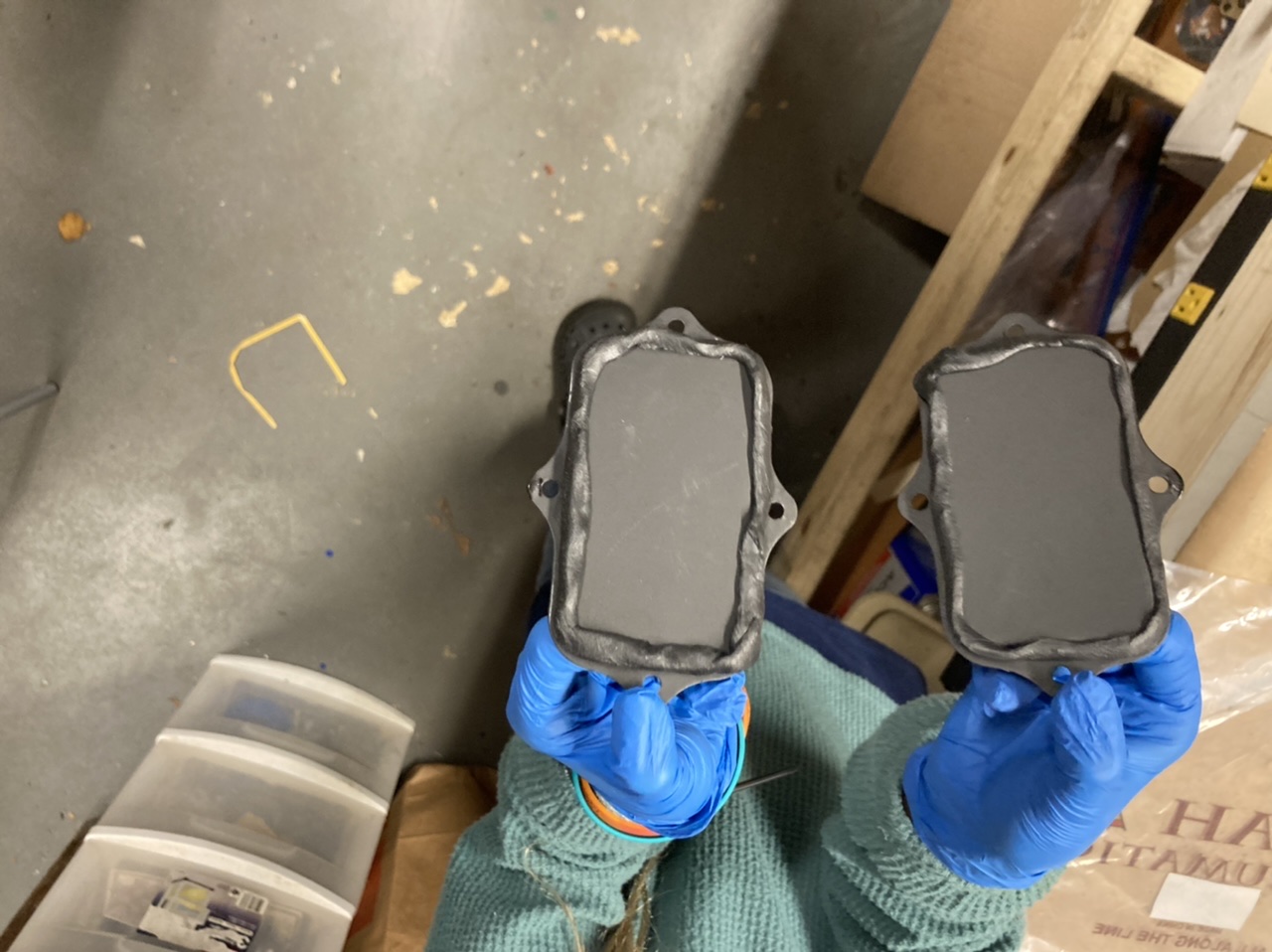

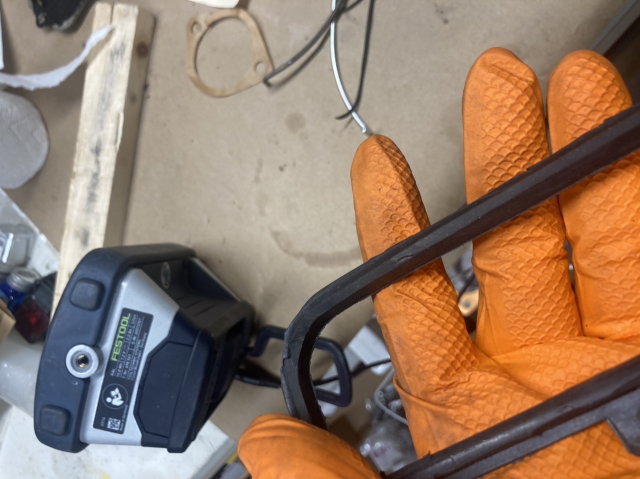

I spent this Saturday listening to the Triumph engineers in heaven (h3ll??) laughing at me: I installed the wipers. This task ideally requires four hands, each the size of a toddler with the strength of the hulk. …ok, it was not that bad, but challenging plus a few choice words, all the while trying hard not to scratch the new paint.
The wiper motor was disassembled, cleaned, and new brushes from Moss were installed, following this post by Alan John Turner: > TR4/4A - Rebuildiing a wiper motor < (thank you!! I gave you a thumbs up eight years after posting)
I don’t have any photos of the install (that would have required a fifth hand, plus editing to remove foul language😀). But happy to answer questions.
I bought 1/8” ID tubing for the wiper fluid from the hardware store (fuel tubing). I would have preferred silicone tubing for flexibility and heat / fluid resistance, but probably am overthinking this. I have not yet installed but will shortly.
I will seal the wiper box cover plates with butyl tape. (After routing wiper tubing.)

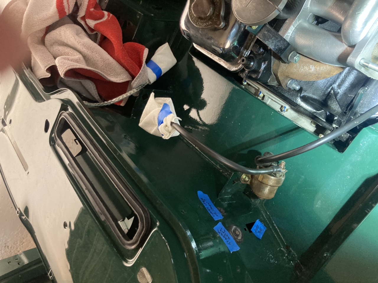

Finally, I installed the cowl vent. I trimmed the new seal, such that the top of the seal is flat - essentially changing the seal cross section from “H” to an upside down “U”. This allows the cowl to close pretty near to flat. I’ll give it a few months to compress and may trim a little more in the future. (It is difficult to cut the rubber neatly. I used an exacto knife with a fresh blade, however it might be better to trim it on while installed on the car instead of on the workbench.)

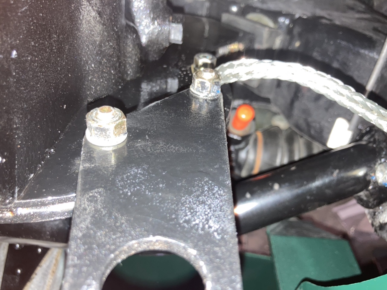

I installed the various “heavy duty” electric cables. The ones that run from the firewall to the negative battery post, from the positive post to the solenoid, from the solenoid to the starter, and the engine grounding strap at the front of the engine (from timing chain cover to a hole adjacent the front cross-tube. Note: attached photo shows this connected to cross tube. I corrected this, but did not take a picture). I scraped away paint (and cried a little) when making these connections, to ensure good electrical contact.
I also installed a ground strap from the steering rack filler port (brass plug) to one of the rack mounting bolt on the bottom of the frame.
I plan to add an additional strap from a gearbox mounting bolt to the firewall, where the battery currently is connected. (The car previously had the battery grounded to the transmission.). This seems like an easy way to get a second ground to the engine.
One of the photos also shows the untrimmed cowl seal. I removed the upper half of the seal.
Feedback and criticism appreciated!

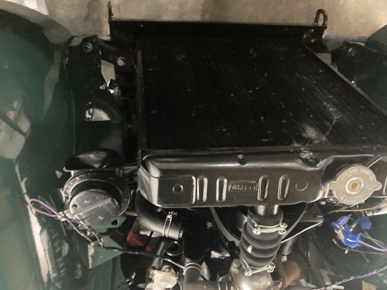

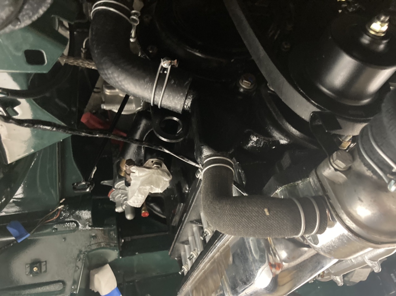

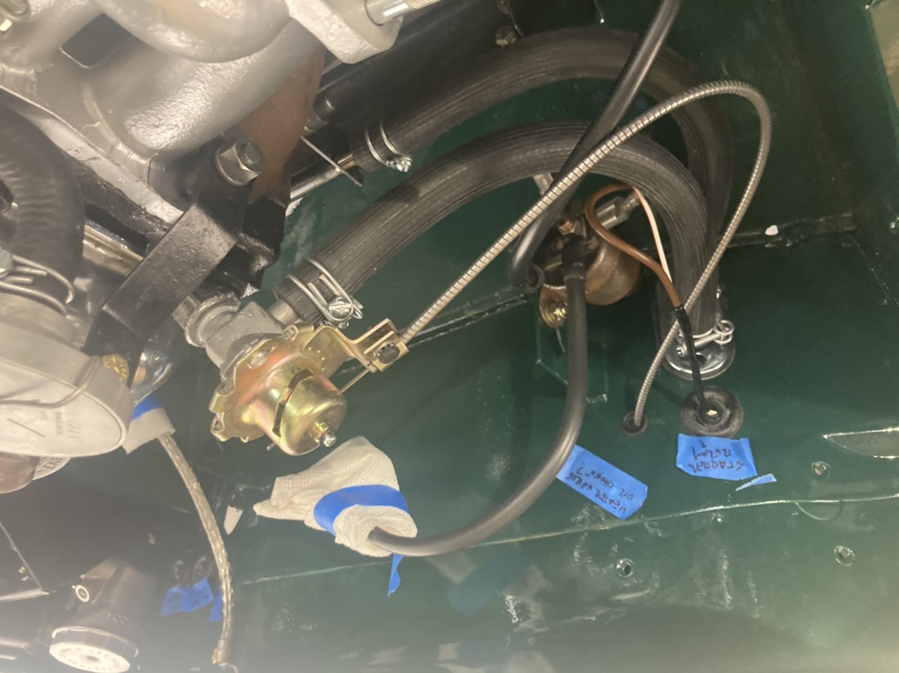

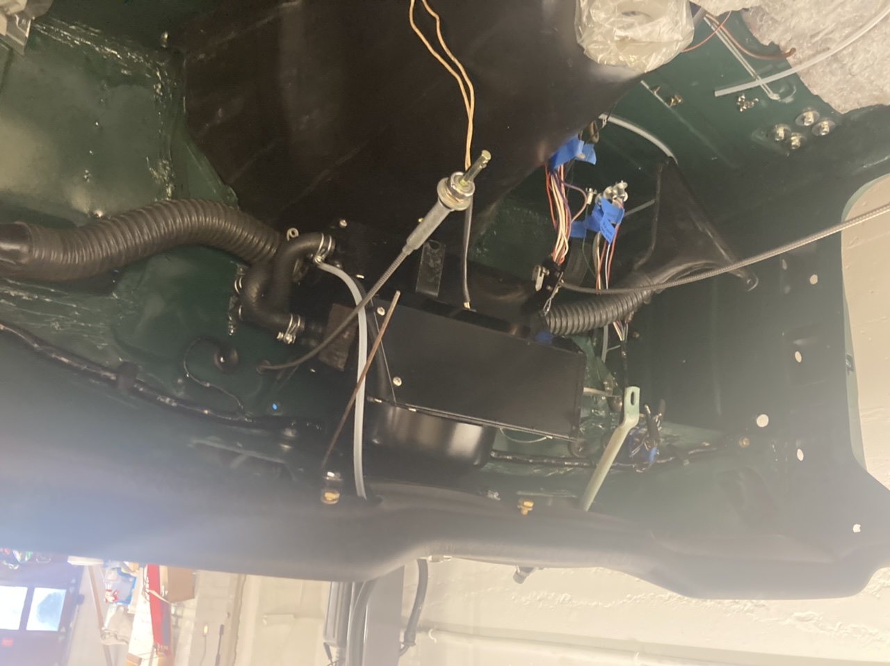

Heater installed, also coolant hoses and radiator. I used the original heater valve, even though several folks suggest a modern alternate from the local FLAPS.

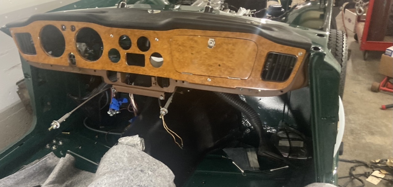

Dash pad installed, after test fitting the dashboard. I glued the ends of the pad, as well as the front edge, with Weldwood landau adhesive. Good stuff, if expensive! Granger carries it, so I was able to avoid hazmat shipping costs.

Clutch hydraulics (see separate post on actuator rod) complete, same for brake hydraulics. I have a Gunson Eezibleed arriving next week - I look forward to bleeding!

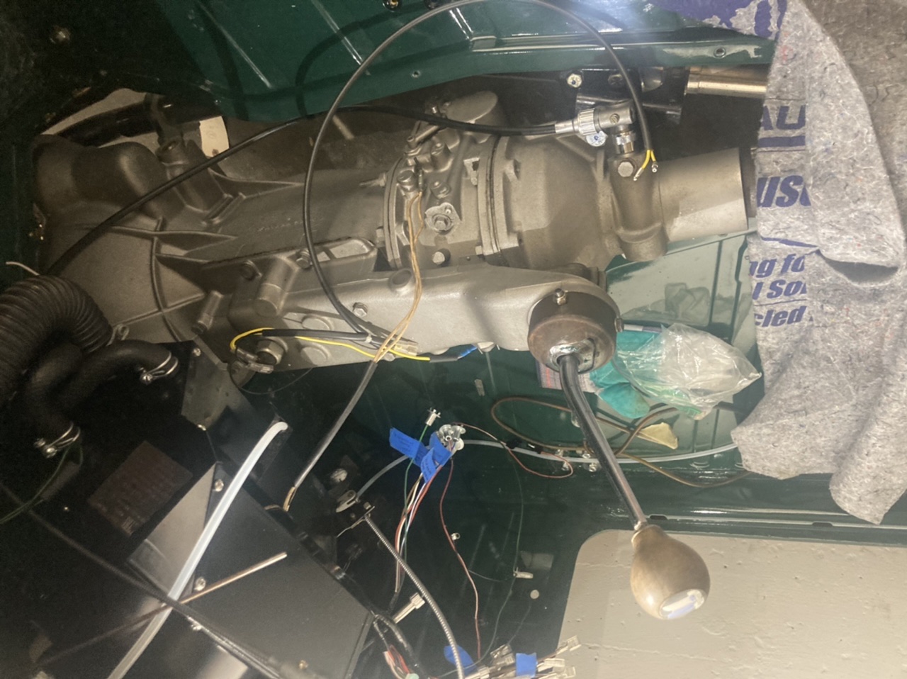

OD electrics installed. I only have OD on gear 3 and 4, so I simple tied off the second pair of connectors. I did not connect the reverse lamp switch - perhaps I should have, even if only to not deal with the transmission tunnel in the future…
And I wrestled the single piece tunnel into place. What a nightmare… I still spent a day and a half inventing creative ways to swear. OK, I exaggerate a little. But it wasn’t fun! In two places I ended up running bolts from below to get the cover on, and will cut off the excess with a dremel. In one or two other locations I used longer bolts to facilitate alignment. I made access holes for the fill plug and solenoid using extra round plugs that I happened to have - c. 3” diameter. I also cut a square access hole for the Speedo cable. The cover did not have clearance for the right angle drive. I tried using heat to reshape the cover, but it did not work very well. I will build (mold) a fiberglass cover.
In hindsight, mounting the cover is probably easiest when the body is separate from the chassis. Next time around!
