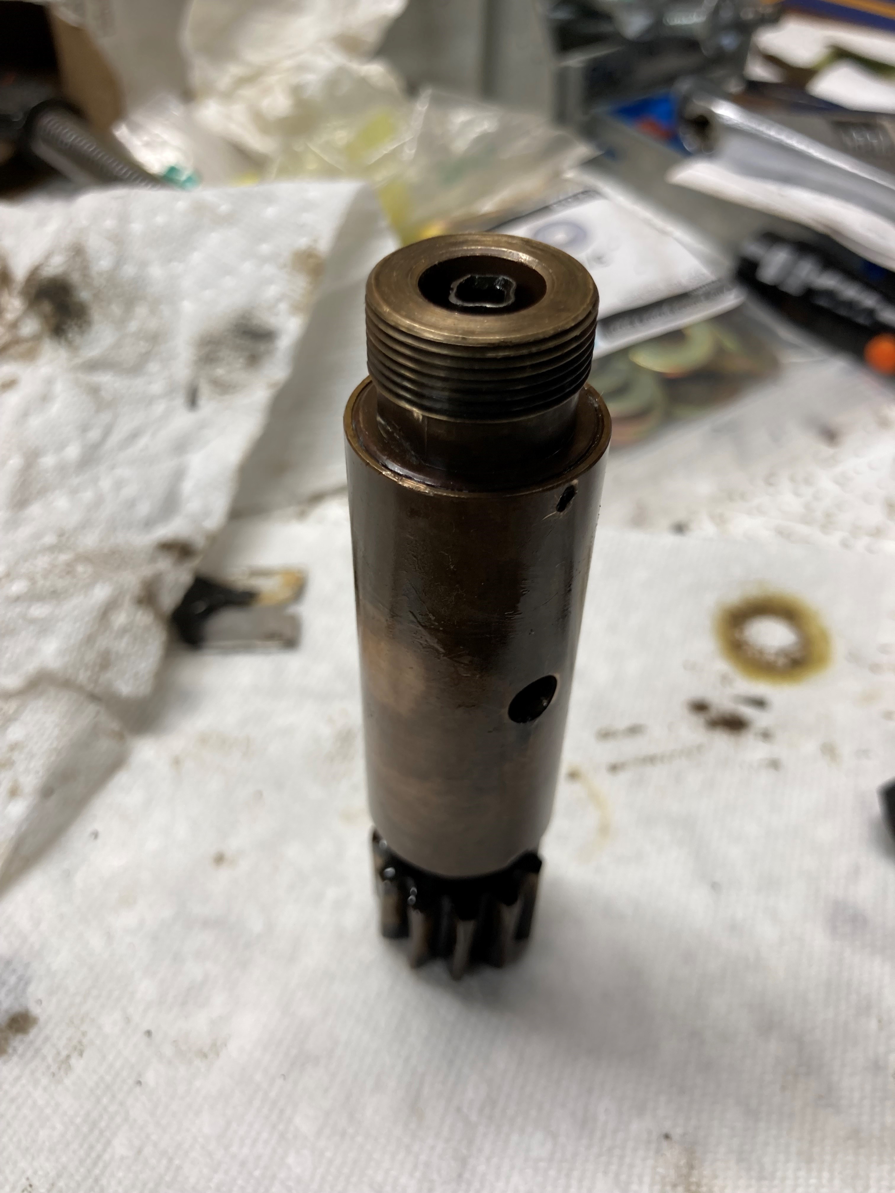

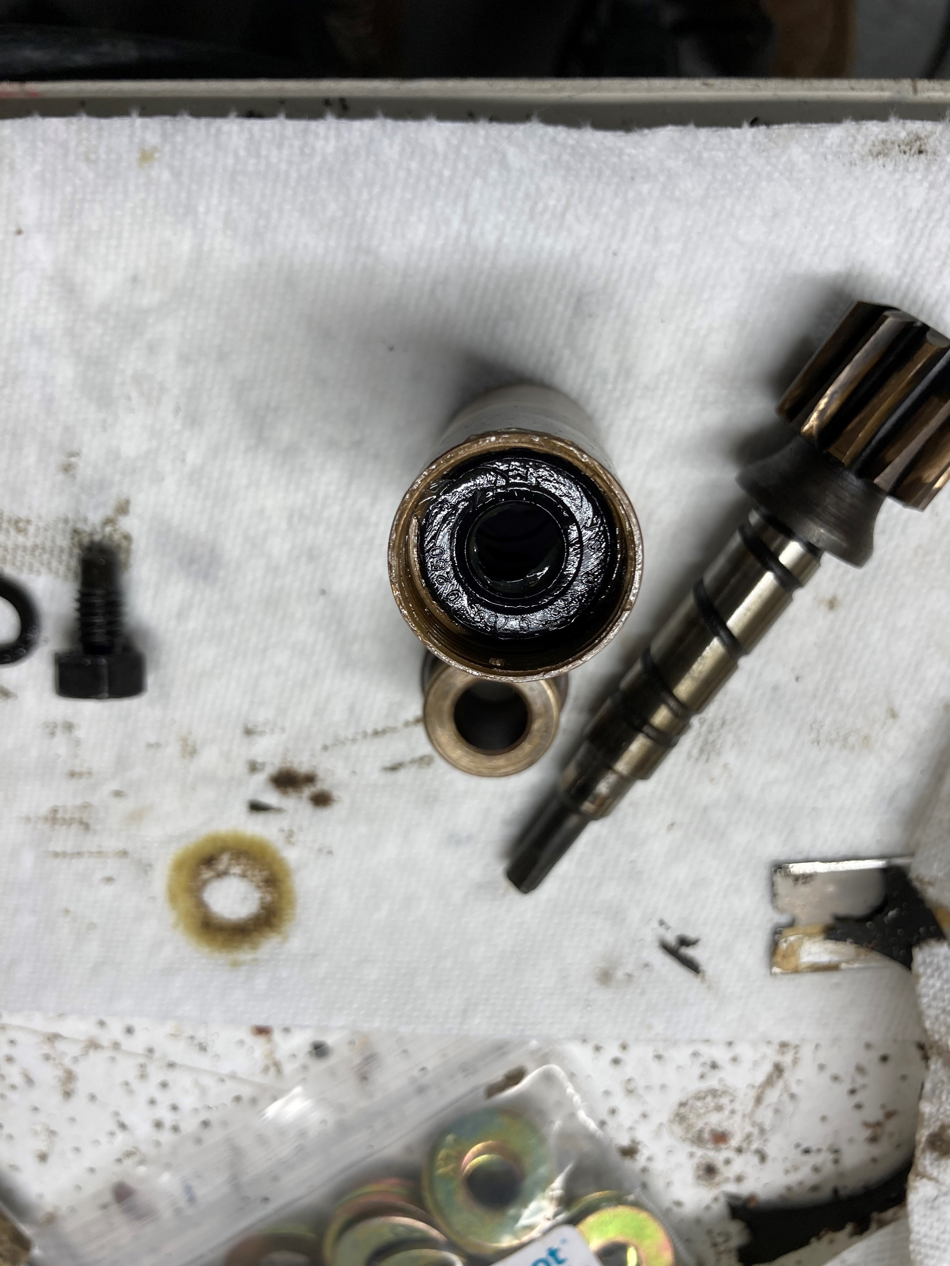

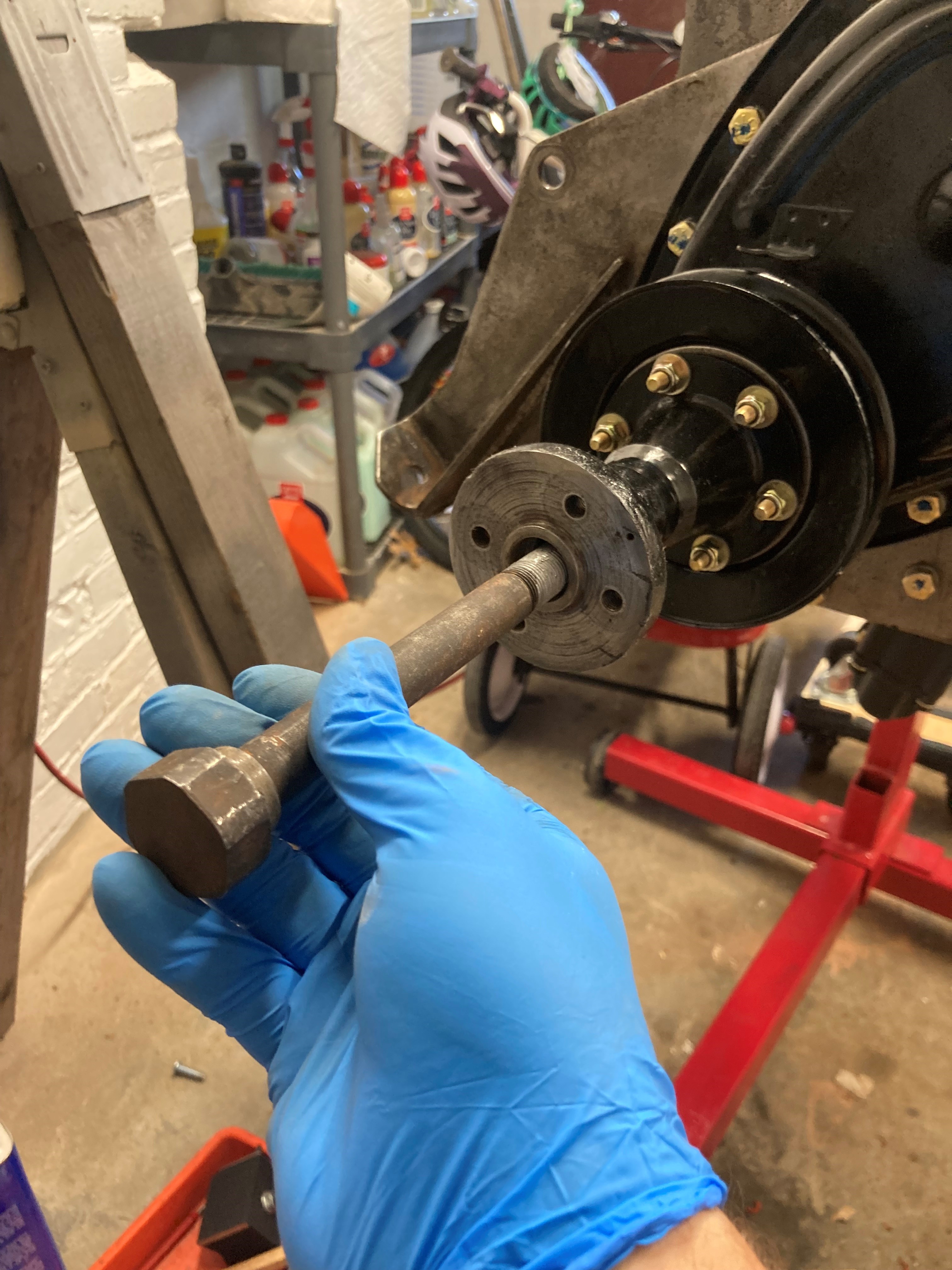

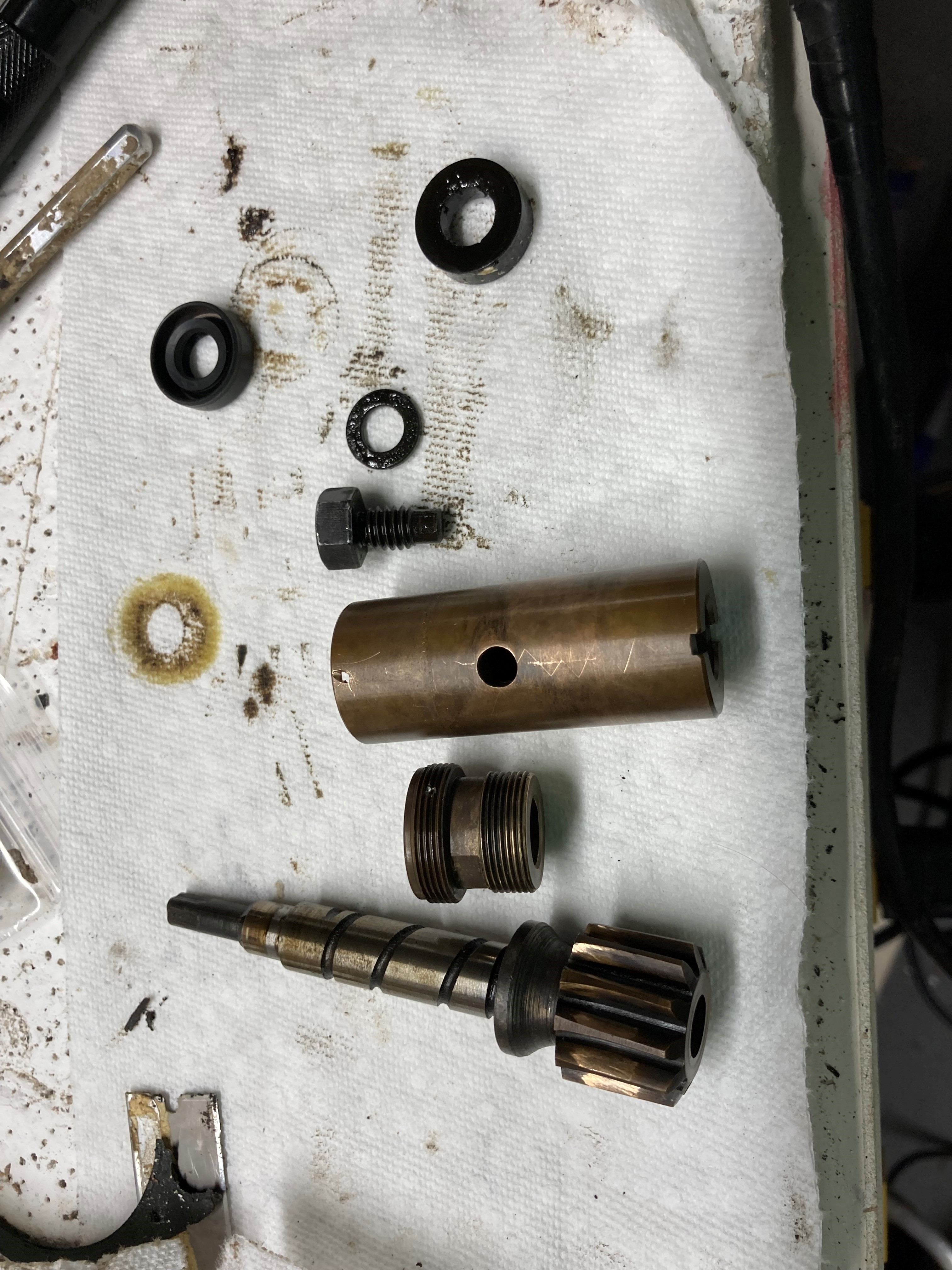

Small update: replaced the oil seal on the tachometer drive shaft. A bit finicky, but ultimately straightforward once I understood how the parts are assembled.
I removed the setscrew (don't lose it, it's special). The brass bearing assembly has flats that a narrow wrench fits on to, and applying gentle torque got the bits apart. The brass bits split into two, held together with a pin. I drilled out the pin - not too easy given the relatively soft brass, and the two parts unscrew from one another. I replaced the oil seal (well greased), and re-assembled with blue Loctite. I will drill for a pin (likely in a different location), but first need to peruse the smallest pin I can find at Ace.

Thanks for getting one of those brass deal apart. I have never taking one apart, but I do have one with something wrong with it. The gear slides back and forth or up and down in the pedestal depending on how I look at it. Perhaps the pin is broke. Where does the rubber seal go on the shaft? Oh the engine coming alone nice also

Hi Steve,

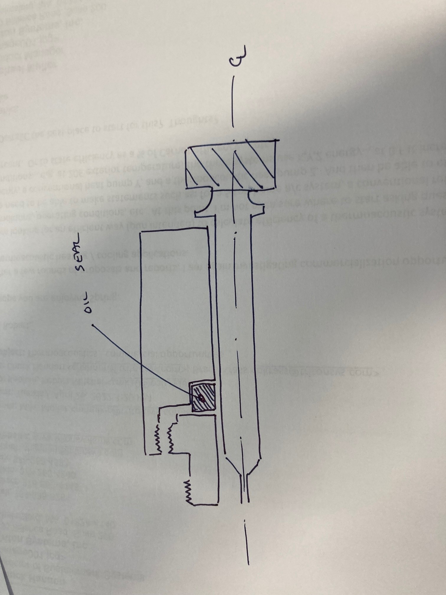

The pin connects the outside brass piece to the inside threaded piece. (In the upper picture of my post, the parts from the bottom are: the gear, the threaded inside piece, the outside piece. You can see where the pin hit the threads in the inside piece - the bright spot on the larger diameter threads.) If the pin broke, it would allows this piece to unscrew - I assume this would be reasonably obvious by looking at the parts.
The gear is not "locked" to the outside brass piece. It can be pulled out. The corresponding gear on the oil pump shaft keeps this one in place. (The setscrew on the outside of the distributor pedestal housing prevents rotation of the brass piece... it does not lock the gear.)
Below is a photo of the rubber seal installed. Metal side facing the oil side, and I used the threaded piece to push the seal home.
Hope this makes sense?

A missing seal would not allow any additional movement (the seal "grips" the shaft, so it adds friction). Basically, the rotating shaft is a sliding fit inside the brass bit... see attached chicken-scratch cross-section.

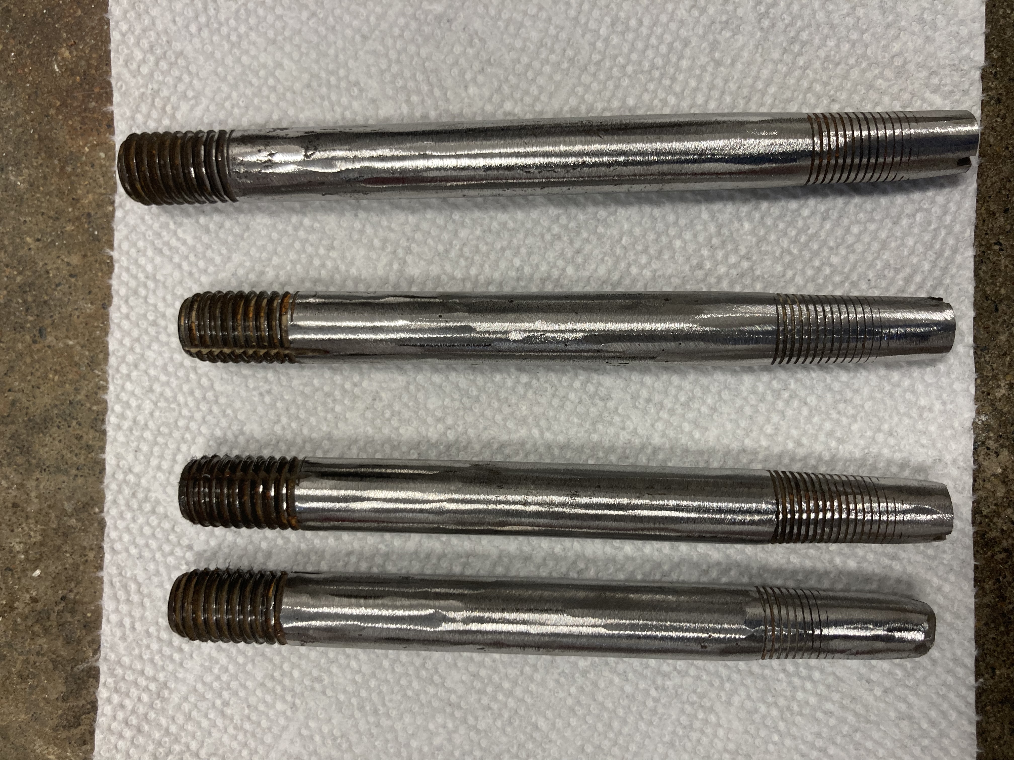

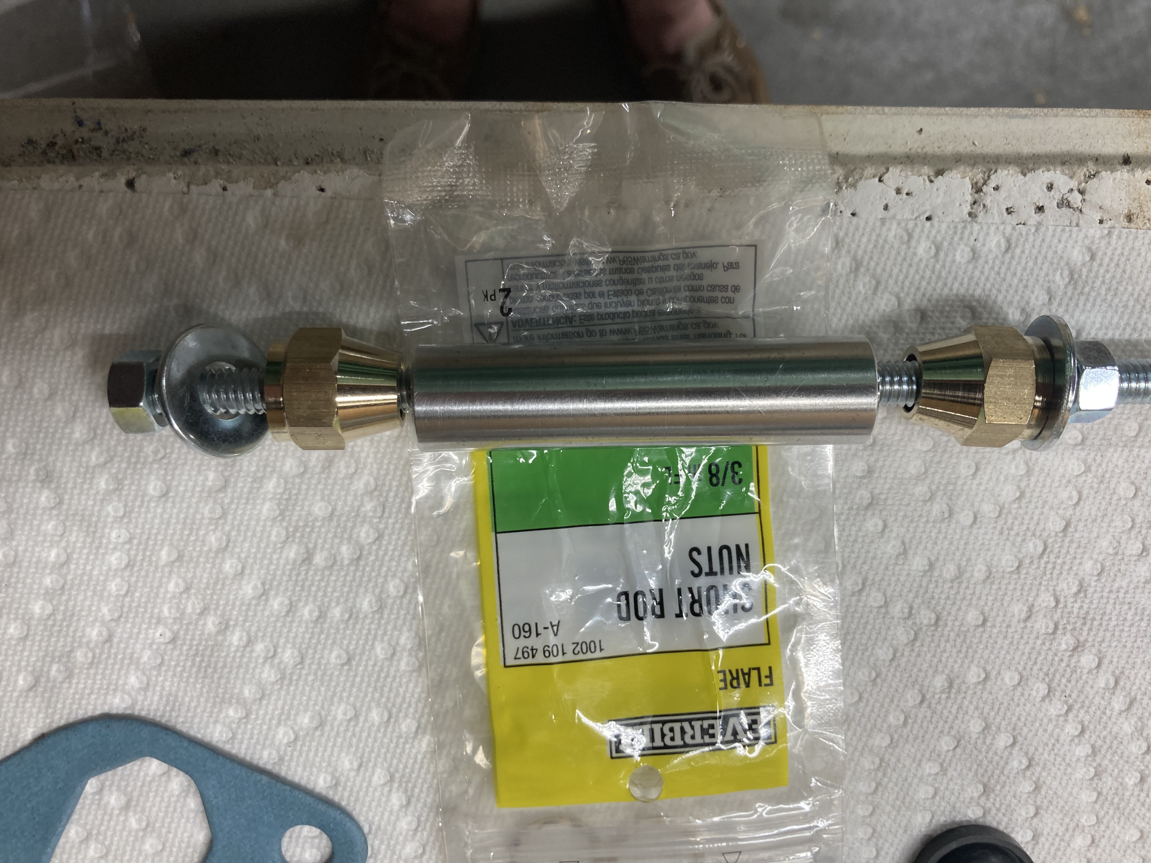

And, from another forum, I copied a ā€œMacGyveredā€ (is that spelled correctly??) pushrod tube swaging tool using 3/8ā€ flare fittings from HD and threaded rod. Tubes installed with loctite blue. Worked very well… hopefully no leaks when all is complete!

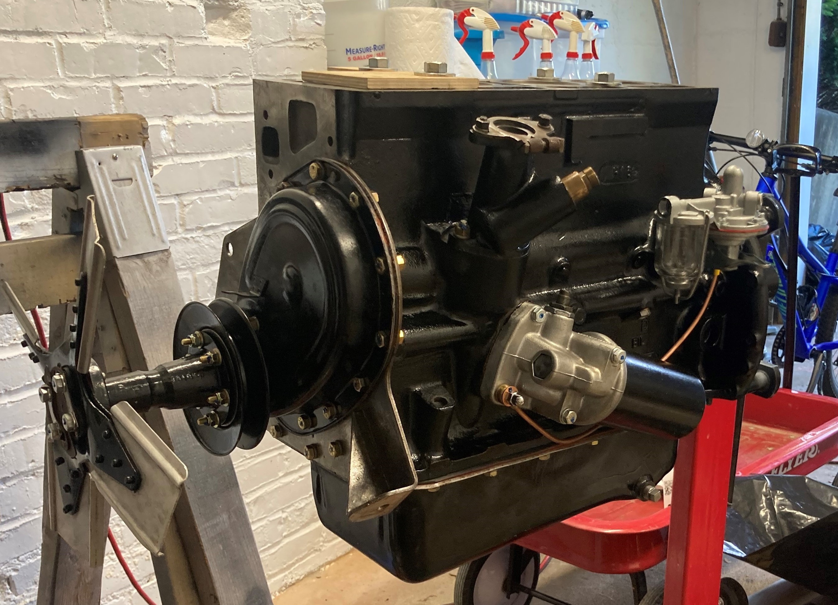

Update:
1. I cleaned up and installed the oil filter attachment. I replaced the pressure setscrew ball and spring. (Original ball looked great. The spring had minor wear on the side, presumably from engine vibration). The oil pressure setscrew is sealed with loctite blue instead of lead - for now. The lead seal prevents adjustment, so I hope to get the pressure set correctly before using lead. Hopefully the loctite blue holds enough to allow this...
(Being a sucker for originality, I am staying with the cartridge filter and forgoing a spin-on adapter. Hot oil running down my arm be darned!)
2. I installed the "made in Italy" fuel pump from TRF. It looks really nice; the casting quality is excellent. Obviously time will tell if the reliability is good.

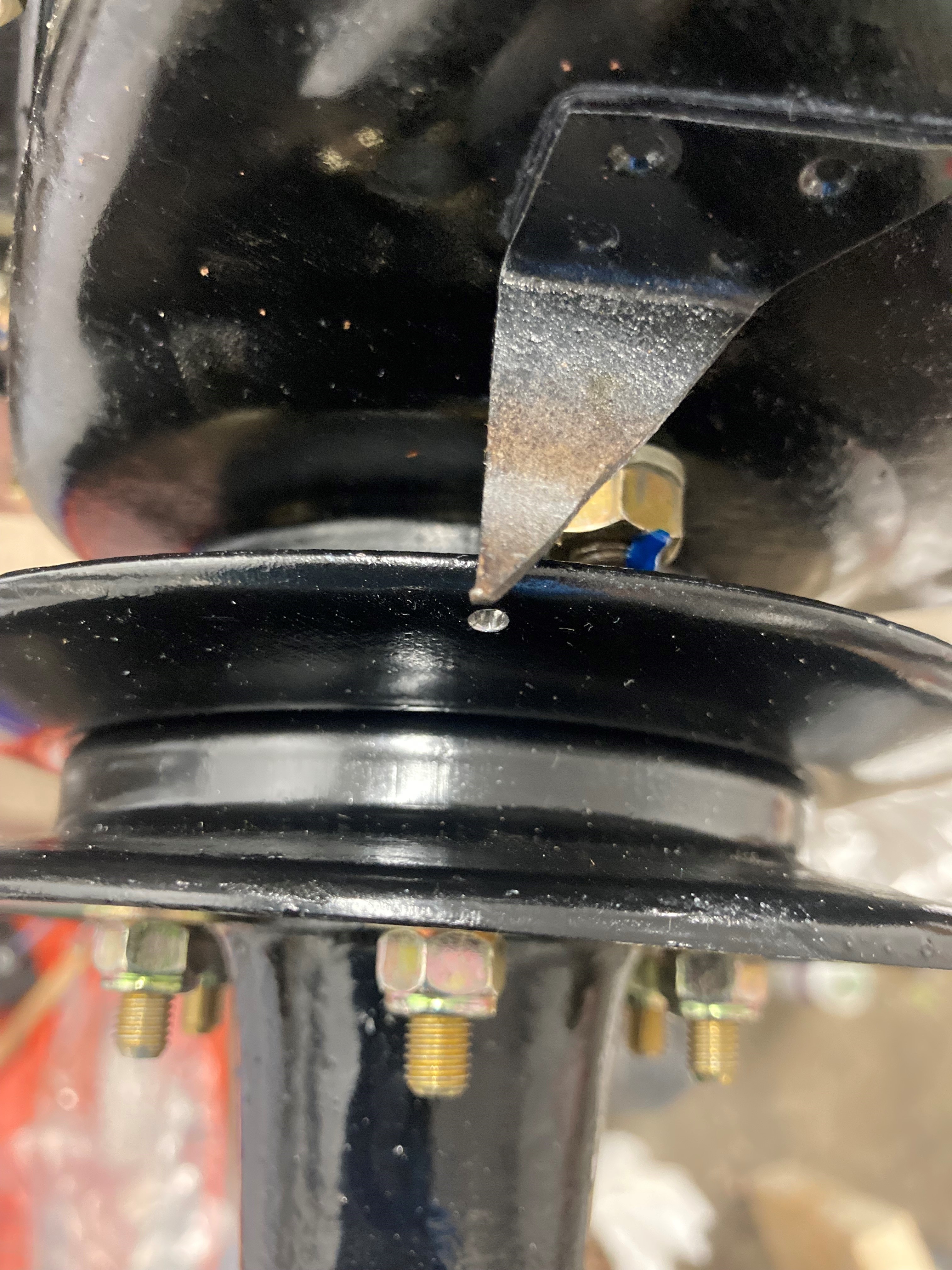

3. Installed the front pulley and fan, including fan bolt. (Again, forgoing a high-efficiency fan... see above "sucker for originality" comment!) I put anti-seize on the bolt, figuring it is (1) high torque, and (2) in a hot and non-oiled location. I torqued to 140 ft-lb, on the high side of recommendations; I figure the higher torque helps compensate for the lubricity of the anti-seize. (I was able torque the bolt because I removed the oil pan and blocked the crankshaft in place.)
4. When installing the oil filter housing, I had to slightly correct an opening in the gasket with an exacto knife. I did this with the gasket on the engine and of course the piece I cut out fell into the engine. Silly me! (I found the piece.) Lesson learned; I will re-attach the oil pan (with new gasket) AFTER everything else is buttoned up (temporarily installed to help keep things clean).
Anything to check "one last time" before I install the head? What are the odds I will remove the head prior to starting the engine? (Should I use the "good" ($70) Payen gasket, or just a "simple" ($20) copper gasket for the initial install - replacing with the good gasket later??)

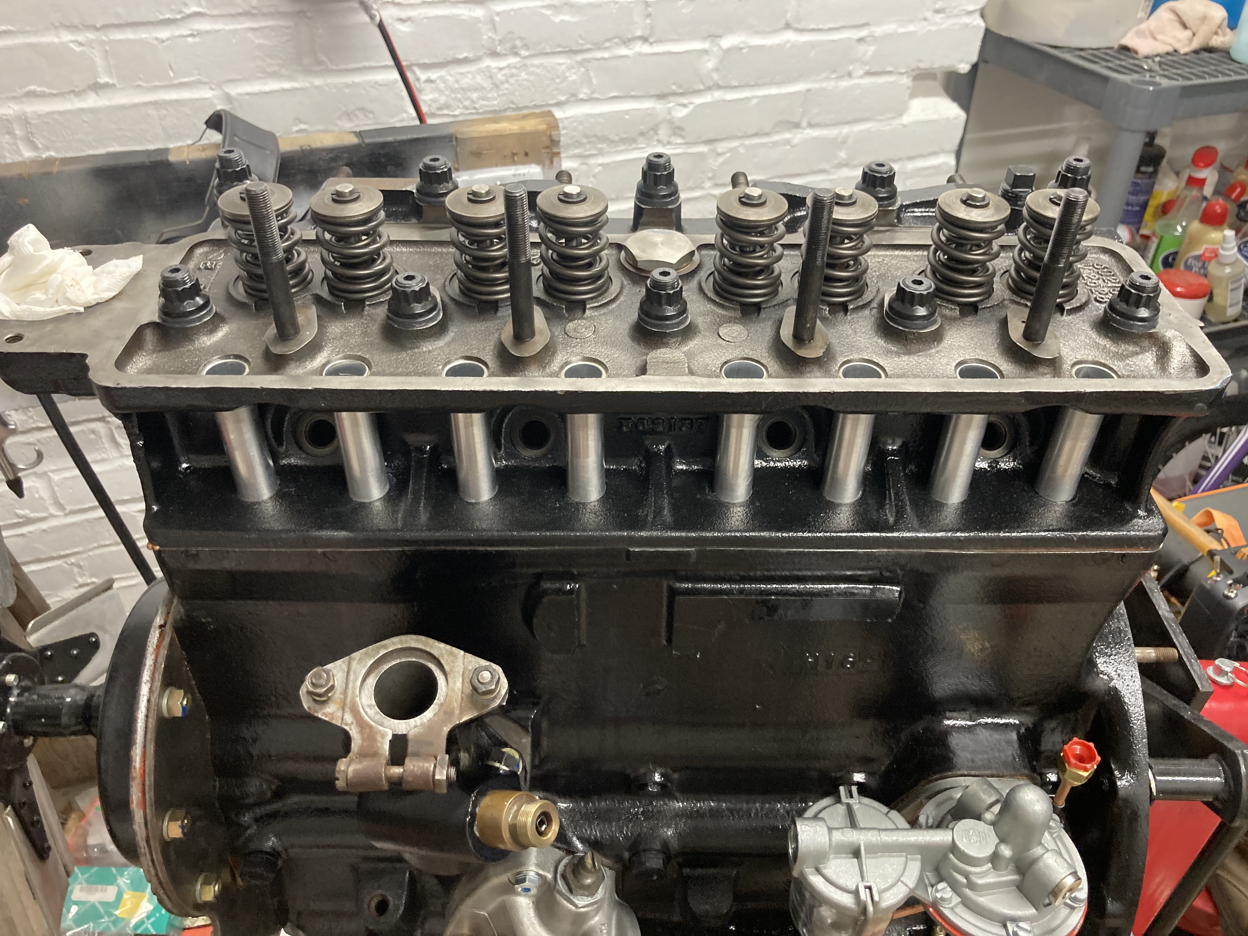

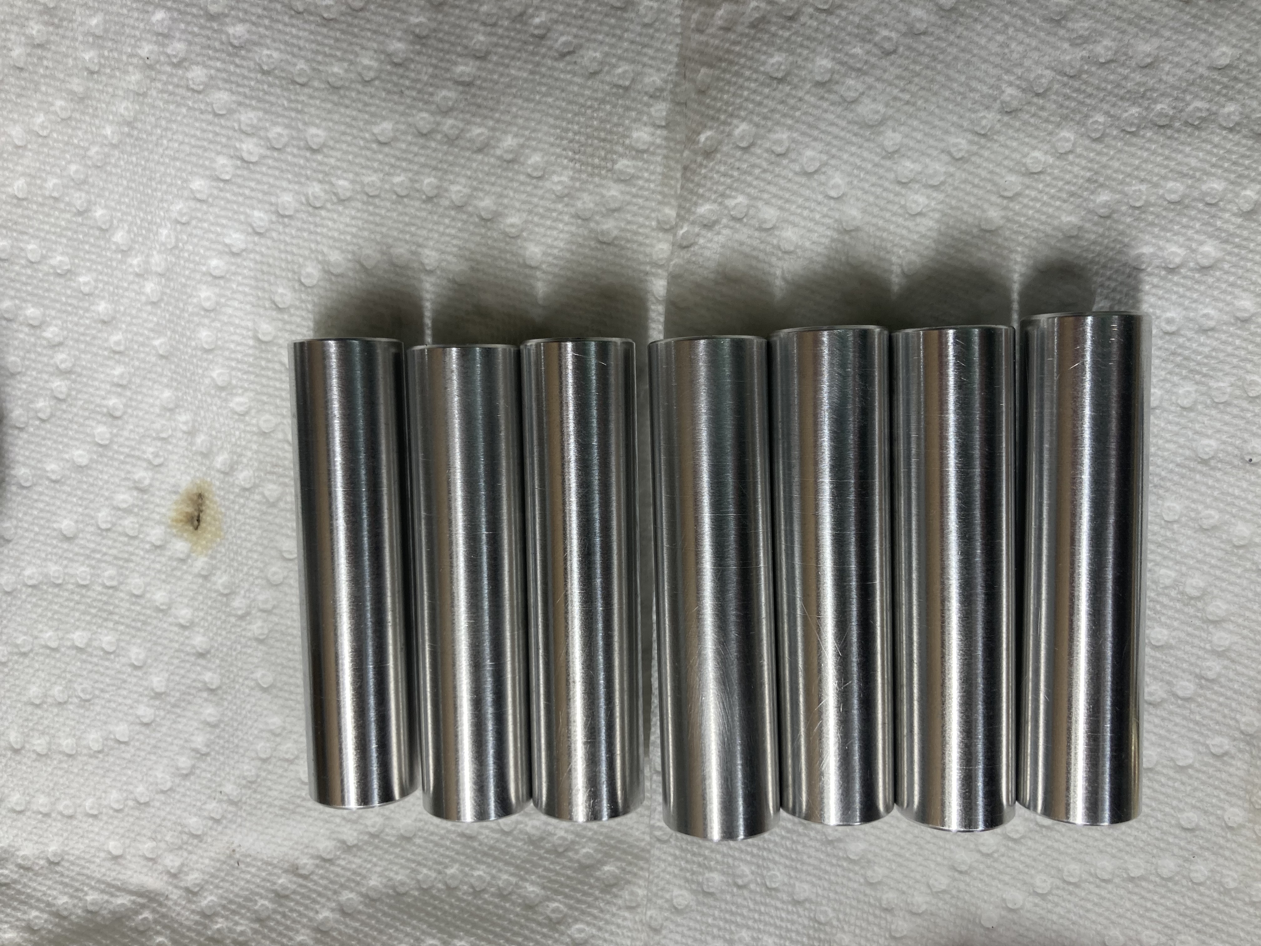

It has been a while since I posted - and have not made too much progress. I installed the head, using the Payen gasket and copper spray. I made some ā€œDr. Entropyā€ alignment studs from the old studs - extremely helpful! (See here: > Came across these "tools" <)
I've also painted miscellaneous exposed bits of metal.

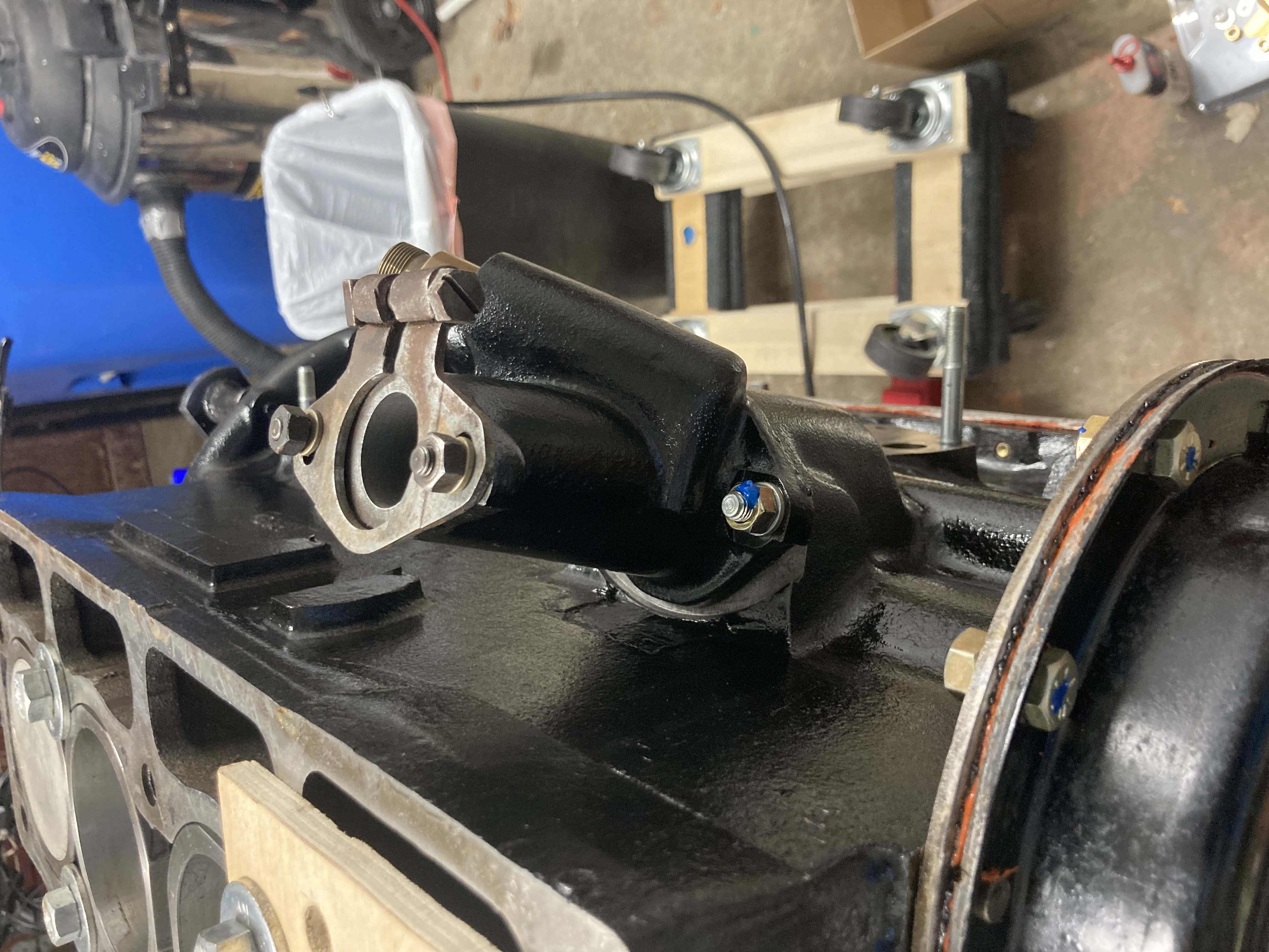

Next step is to take the engine off the stand. I built a rolling cart out of 2x4s that fits around the oil pan.
From here I will mate the flywheel (ensuring it is flat) and clutch. I had the clutch and flywheel balanced by my local machine shop. Next is a bench test of the transmission OD (need to build a test stand...), and then marry the two in holy (lowercase "h" :smile:) matrimony and hopefully many miles!

b) those new pushrod tubes--did you use that flaring tool for the fit? And only because the old tubes were ruined somehow, or missing?
