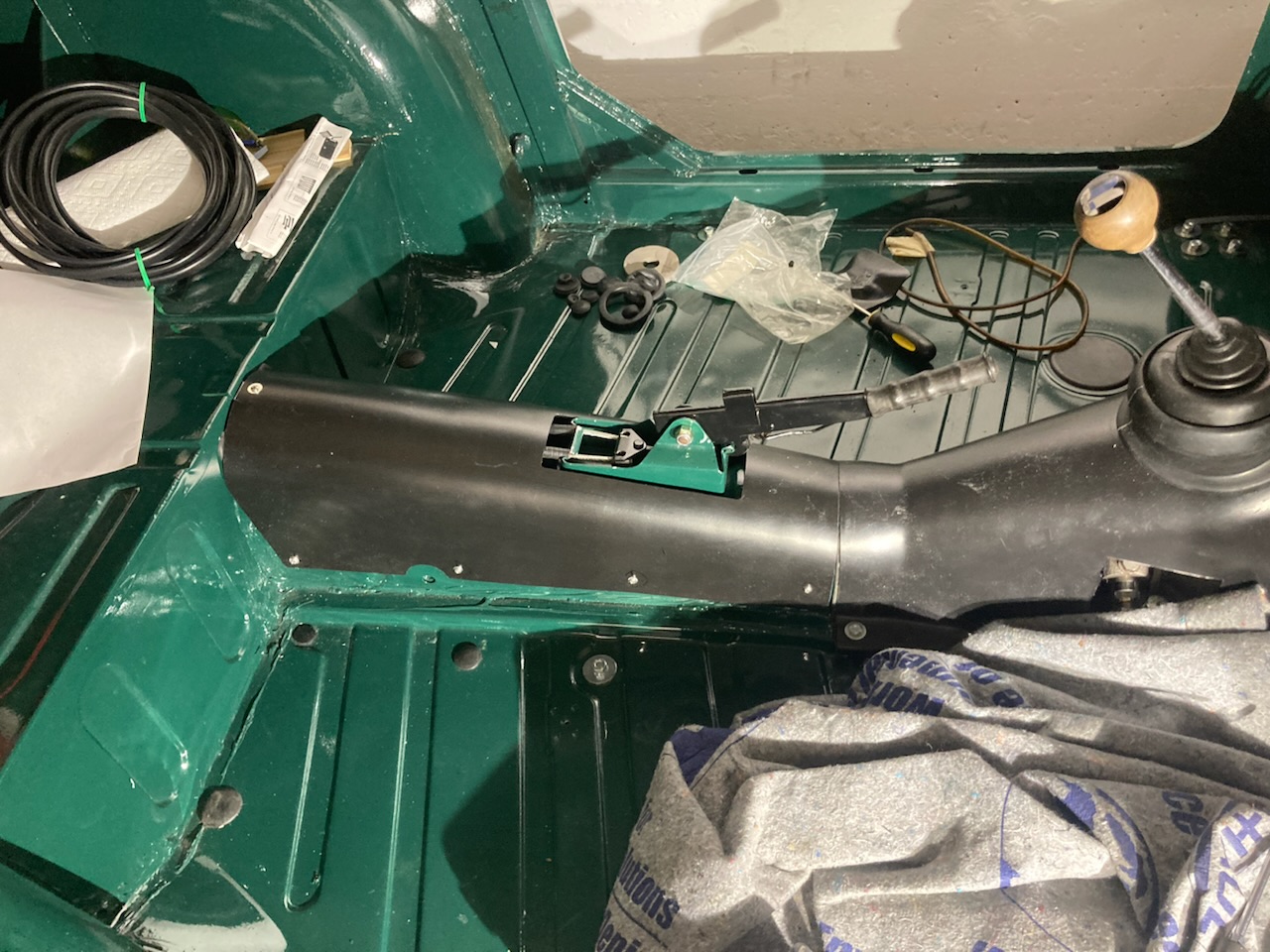

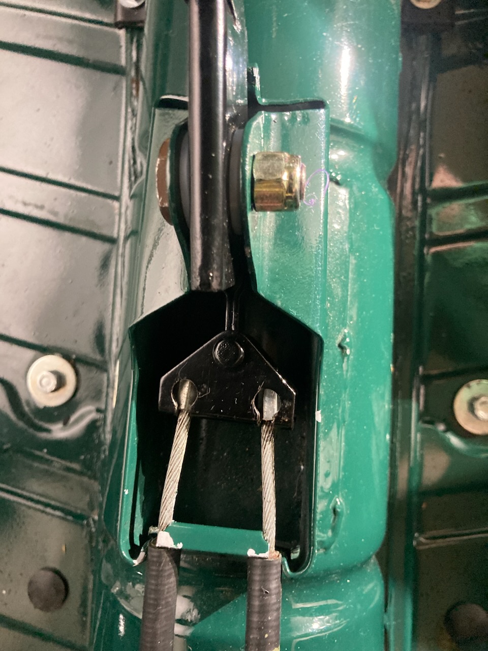

After the transmission tunnel, I installed the handbrake cables. Because I installed them on the brakes first, this resulted in some loss of paint on the handbrake area. I should have attached cables to the handle before the drums.
Installing the handbrake cover was a bit fiddly, in that I wanted to reuse the original holes in the sheet metal. Using calipers, I carefully measured the hole locations and transferred to the poly cover. Lucky me, of the eight holes I only had to “slot” two of them in the cover. The cover does require a bit of trimming in the back - easily achieved with sandpaper on a block. (I’ll have to trim some more after installing the rear bench carpet.)

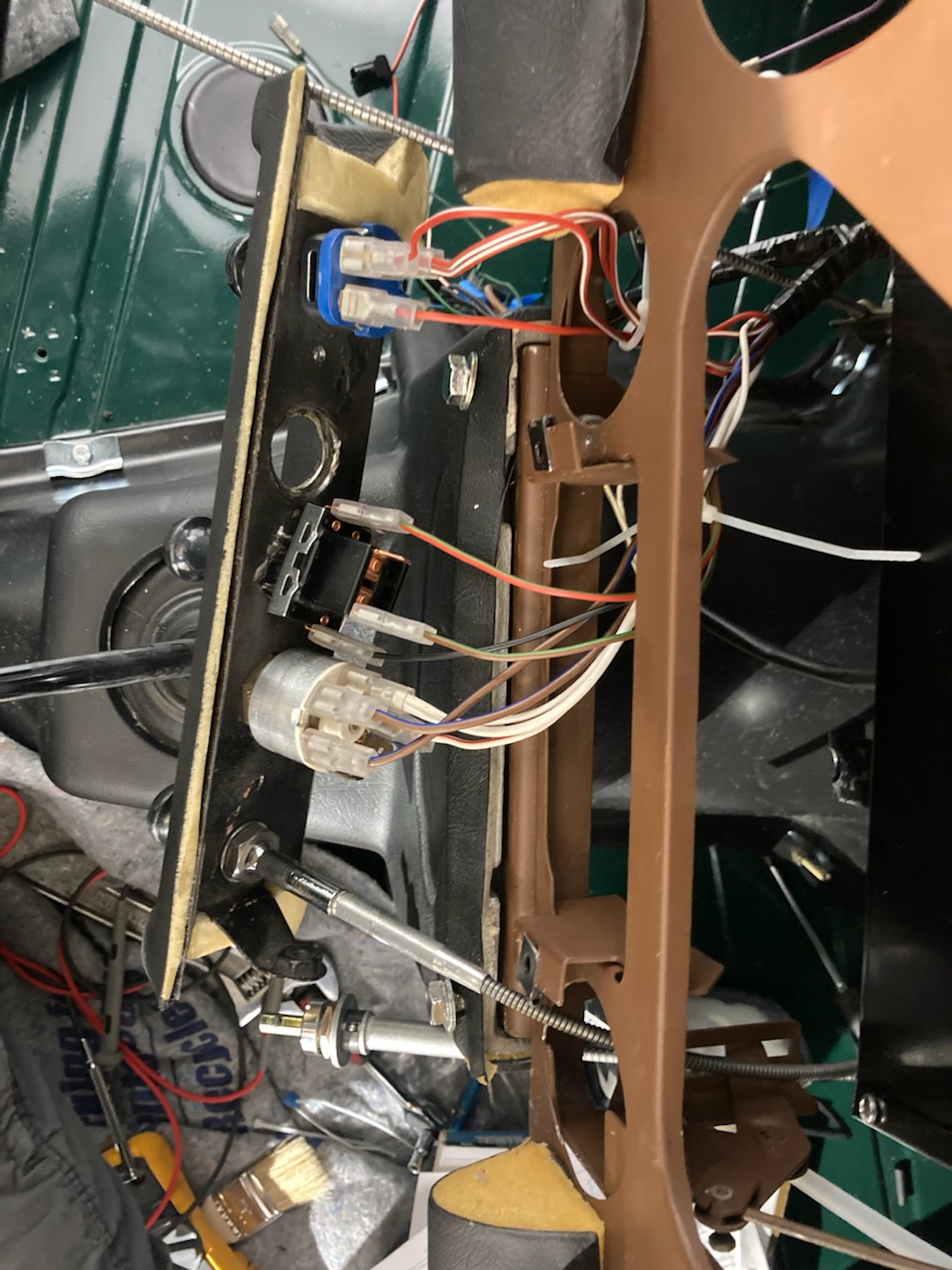

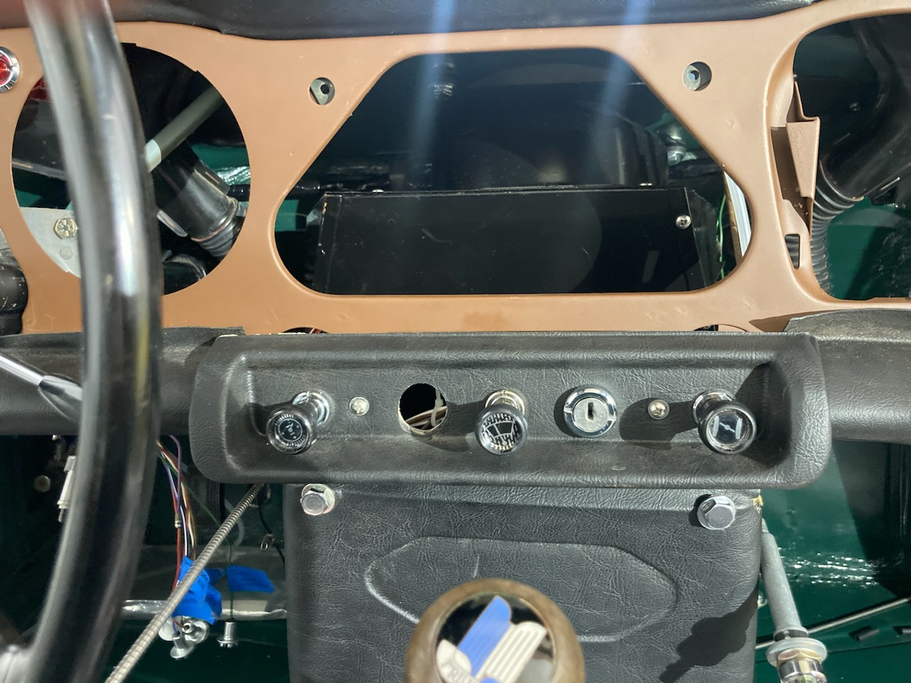

Plinthing:
To replace the plinth, I used a combination of old and new. The new plinth from TRF has an aluminum plate inside. The original has a steel plate. I ripped the foam off the old and glued the new foam aluminum to the cleaned up steel backing plate.
I wish I took more photographs, but the steel has more reinforcement at the edges, as well as an additional bolted connection to the dashboard near the scuttle vent cover. (Visible in bottom of lower photo.)
Unfortunately, the two metal plates meant the switches do not fit - the assembly is too thick. Using a Dremel I enlarged the holes in the steel plate and installed switches. See photo for reference.
A few more updates; unfortunately this thread is well behind my work. It’s a pain to type on an iPhone!
After the plinth, I installed the instruments. It gets quite busy behind the dash with all the wiring. I largely followed the Advanced Auto Wire diagram. I think the wiring for the lights is incorrect on the diagram, but some measurements with a multimeter sorted things out. I’ll have to find my sketch and post it (currently at home).
The light bulbs in the new harness are wedge base, which is different to original. The “bulb kit” from TRF uses the original bulbs; a quick trip to my local FLAPS sorted this.
More importantly, the bulb holders on the new harness for the red/green warning and indicator lights do not fit. I removed the original light sockets from the original harness, cleaned them, and soldered them in.
Once this was sorted, I have a beautiful dashboard. Only issue: I tested my Speedo cable with a drill, and now my car looks like it is going 100 mph while standing still 🤪. The speedo will come out shortly for inspection and possible repairs.

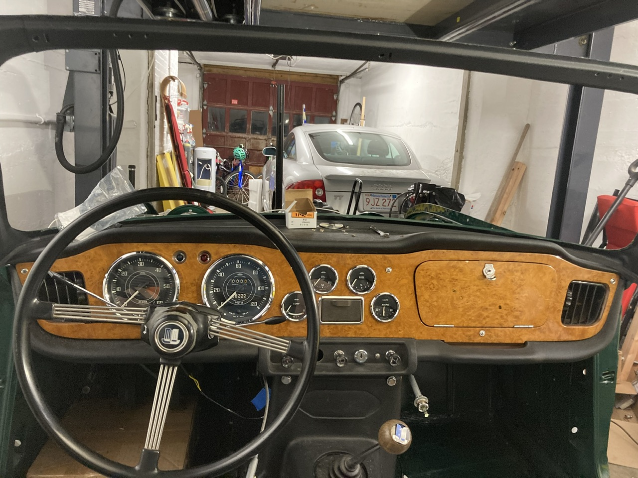

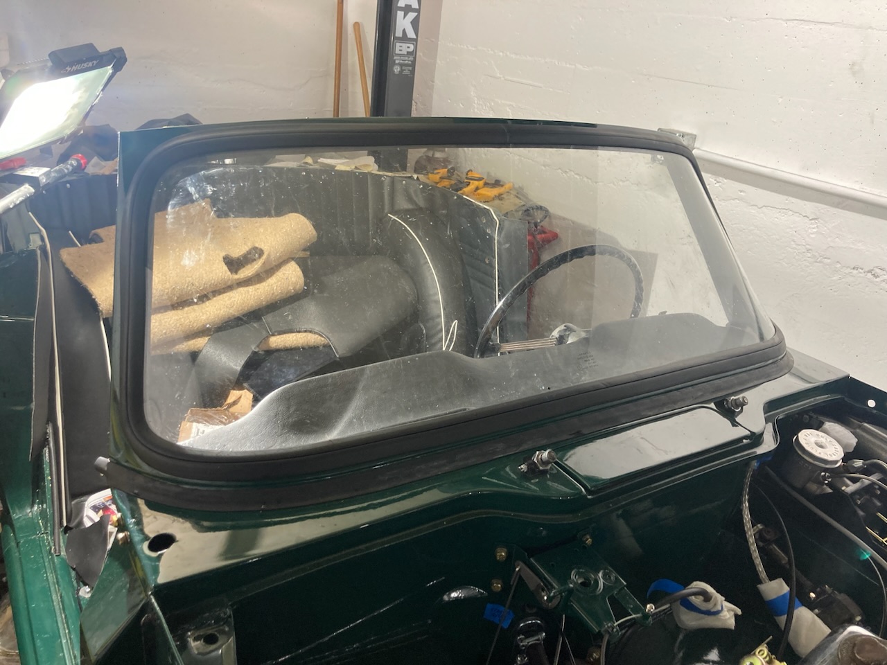

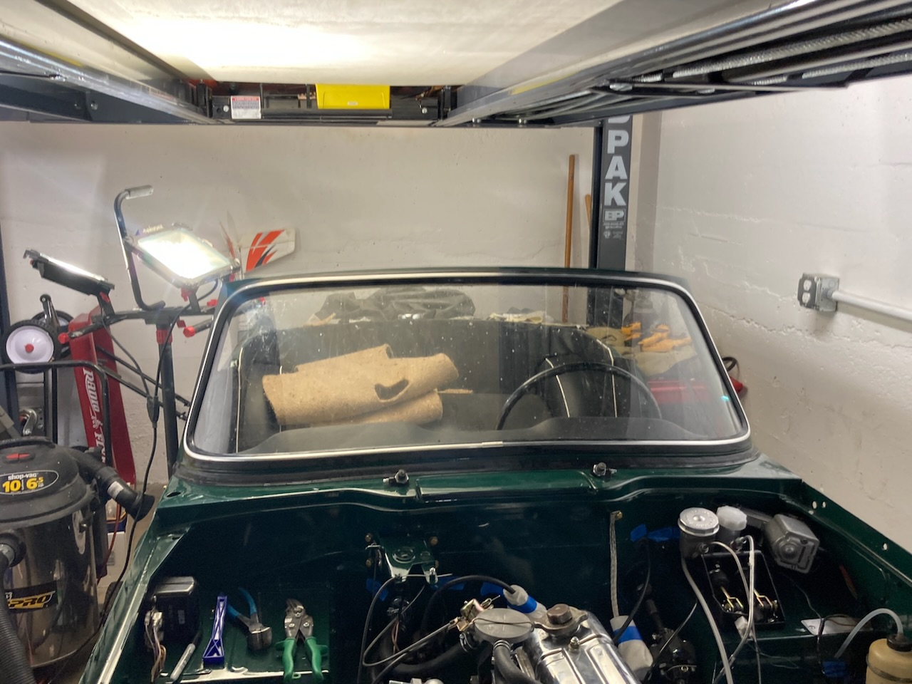

Next up was the windshield installation.
I was very apprehensive about this, but in the end it was much easier than the poly gearbox install. Maybe I got lucky??
Installing the seal on the windshield was trickier than I anticipated. The seal seemed too small - but once I finally got it on it seemed almost loose. I think because it was curled up for a long time it just took some time to straighten. I used Griot’s Speed Shine as my lubricant; others have used k-y jelly. It took a bit of thinking to figure out which slot in the seal is for what - three things go in the seal: the windshield, the frame, and the chrome sealing / locking strip. The largest slot in the rubber seal is for the windshield, and the chrome strip slot points to the outside.
Once the seal was on, again it took a bit of thinking how the frame fits in the windshield seal. The slot in the seal for the frame is almost shaped like a “Y”: one flap on the outside of the body, and a second on the inside. And I can’t quite explain it, however when pushing the “rope” into the seal, it is important to put it in the frame opening closest to the interior.
For a rope, many folks suggest using paracord. However, upon seeing Rusty Beauties video using a wire, I got to thinking maybe a wire is the best. I used 14-gauge home wire (with smooth plastic insulation), pulled from a coil on Romex I had. It is strong, slippery, and holds its shape. Again, using speed shine, I pushed it into the slot, making sure it was in the side towards the interior.
Deep breath. Go check phone for email. Make dinner for family. Find any excuse. Finally I got the courage to “just do it”. Two tries later, my windshield was installed. Intact. Holy moly!
Installing is a combination of brute force (pulling the wire), pushing hard enough not to break the glass (keeping the windshield in place), and breathing (while pushing). Having a plastic trim tool is essential to pull the seal where the rope trick did not fully pull out the seal. There were a few small sections (1/2” or less), the biggest one bottom center where I started. (Easy does it, slowly working out the missing sections with the tool.) I did it alone, but having a helper push on the one side (left-right) while working on the other other would have helped.
The chrome we strip went in easily; a tiny bit of persuasion, but surprisingly well. I suspect if this does not go in easily - as happened to some folks on the internet - it is because the windshield seal is not fully seated. I cut the ends to fit with a small gap - knowing that in the future I will have to repair this as the strip shrinks. I’ll likely go with the “two joint” solution, and have kept the remnant of the strip in anticipation.
All in all, about two hours. Much easier than that dang transmission cover!!

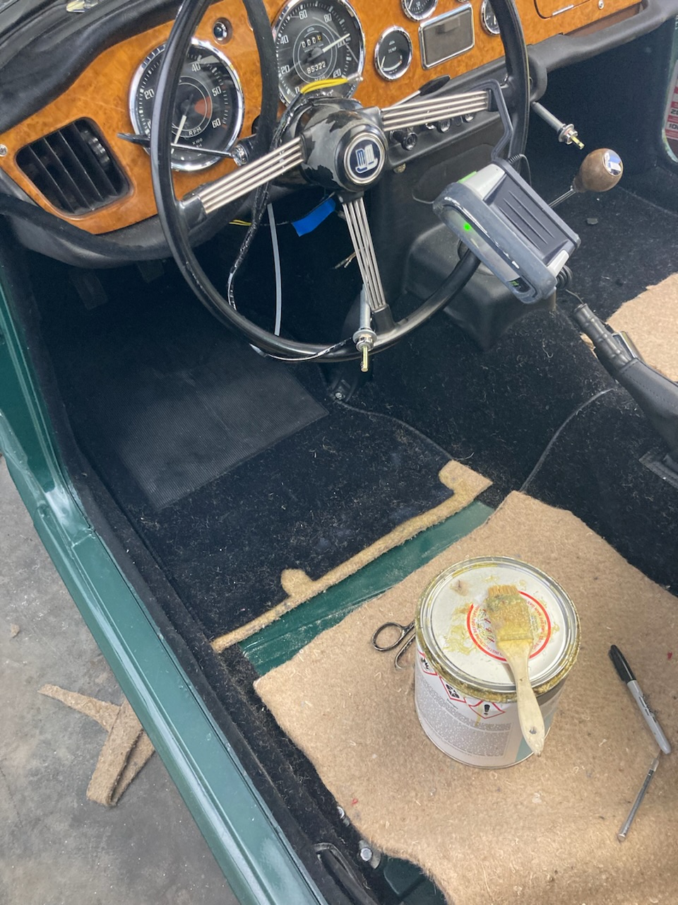

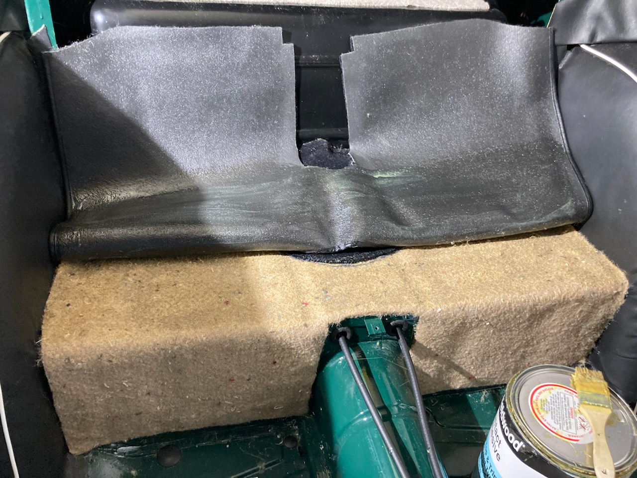

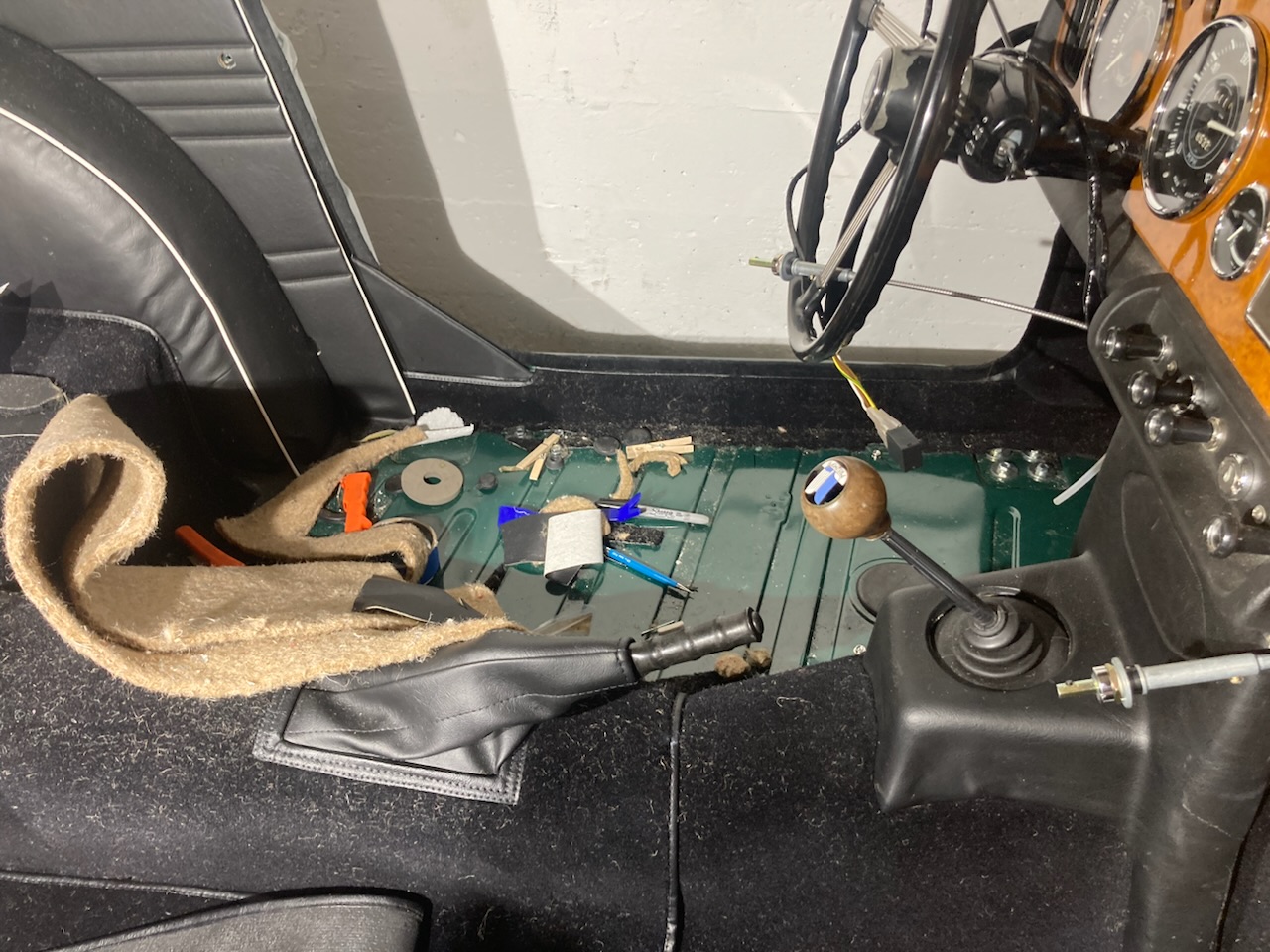

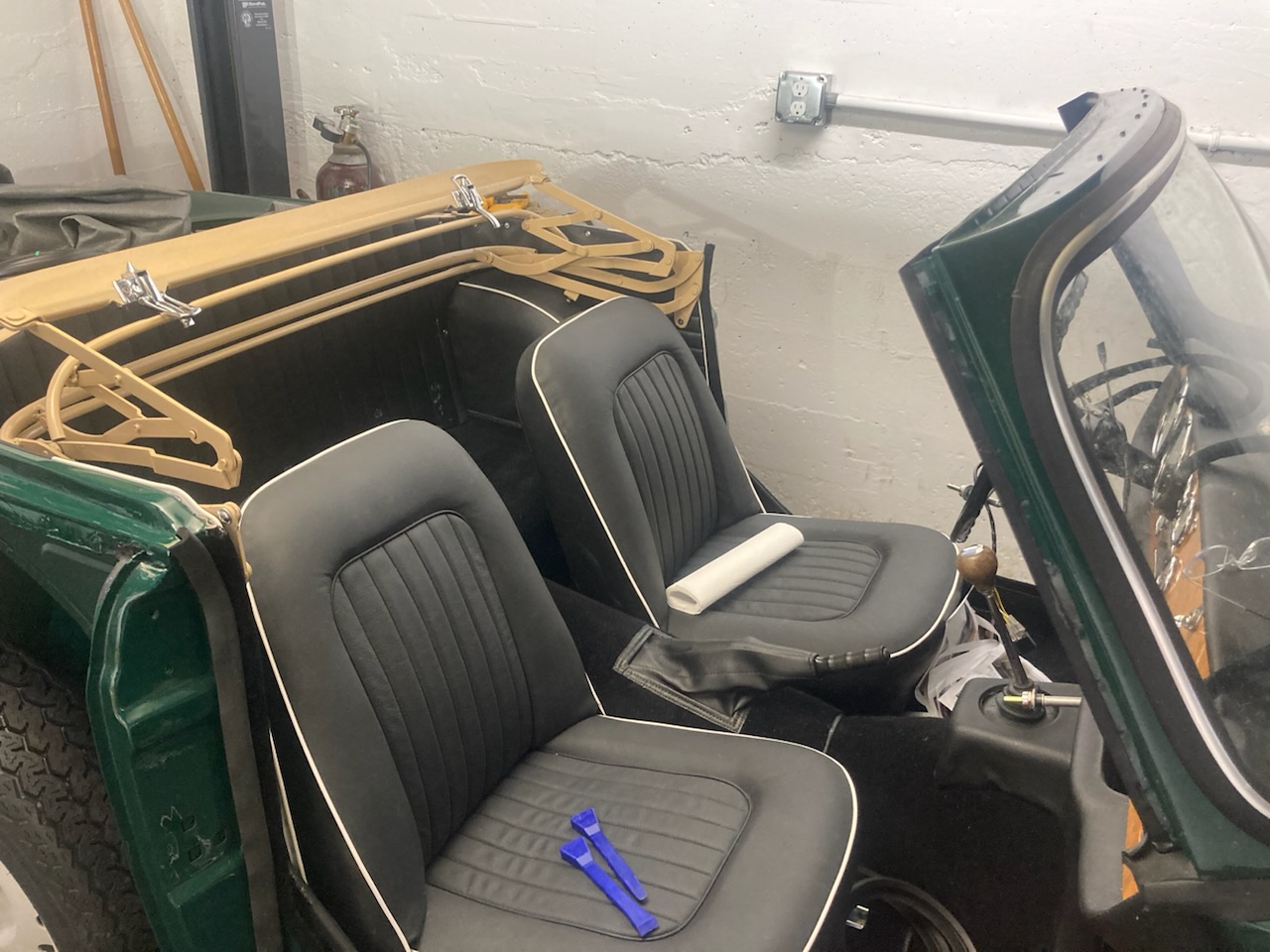

Interior install. I used a carpet kit from The Magic Carpet Factory / TRF, plus jute underpayment. (Better products than jute exist, but I’m a sucker for originality!) Overall I am impressed with the quality. I mostly followed the Moss instructions. I used DAP landau contact cement for everything, I bought it from Grainger: https://www.grainger.com/product/29...gucid=EMT:10339122:Item:CSM-323&emcid=NA:Item
The rear wheel arches are a pain. But I think they came out ok (not perfect). I kept the original holes in the sheet metal for most the screws, using a U-shaped piece of wire to locate holes behind the panels (rear seat back, panels next to wheel arches, and footwell panels). In a few locations I moved the screw to a better location.
One caveat: the Dow adhesive reacts with the paint. Not a problem anywhere, except after I glued the jute to the floor carpets, I laid them into the car. I have some small paint wrinkles under the carpet. No one will know - but it annoys me 🤓. (Paint and primer are not breached, there is no rust concern.)
And jute is messy! A lot of vacuuming was required!

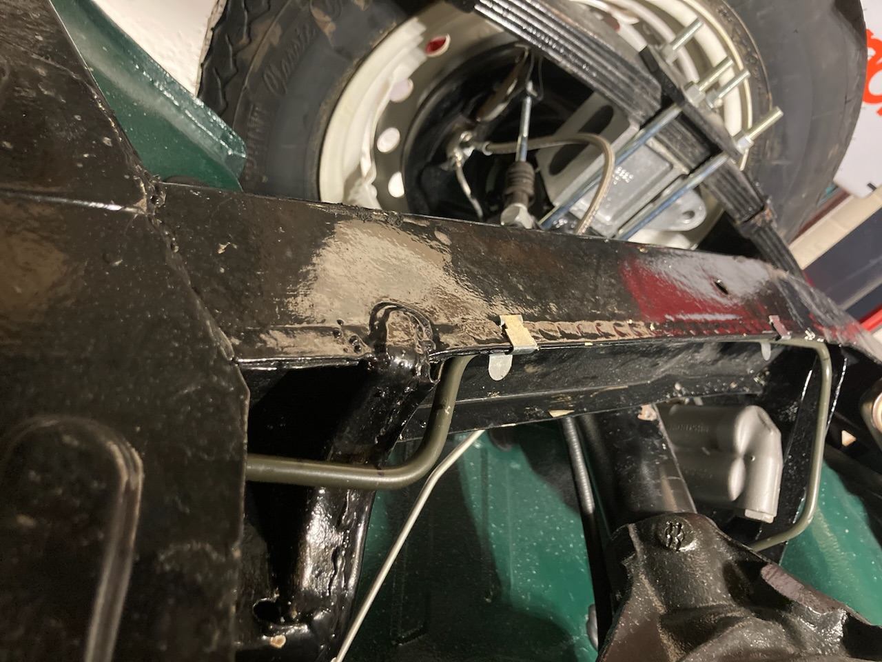

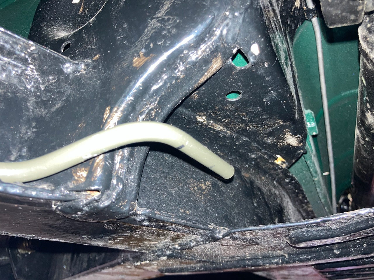

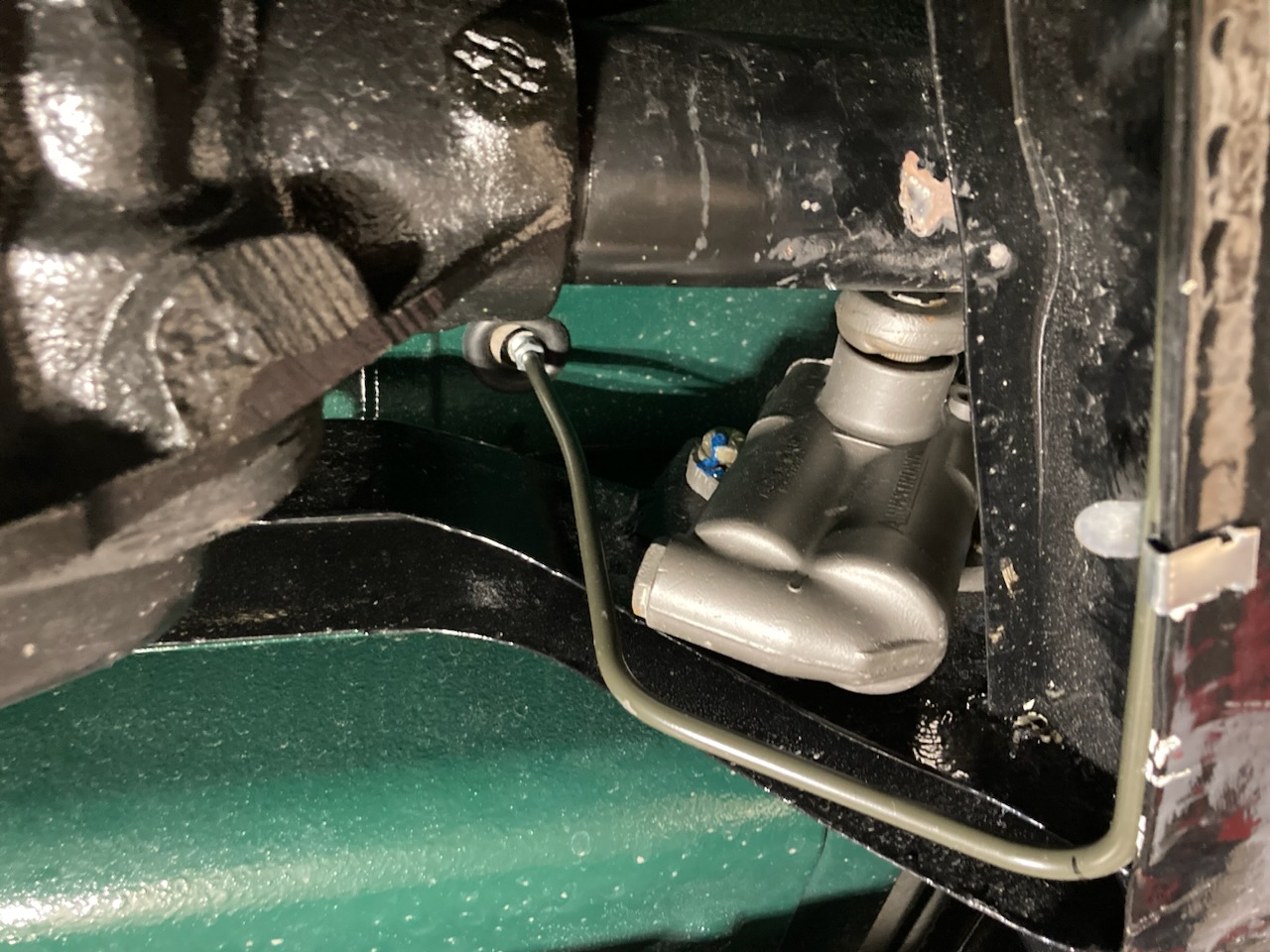

Installing fuel line was a bit off a pain - and should have been completed prior to me putting the body on the frame, but at the time I was not sure where the fuel tank outlet is positioned. Hindsight: run a line from the back of the t-shirt pressing to just behind the four-way brake fitting. Fit the final in from tank and out to pump after putting the body on.
I bought a tank fitting off eBay, claiming to be the correct bspp fitting. It fit, so no complaints, but I can’t vouch that you can’t get the same fitting at the hardware store.
I purchased lengths of brake line from NAPA, plus a basic tubing bender from Lowes. The NAPA guy told me I could bend the tubing around a beer bottle - he’s probably correct, but I think the $15 for the tubing bender was well spent.
I ran the tubing from pump to carburetors as original, although some say to run it behind the engine to avoid vapor lock.
Apologies for some of the “imperfect” camera angles - it’s hard to photograph under a car!

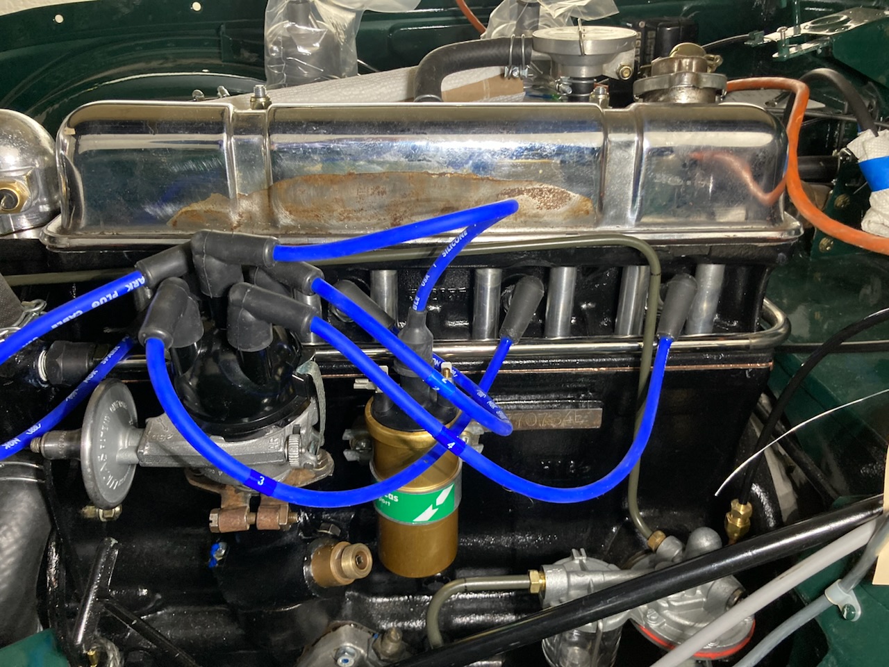

Distributor installation was easy - once I read the instructions three times. Engine timing (timing chain) is done with number one at top of exhaust/intake stroke (when valves are opening and closing. Installing the distributor gear is when number one is at the top of the compression stroke!
Whoops. Fortunately the distributor shaft and drive gear are pokey-yoke such that it only goes together one way.
Once the engine was in the correct position, I reinstalled the distributor gear, and the distributor dropped right on.
Setting the static timing resulted in the distributor not being parallel to the engine. The attached picture is before setting the timing; once set, the distributor is rotated counter-clockwise maybe 10 degrees. Not much, but enough to catch my eye - and I am a believer in “if it does not look right, there is a good chance it isn’t right.”
However, jumping ahead, my engine runs beautifully. So I’ll leave it until I start to tweak.
Wires are NGK, plugs Champion 312 / L87YC. Distributor rebuilt by Advance Distributor. Lucas “Sport” coil - honestly not my intention, but I accidentally put it in a TRF shopping cart a while back. It is the correct resistance, so I’ll use it for now. (Astute eyes will see I used screws to attach it. I have since replaced those with the proper bolts; at the time I did not have 1/4-20 bolts. Bolts are much easier!)

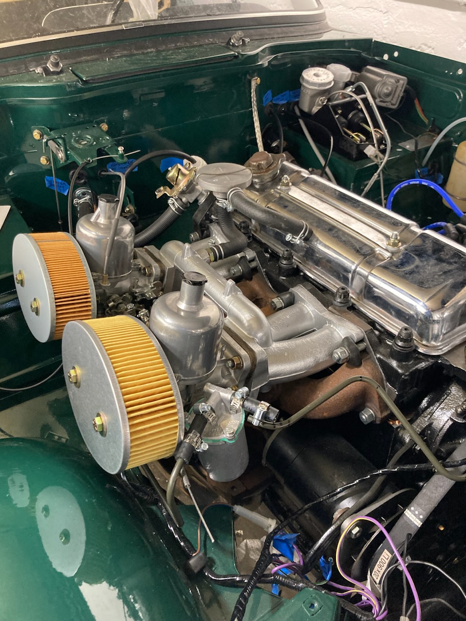

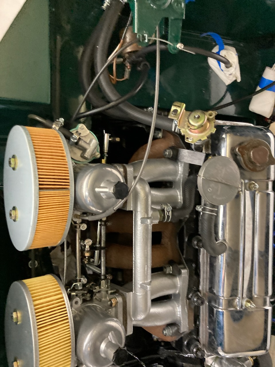

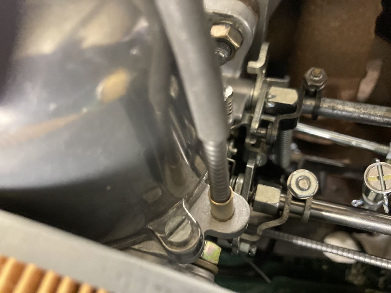

Carburetors. Rebuilt by Joe Curto, and look beautiful. Assembling the throttle linkage is a bit fiddly, and I relied heavily on the parts manual and internet photos to assemble. Note: many photos are incorrect; don’t believe everything you read on the internet! The parts manual is correct - except for how part 145073 is installed. But with some headscratching and realizing there is only one way, I figured it out. I’ll have to get a better picture to share.
Somehow I lost the rod that connects the two choke actuators, part 511747. It is NLA, but I bought 5/16 rod from McMaster and cut to length. The two fittings, 511749 and 511750 are still available (TRF).

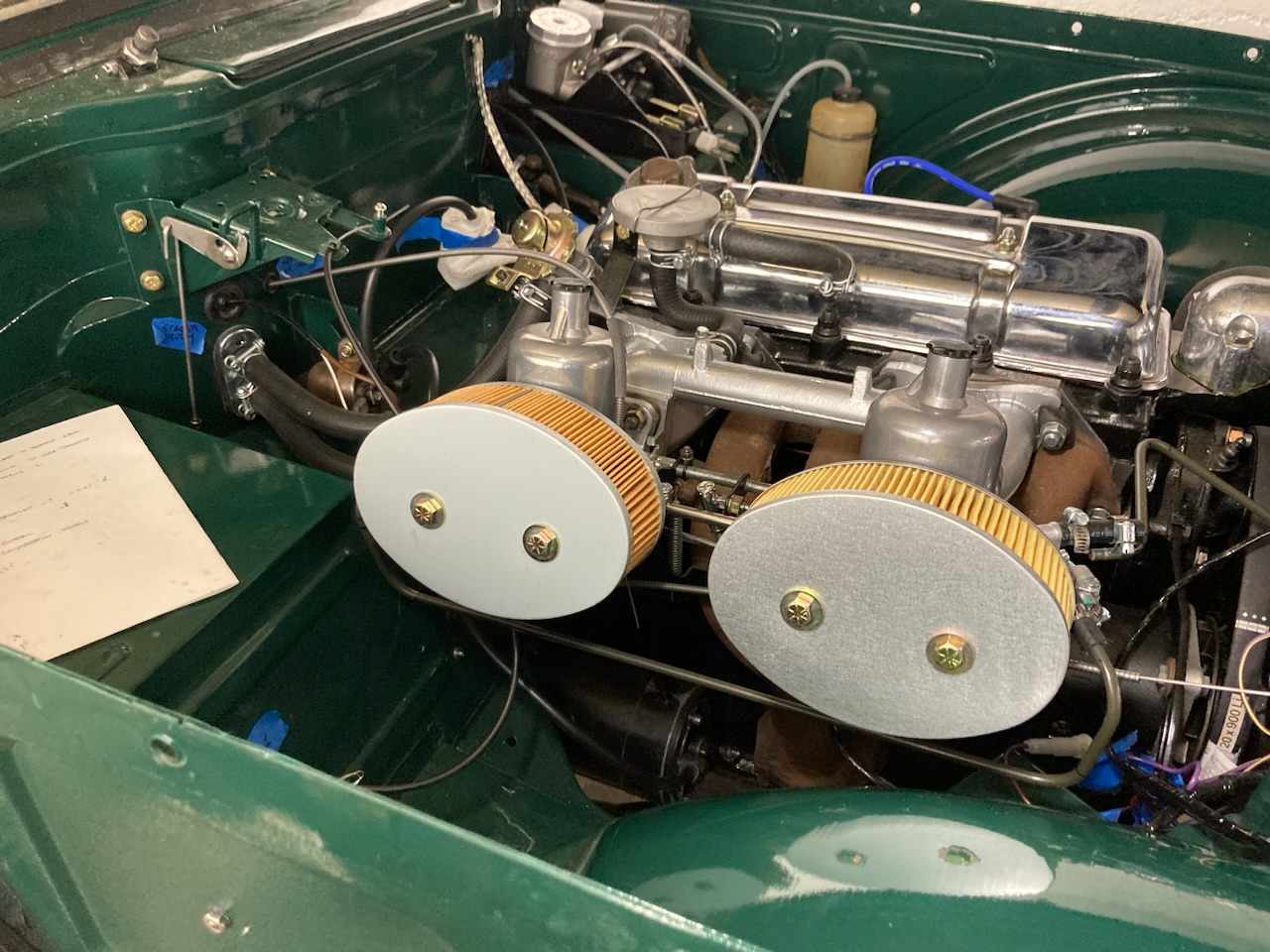

Installing the carbs is a bit fiddly, keeping the throttle and choke rods in place, plus some of the 1/4-28 nuts require pulling the carbs out a bit too clear the bodies - possibly because the new studs are longer than the originals??

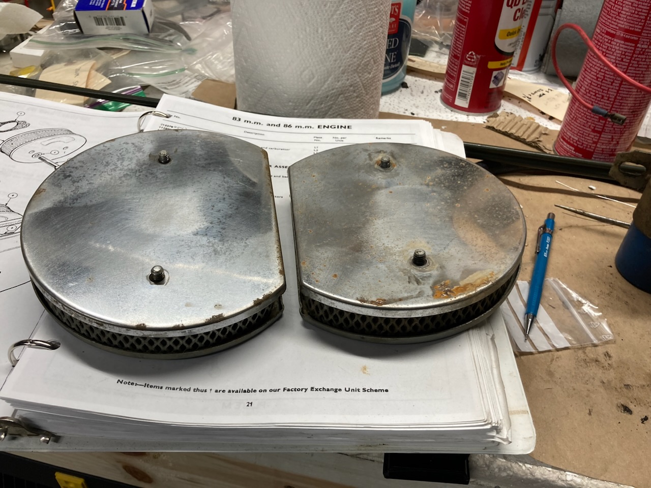

I used basic filters; I may go with K&N later, but they are expensive. I’d love to use my original pancakes, but suspect they are not terribly efficient - I cannot find paper elements for them, and filling them with some sort of oily wool does not strike me as effective - but I have no knowledge in this area.
I also cut the choke cable housing pretty short, with hopes to not rub against the closed hood. The cable instead rubs against the carburetor housing, so I added some shrink tubing in that area. Note: since then I put shrink tubing on almost the full length of the cable. The metal sheath runs awfully close to the battery and high power bits. So I added a layer of protection.

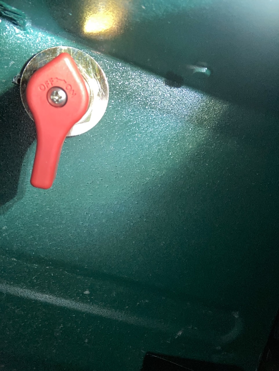

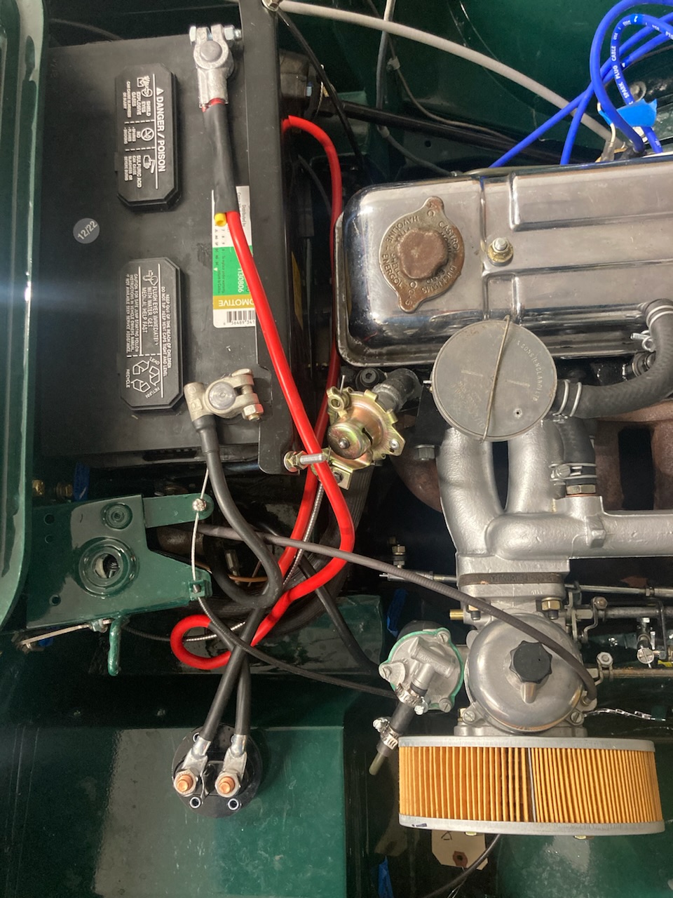

Battery disconnect. I installed a Shallco 500D on the passenger side. I don’t have a good photo, but will post later.
I connected the switch to the negative side, which entailed running cables across the battery and back. (TR4A is negative ground.) A bit of extra mess, but functional. Housekeeping is needed with cable ties for the many control cables, battery cables, speedo and tacho cables, and wiring. I’ll do this once everything is in its place.
For the battery I used a group 27 Interstate, from Costco. Heavy - I got some exercise lifting it in and out!
The battery tie-down bar: I replaced the nylock nuts with double nuts. Threading the nylock down the long length of rod with the other end loose is a pain, to put it mildly. Also - more importantly, the bar comes awfully close to the terminals. I cut a recess for the positive terminal, and need to do the same for the negative terminal.

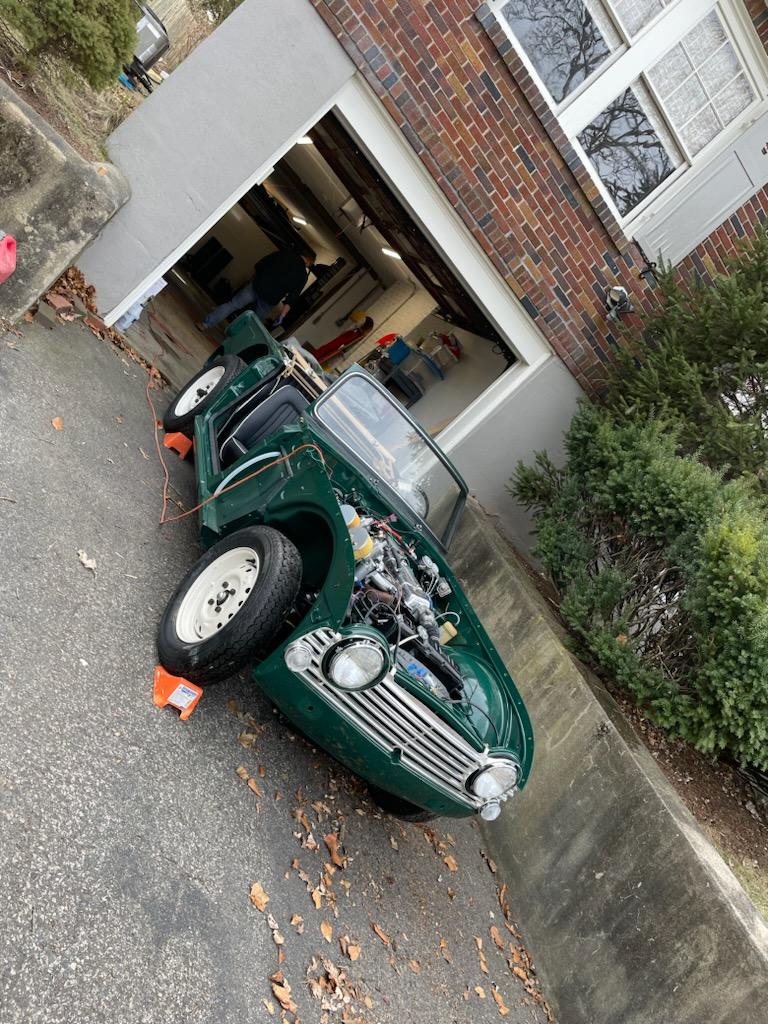

First Run! Missed Sir Black’s birthday by two days.
Filled the engine with 30 weight Penn Grade oil (many thoughts and opinions on the right oil 😀), and the radiator with 50/50 NAPA antifreeze.
After completing a long checklist of items - from battery disconnect to functioning brakes and clutch, and reading an excellent post on Grassroots Motorsports: “13 steps to ensure you don't blow up your engine on first start-up” by Carl Heideman, > 13 steps to ensure you don't blow up your engine on first start-up <, with major case of the nerves, I turned the key.
First without the plugs to build oil pressure. This took a bit of time, maybe 45 seconds for the gauge to start moving. I do not have a long enough and strong enough rod (boy there is a bad joke…🤪) to run the oil pump directly via the distributor shaft.
Then I pushed the car out of the garage. I put a few gallons of gas in the tank, and primed the pump with the lever (glad I bought the upmarket TRF pump!).
Nerves! I had a drink (water), went to the bathroom, ate a cookie, and finally took a deep breath, and cranked it up. On the third try it coughed to life - and quickly settled down beautifully. I hit the accelerator to 2000 rpm, watched the oil pressure climb nicely, and soon saw a cloud of smoke…
Water was peeing out from the rear plug in the engine. I had masked it when painting the block - and did not see the missing plug. (The tape sealed coolant surprisingly well, the coolant loss was minor.) I shut it down and pushed her back into the garage.
But she sounded so good for a few short moments. Since then, I’ve opened up the idle adjustment a bit (so the motor will idle at 2000 rpm). I’ve plugged the hole this week (1/2-20 bolt plus copper washer), refilled the lost coolant (actually I drained and replaced), tightened an oil leak at the filter, and will restart this weekend.

Two photos of my battery disconnect. In hindsight I might have moved the switch a little further back; I have to stretch a bit to reach it when sitting in the driver’s seat. The battery cables from NAPA are red; I put sections of black shrink tubing on them to indicate they are negative. Unfortunately the positive cable (from TRF) is black… confusing even further the “negative” or “positive” ground! (TR4A’s are negative ground.)
I may turn the battery around, this would shorten the battery cables. Later…
I definitely need to do “housekeeping”, cleaning up the cable runs - aesthetically and for safety: keep wires from touching the hot engine, and avoid any accidental shorts.
