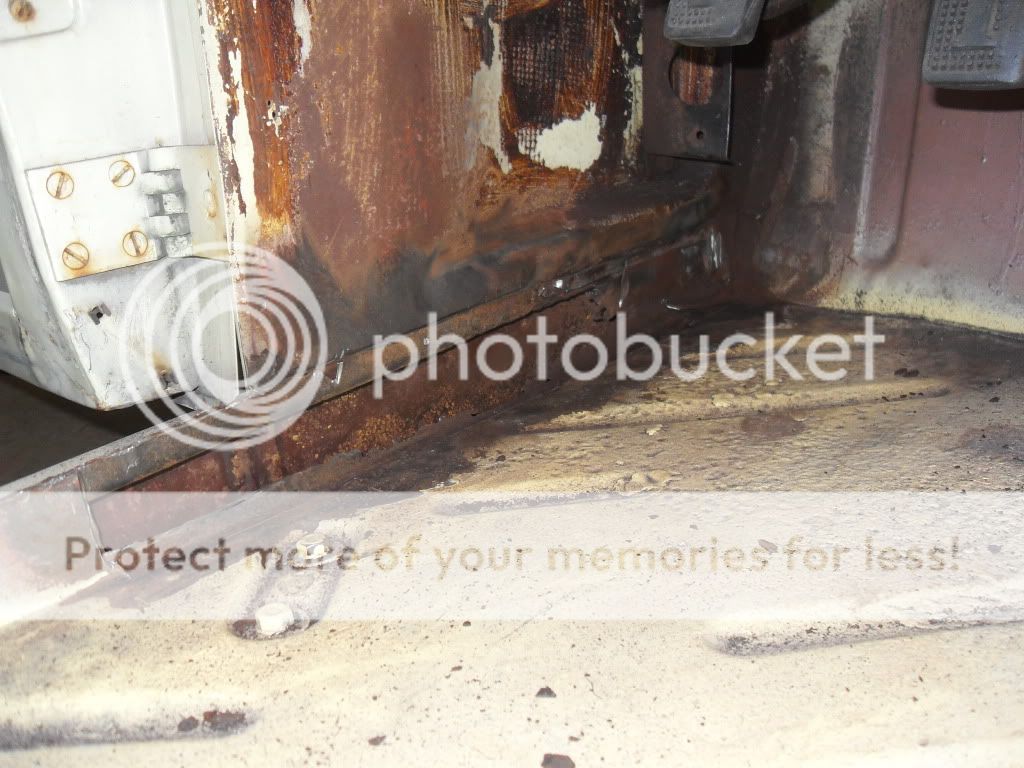

I finally got to work on mine to day. I really just started with cutting out the stuff that I know is going away. I'll work on cleaning up everything next. As far as I can see the sill and the floor/kickpanel pieces are separate. With the sill being a bit thicker material. I think that I am going to try and put it back in two pieces like it was. I purchased a flange tool at a local tool store, it works of of my air hammer. Because it is a small piece I think that I can use some angle as a brake and recreate the bends. I'll replace the inside of the sill and the bend a piece to attach to the floor and kick panel.
Oh and all the stuff on the side wall is just 50 year ol glue from the carpet.

Hi Eric,
Nice pics. I didn't think that you were going to get into is so quickly.
Yes, there are two pieces. The sill is defiantely thicker and I used 16 guage. That is my first patch. The Second patch will be to add on the verticle edge of the floor that attaches to the sill. Looks to be about 18 guage
