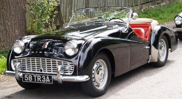

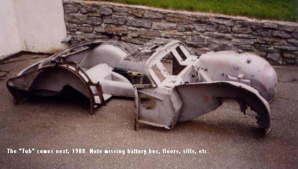

I also agree that the original panels fit better than the repros. When I was doung my 1958 TR3A from 1987 to 1990, I found that the bottoms of both front fenders were rotted through as well as all four fenders hardly having any flanges still on them - the flanges where the fenders get bolted to the tub. Also most of those captive boxes and the flanges they hide behind were non-existant.
With my MIG welder, I repaired all those areas and the car still looks terrific after 20 summers and 102,000 miles.
Below you can see that my tub in 1988 was in two pieces - the front clip is separate from the rear clip.
