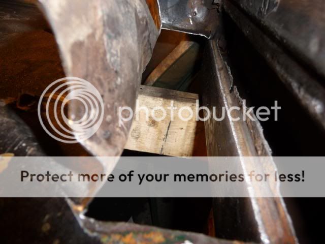

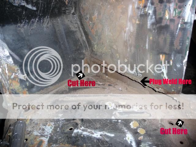

So, my first repair will be the passenger side floor kick panel/inner sill area. Looking for advice on the repair but I wanted to also tell you what I am thinking of doing.
Last night, I managed to clean the area up a little better than what is shown in the photo below. I have good solid metal at the top of the sill and solid metal on the outer and bottom of the sill just below the floor line. I would like to do this repair in two stages.
1. Cut there floor where indicated and bend back or down slightly to access the sill area level with the floor and slightly lower. Clean and square off the repair section in the sill. Before closing in with metal I will be spray inside the sill cavity with rust converter and paint and used weld through primer on the back/inside of the patch panel. Plug weld the top of the new sheet metal to the sill flange just below where the verticle side piece begins. Finish welding in the repair piece to close in the sill. Clean up welds and prime.
2. Clean the outside edge of the floor pan. Weld a new 2 inch verticle piece (approx)on the side of the floor pan. Reposition the floor pan Plug weld the top of this verticle piece to the newly repaired inner sill metal. Repair the cuts in the floor.

Sounds OK to me. The sides will be covered with the sidewall carpet and the floor with black rubber mats or carpet. Should look fine after it's all finished, painted and carpetted.

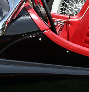

If your "A" post (s) have been cut off, are you planning to install new ones. If so, I have one for one side (I'll have to check) but they must be check fitted before you weld them into place, otherwise the door gaps may be out - in all dirctions. When I did my 1958 TR3A, I didn't remove the "A" posts but they were not quite right as the curve above the door gets wider as you look towards the top of the curved gap. This is hardly noticable on my black TR but with lighter colours, it can be easily detected. My front "clip" for the tub was too low at the front bumper end which left this gap open at the top just before I re-welded the bottom end of the "A" post to the top of my new inner sill.
See photo of mine.

Looks like a good plan to me MP!

Ok,
Spent a little time out in the garage this evening and made some progress. Here are a few pics.
Cleaned up a little and ground the top flange of the sill to make sure there was good metal there and there was. This is where I plan to plug weld the top of the new metal to.
Floor Cuts. I ended up making three cuts in order to be able to more easily bend the floor up.
Floor Bent Up. The lower part of the sill is solid.
I am going to trim the ragged edge on the bottom and use the natural edge to weld to on the bottom.

So the plan is to put a new metal strop in the gap on the bottom picture? If so you might want to flange the metal and do a lap weld rather than butt weld for your first going around. Now knowing the quality of your other work maybe you'll butt weld it and show us how it is done, but lap welding is easier and you won't see it with carpet/panels and fenders in place.
A continuous lap weld would also be strong than plug welds (assuming equal penetration on both).

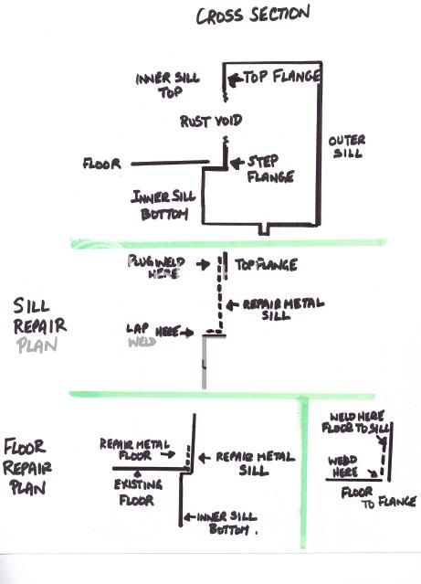

Hi Guys,
I drew it out as I planned to do it.
See if it make sence
All I know, is in the end whatever I do has got to be better than the fiberglass patch that was covering the area :smile:
M. Pied Lourd
tdskip
That should work fine. Clean the heck out of the area to be welded, then clean it again.
Are you using weld through primer such as;
Keep us posted - once you get the hang of using a MIG you'll wonder how you ever did without it!

Made a slight change to the drawings above based on the patch repair metal that I picked up yesterday.
I am going with 16 guage metal for the sill repair and that is going to be a little hard to put a flange on the bottom as I don't have a metal brake and my little vice is not going to work. I made the patch piece last night and I am pretty confident that it will work out fine.
Hope to post some pics tonight as long as my welding doesn't look too bad :smile:
M.Pied Lourd
Don Elliott
Dave - Looks OK to me. If you use those ideas with the "overlap" joints and the edges will be covered with carpets, etc. you could use tack welds along the joints to save the bother etc. with the "plug-welds" you referred to earlier. I assume you will use a seam sealer along those joints before final painting so no-one will ever be able to tell if you did it with plug-welds or overlap tack welds.

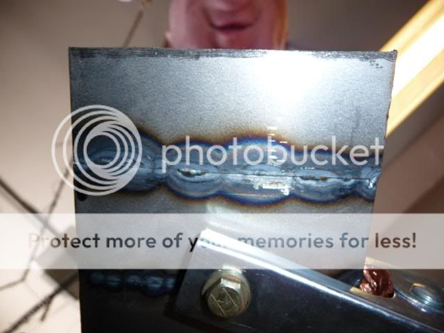

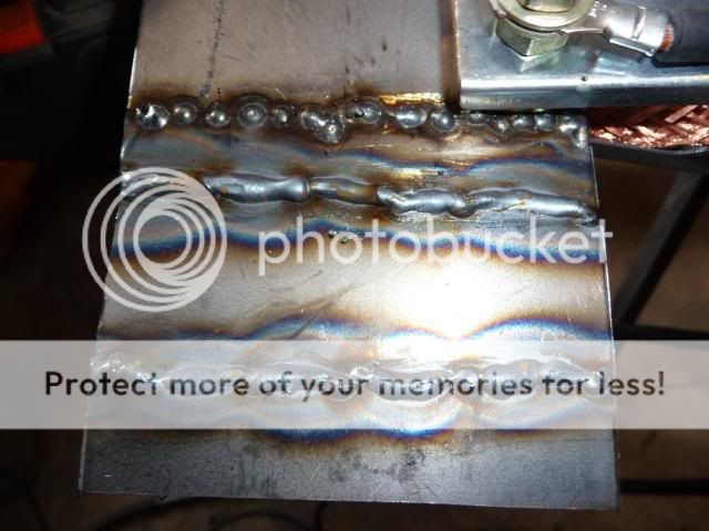

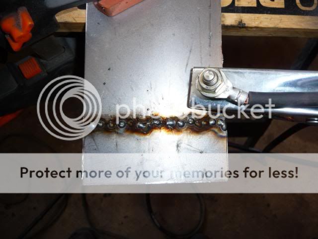

And some pics of my first ever attempts at welding. Feedback is welcome.

tdskip
Hey - good start! Kind of cool to be welding, eh?
You need to get more weld penetration going. The metal needs to "soak" for the lack of a better term into the back side more.
Don't worry about trying to run a bead yet, work on getting the spot / tack welds to have good penetration. Once you get a sense of that it will make running continuous welds much easier, and of course you can always then tack weld all the way around instead. Sometimes on thin metal that is a much easier way to go and perfectly valid as an approach.
Here is a good link;
https://www.millerwelds.com/resources/tech_tips/MIG_tips/
