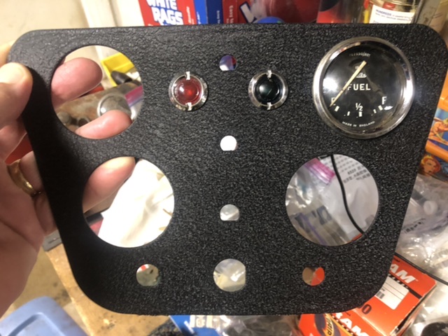

More work on the center gauge cluster..
I got the light bezels cleaned up and installed. I went to move the switch over that I had made key for and found this issue
I am not imagining that working properly with the back all cracked and broken. I looked for a replacement but the only ones I found have the terminals blades on the back not the screw style like this one. I want to reuse the old keys number but not sure if the cylinder will fit the newer repro housings...
anyone know??

I don't think so the bezel on the repro is a different size with a hex nut to hold it to the instrument panel. I would try and rebuild the back of your original, it's a very basic switch and as long as it holds together it should work fine.
Graham
JP, I would check with Marv to see if he has an original switch. If you can’t find a good one, I think I can mill a back plate out of Delrin for you.
Could you build a form with masking tape and clue the cracks and form the side with JB. They come up sometimes on Ebay. Maybe move to something else for a time. Like John suggest Marv might have something. I moved my key over to a spade connected type some years back when the ignition switch stopped working. Looking good JB, nice to work with something clean, right.
Got a few more things figured out with the switches then this happened, apparently there were differences in the d shaped cutouts and sizes..so finally stripped the original one and
got the paint on it...geez
So it looks like the only thing missing is the push button starter switch...:the ignition key has been reconfigured and the key cylinder did move
over...
Looks great PJ--- that is how I like to see them--- original. The original dash really sets the car off as a classic. I give a coworker a ride, and he enjoyed how the amp gauge bounded around. Glad to hear the key lock will move over still to the newer housings.
