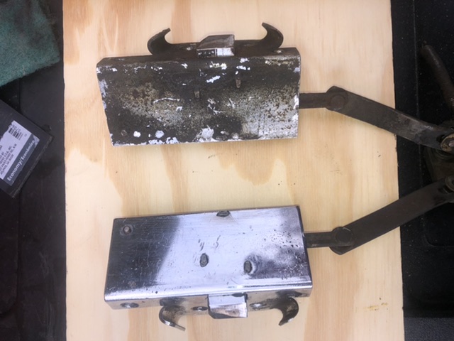

Had to work this past weekend so not much to report. I managed to get in the garage a few hours here and there to finish the other two brackets. I got another box of parts labeled and on the spreadsheet. I got a couple door latches cleaned up some, mind you that I am going for functionality not concourse.
Cleaned up nicely. I would have kept my originals if they had any chrome left to polish like yours.
They look great JP. I have heard rumors the new ones have problems. Plus it is a difficult part to clean because they are crimped together. I use old ones also when I can!
You are right, one of my new one's poped apart at the crimping, I managed to put it back together but a changed it for one of my originals.

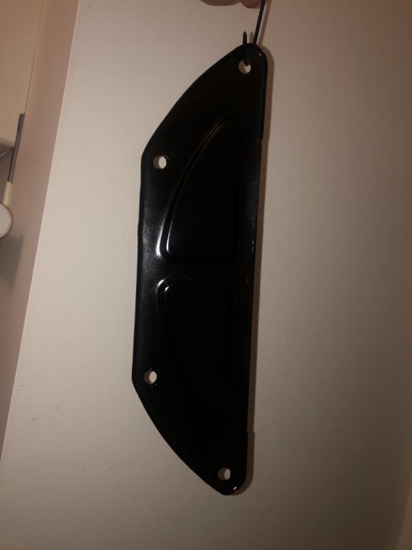

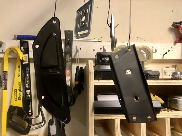

Keep going through boxes and finding parts. I now have a box with seals and bearings for the rear end. I pulled out a couple more pieces and painted them.
So I know the one piece is the transmission mounting bracket. I think the other piece is the lower cover for the transmission where the flywheel is.

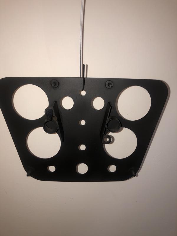

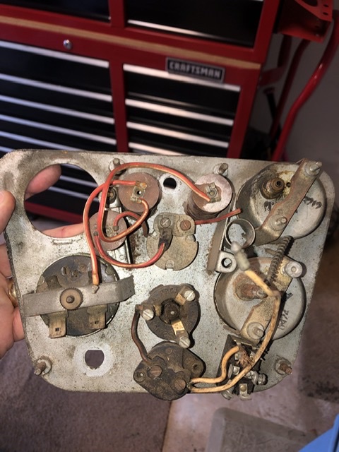

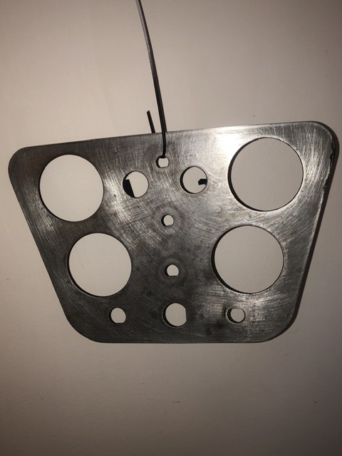

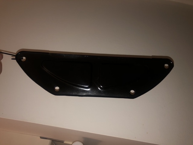

Today I switched gears and did a little center console panel work. It started a bit rusty like this
Stripped and rust converted the back with a black paint

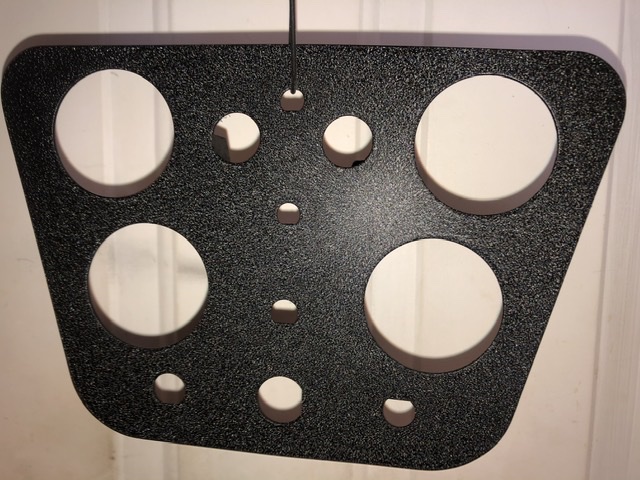

Sanded the front clean to prep for wrinkle paint
Here you go with the finished product. I think it will do fine I may add some satin clear coat over the top after it dries. It has a slight amount of wrinkle and I am ok with that.
