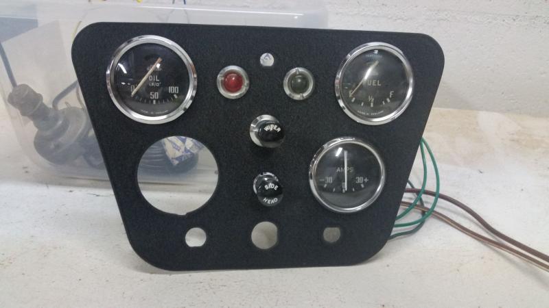

Your wrinkle finish came out good, I think the general thinking is to paint the back white because every bit helps when trying to find something after it's all together and you have a problem.
Graham
Correction it's the back of the dash painted white, I just looked at my resto photos and i painted my instrument panel black like yours.
Graham

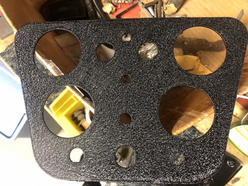

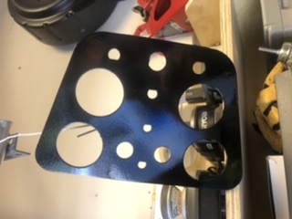

Well as life teaches sometimes things never go as planned. I gave the console 24 hours to cure and it never did. It might be because that can of paint was really old, so I will be stripping it for try number 2. I don't mention vendors but it was Eastwood product, has anyone else used this style wrinkle paint. I am thinking to go with a different brand in the hopes of not recreating this scenario.
I hate redoing things but i want it to function properly. Thanks again for all the encouragement and advise/shared information along your journey.
I think I waited until the wife was out of the house and cooked mine for a couple hours. I did it to "enhance" the wrinkles...but you could try it to force the paint to cure as a last effort before re-stripping?!? It does stink up the house.
I got my paint from the local auto parts store. I redid mine also. What I do is put in the oven on like 150 or 200 after it sits outside for like 10 to 15 minutes. I put it on one of those cheap throw away sheet pans; the process takes just a few minutes in the oven and you can watch it wrinkle. The gauges are so tight going in the holes that too much paint build up will not let the gauge go in easily. I did put 3 coats on of the wrinkle paint on but had to sand out a couple of edges on the gauge holes.

So I reached out to the Vendor in an effort to not recreate my issue. They were not helpful because I could not provide the exact order number. It was a gift....I did explain that so and the vendor has thrown up there hands in a kind of who cares attitude. So in response I will choose to spend my money with a different paint supplier!! I am sure I can find the same kind of product soon

Take two.....well and three.... take two created a huge run so I wiped it clean with prep sol let it dry and recoated with paint again.... now to let it cure at least 48 hours due to humidity.... fingers crossed
Well the other one looked good also until I tried to handle it. Sometimes you have to go back to move forward.../ thanks for the words of encouragement

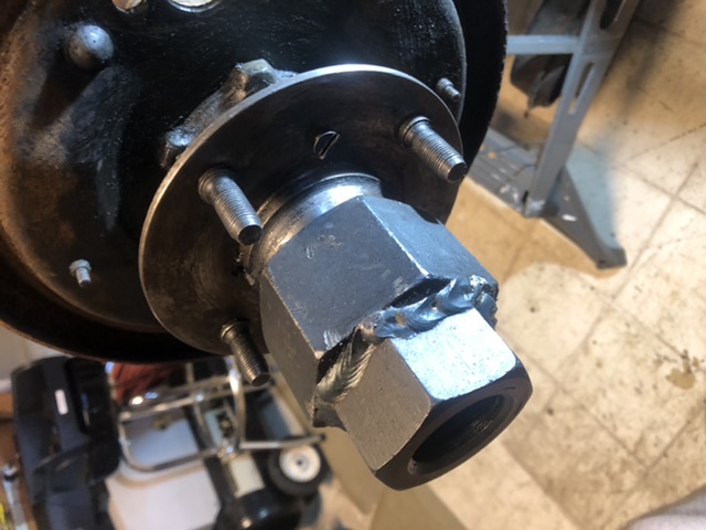

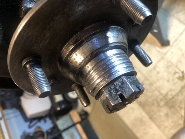

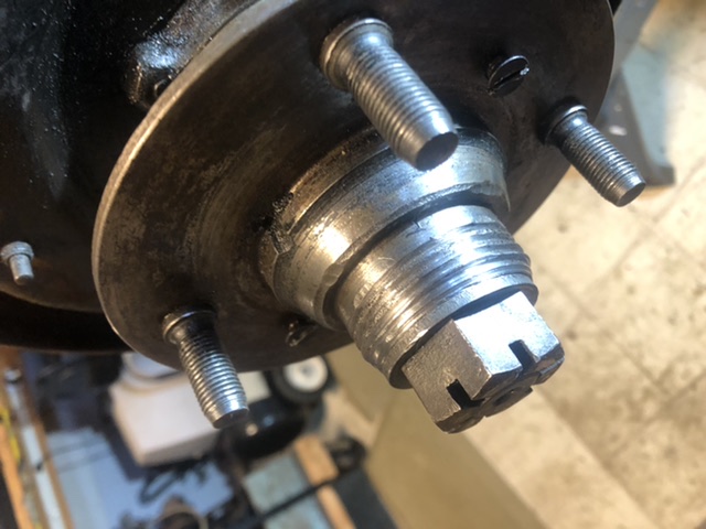

I decided to try something different because time and money are always a factor. I read Dave's (HawaiiCJ) post on a simple way to separate the hub and axle. Imagine my surprise when i look up where he is and realize that he is 25 minutes away from me. So after a quick PM Dave not only said I could borrow his tool but he was running some errands and could drop it off. OK that is a deal. Thought i was all prepared.....hit the parts backorder for a delay and then was ready to get started. That is until I tried to thread the nut/socket combo onto my axle.
[/URL][/IMG
then this happened
[/URL][/IMG]
I will now be spending a few evenings trying to clean out the threads in order to get the tool to bite properly so i can have as much threaded force needed to get this a part.
Well that is about it lately and I had to repair my lawnmower.....I don't really want to spend a bunch of time in the garage cuz it is hot as ****...unless i am grabbing something from the fridge.
Summer Fun.
Glad you’re getting some work done. That special tool sounds like the way to go. I plan to make one next time the hubs have to come off.
So it was a LOT of hand filing but I want to say I won....
The tool is installed and tightened down I measured both sides. The distance was .61 not the non hammered side and .68
on the repaired the side so
I think that will work.
