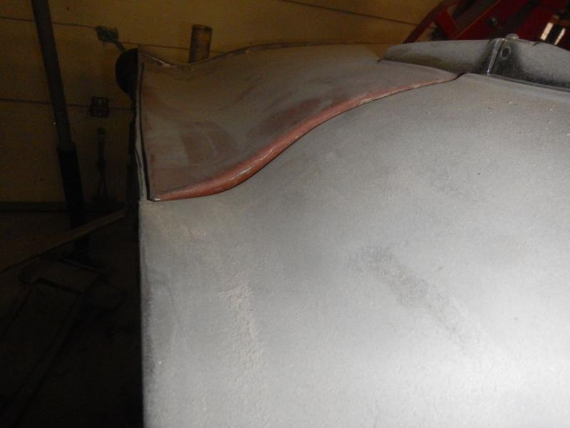

The car came with 2 trunk lids. One brand new with UK stickers. Probable purchased in 1999 or 2000. The other had been damaged and repaired passably by the PO or PPO .
When I trial fitted the new one to the car I found there is some misalignment. Have not set the other one on the car yet to see how that fits. My question is if I were to go with the new one should I re contour the rear panel or just live with it. I do not think the lid could be fixed by someone of my abilities.

That should not be too hard to tackle...or at least to get close enough that a small amount of filler will blend the 2 panels. I've been sitting here trying to think of the best way to put it into words.
As I see it, the outboard edge is good...and of course the hinge level is good too. The mis-match appears to start just outboard of the hinge and gradually increase it's mis-match until it reaches a maximum at the bottom of the "trough". It then comes back into alignment at the outboard edge. So, here is how I would go about it...
First, use a large screw driver or paint mixing stick to wedge into the outboard edge. This edge is in alignment, so we want to hold it there. The hinge will hold the inner side in alignment.
Next, you don't need to work a small area, but instead want to gently bend the trough lower. This means you want a contoured hammer that is rather large, so it will not impose small dents in the trough as you work it. Here is a dolly I have that would be just about perfect for the job. Yes, I would use the dolly AS a hammer in this case:
If you hold the dolly at the same angle as the trough, and tap it downward WHILE having the outer edge restrained, the trough will bend downward. Of course you will have to work from the front edge of the lid backward to contour the panel as far back as needed. If you think about it, you will be hammering closer to the outer edge than the hinge. Therefore the most bending will happen closer to the edge than the hinge...and that is what you want to happen.
You will also be violating the general rule of bodywork to always have a backing dolly...but in this case you are trying to gently work, or bend, a relatively large area, so we can get away with breaking the rule.
When you get close to aligned, you may have to work a little with a curved hammer like this one:
But that assumes the curve of the hammer matches the curve of the lid, and once you start with a smaller headed hammer, it would be best to start using a dolly under it.
One last note. If you think about it, as you increase the curve in the trough of the lid, the forward edge has a lip...easily seen in your picture. This forward lip is normally bent to angle a little to the rear, instead of straight 90 degrees downward. If you think about it, as the curve increases, this lip must mildly increase it's angle to the rear. In fact, if you tap it to the rear before you begin tapping the trough lower, then the extra angle will automatically increase the curvature you are looking for. Another way to speed the bending may be to use a technique like this:
In this pic I am straightening an edge lip with a reverse bend. You would be using the same method to increase the amount of reverse bend at the bottom of the trough.
This is all hard to explain so you can visualize what I am talking about. I wish my Triumph was close so I could take a picture worth a thousand words!?!

I do have the bracing fitted bit it is a rather tight fit. The spacing between the holes in the bracing is not correct. I had mainly fitted the boot lid to check the alignment of the rear wings/boot inner faces. That was when I noticed the front edge problem.
Thank you John for the comments and hints. When I get home I will take a long look at that area and get back to you for more hints. How will the inner structure affect the hammering/tapping.
The old boot lid may be a better option. Had not considered it till yesterday when I got it out and took a look.

If you were fixing dents, then the inner structure would be in the way. For the type of tapping I am suggesting you are trying to contour by bending, rather than removing dents...so it would be best to have the inner structure in place.

I thought the only time I would debate John would be in a poker game, but I would remove the brace and the metal will probably bend with your fingers. I tried getting a dent out of the area under the trunk hinge with the brace in, and it killed me. I did get it out with the brace in well, most of it, but again I wish I would have removed the brace piece because on another trunk lid I did, and the metal was scary flimsy. Plus I am still alive.

For clarity, I understand that John was talking about moving metal and removing dents as 2 different types of bodywork. This came to me last night when I was trying to fall asleep. One of those epiphany deals. Plus those braces tack some work getting out.

Also as I formed the metal down would the edge tend to move in and away from the wing?

Yes it will...you're beginning to visualize how it works! It should only be a small amount, however, that can be blended along the edge from front to back. The wing mounting lip can also be moved over to compensate for the added gap. Remember the rear wings mount with those mushroom topped screws back there, so you may actually need a bit more gap to the lid to clear those screw heads. The beading then reduces the gap a bit once it is installed.
The boot lid is one of those matching jobs that can't be rushed. You are aligning to 4 different panels, so plan to use up the best part of a couple days until you are satisfied with the fit. Even then, in the end you end up deciding the best compromises you can get.

Fitted the original boot lid and found it fits well. Needs some work but the edge profile is much closer than the new one. Also found why the cross brace did not fit the new one well. The lower edge location points for the brace are about 1/2" too far apart.
I will dig out the old bondo and see what I can do to help the dents.
