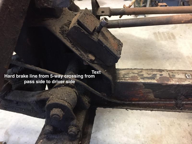

Here are some pictures I took during disassembly. You, and John and Tush, are motivating me to get back to work!!
fullsizeoutput_fbe.jpgfullsizeoutput_fbf.jpgfullsizeoutput_fc0.jpgfullsizeoutput_fbd.jpg
Perfect. Thank you.
I saw the clip on the angled frame member and thought the line may use it but was not sure where it ran. I did not take this TR apart so no photos to go by.
