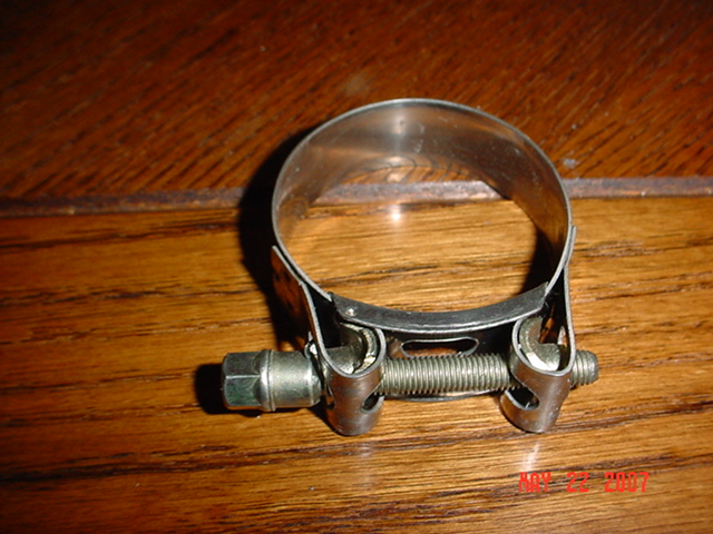

Attached is a pic of a high quality "Mikalor" exhaust clamp. Considerably stronger than the kitchen sink variety. There are many similar looking clamps available but they do not clamp nearly as well.

Dave is right (as always). Because the clamps are wide, they do not indent the stainless so you will be able to separate them in the future. They work great. I also used some exhaust cement from Moss so they seal better. These calmps are pricier than the Home Depot but they allow you a greater amount of tightening.

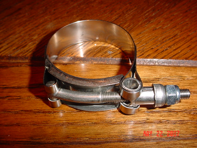

PS - I attached a pic of a "farm" supply clamp which looks similar but has no where the clamping power & strength of the Mikalor.

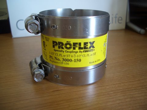

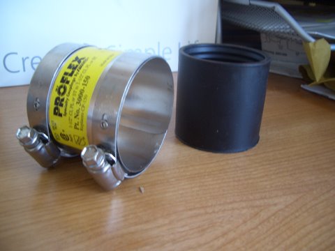

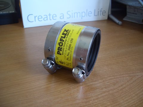

Go to Home Depot and buy the smallest size Stainless Steel flexible pipe coupling (with rubber insert... 1-1/2" or 2", I forgot what they have). Throw out the rubber insert and then fix the stainless steel part around the junction between the muffler and header pipe. Then put the OEM style British clamp over the outside of the coupling... with this set up it will never leak. The coupling looks like a short two inch long piece of SS pipe with two regular hose clamps around the outside. These are the drain couplings (in the plumbing section) that are used to hook up a sink with the pipe when the two don't screw together all that well.

Those are excellent clamps. The Drain Couplings I use are a little better because the provide a complete coverage of the exhaust junction, and you can even put some hi temp silicone in there to really seal things up. They work great.

The Burns T bolt clamp is the "farm" clamp that I referenced above. Look at the two pics closely. For whatever reason, the Mikalor clamp has far greater clamping power. It is NOT a T bolt. I have directly compared the two clamps. In fact I have a whole bag of the T bolt clamps that I will gladly donate to someone.

Some of you asked to see what the drain couplings from Home Depot look like. I had a spare so I took a coupla snaps of it. You can even see the part numbers so that should help you find it at Home Depot....
