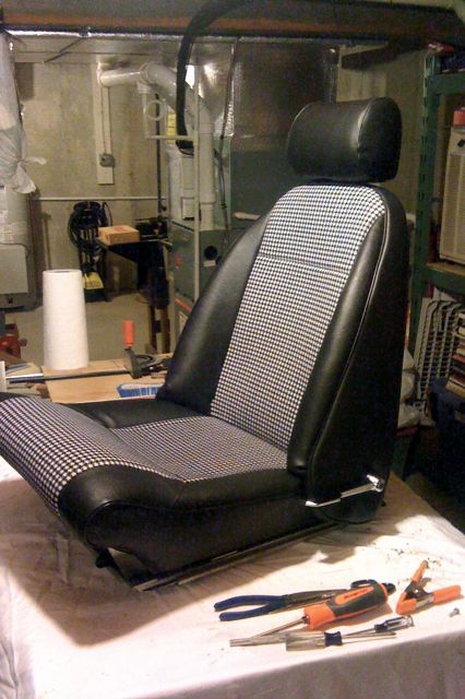

Reupholstering them is not that difficult. But if a pro shop is willing to do it for $100-$150, that's a steal.
I did mine not long ago, same houndstooth pattern. Very pleased with the results.
I bought the rubber backstraps from Rimmer Bros.
