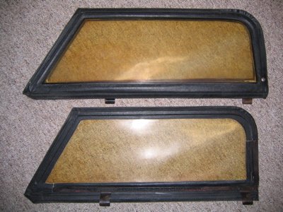

Although ncbugeye is of the early type which had the flexible side screens, which I have, I was very fortunate to purchase for a nice low price on EBay a pair of (I think) original sliding sidescreens with all the metal parts and the "glass" parts although one of them is broken (as advertized). They need a significant cleanup and polishing job, but the only missing stuff is the seals.
Can someone post or send me a picture of what the bottom seal looks like and how it attaches? Also is there any material in the channels, or does the plexiglass just run in the bare metal? I remember my Mini had some kind of fabric in there - the Woody Traveller was famous for having green moss and other less savoury things grow in the rear channels if you didn't clean them out regularly.

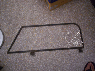

Thanx for the pix Drew. Exactly what I need. I am surprized the bottom edge doesn't extend lower, though I suppose that would work. How does one gain access to the interior door latch? I pictured a 45 degree or so flap diagonally across the rear portion that would flip open?
drooartz
Mike -- If you look closely at the top frame in the picture, there is a snap on the rear corner. Undo this snap, and the fabric/window portion can be pulled away from the frame to get to the door handle.
The lower frame in the picture (showing the inside) shows that the fabric does not cover the frame at the rear, so it can be lifted away. Mine are a bit stiff, but work okay. I'm sure that with new coverings, they would be quite functional.

Aha! my new frames have a hole there where the snap goes! There are also holes around the frame (3 on top, 3 on bottom, 2 on leading edge and 1 additional above snap hole at the back) what are all the other holes for. I imagine one could make a canvas piece that totally snaps to the frame?
jlaird
That would surely keep the sun off the plastic if you parked outside like most of the Brits use to.
drooartz
Those holes may have been added by an owner at some point. On my frames, the material wraps around the frame on the top and leading edge, and is sewn around the frame. I don't have the frames handy right now, but I'm pretty sure the only holes are for those snaps.
