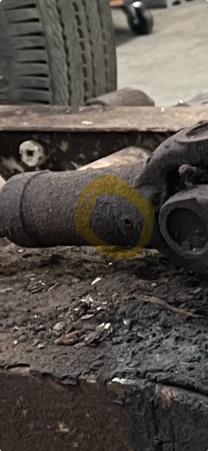

So after I got this yoke cleaned up. I unscrewed the dust cap and tried to pull off the "sliding" yoke. It did not. Found that it had a set screw holding it on. Is this suppose to be a set screw or a greaseable zerk?
There should be a grease fitting on the yoke. If it is not visible elsewhere on the yoke, then your circle is where it apparently broke off.

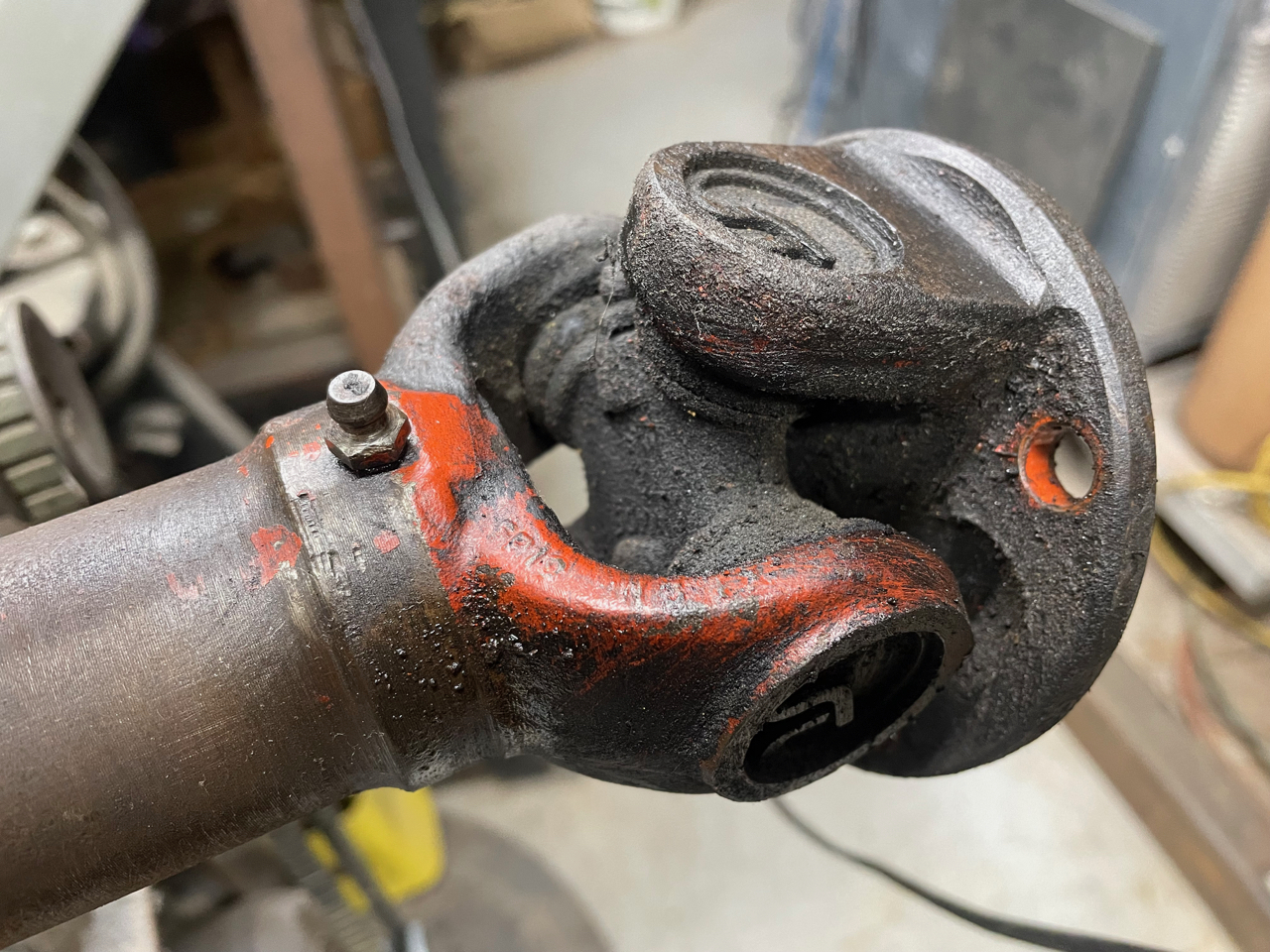

Sorry it has taken so long to get this posted but maybe it will help. Yes there should be a grease fitting on the yoke. Frank
