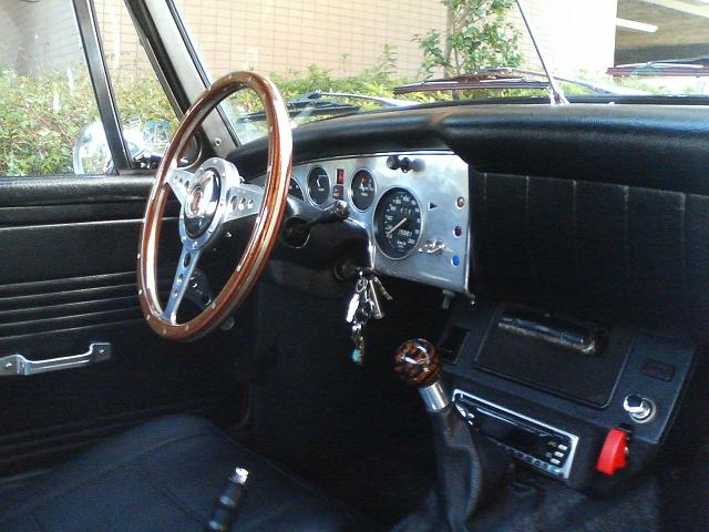

Repeated as needed until I gave up and put a toggle switch on the center console under the ciggy lighter.
There's a hole there already, you'll feel it if you run your hand over the vinyl. Good location since your hand ends up there as you engage reverse.
Then again, you'll have the same issue all over again when you forget to switch it off...
( that's why I ended up putting the red flip-cover on it, helps me remember .... makes you feel like a fighter pilot to boot! /ubbthreads/images/graemlins/grin.gif )
