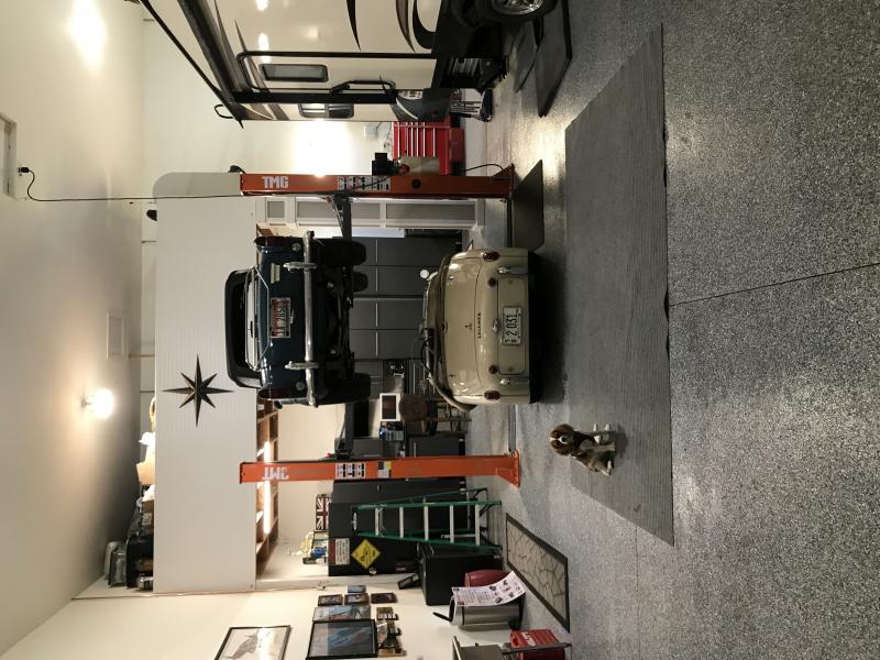

Thank you all. I think that I will remove the transmission and OD and have it checked out. I am glad that I invested in a car lift.
