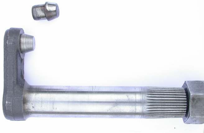

I put in a spring-loaded peg that I bought from Protek in Wallingford, England, before Neil Revinton started to make them. It took out all the slop from my steering. But I have to add that a few 1000 miles earlier, I had re-built all the other links, joints and silent blocks with new parts. It has been fine for the last 80,000 miles.
The main reason for the sloppiness is the tapered peg that goes down into the groove on the helical groove in the worm.
