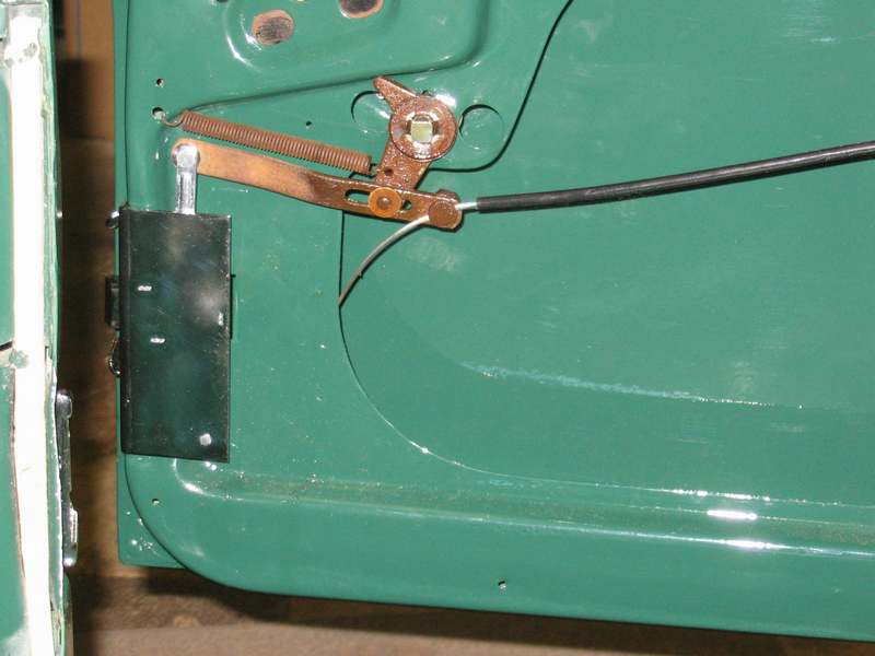

S-T used doors with the two bottom corners square all the way up to TR3As below TS 60000. After that the doors havce rounded bottom corners and fewer wood bits inside the doors on the later TR3As and the TR3Bs.
I have a spare door with the square bottom corners for the earlier TR3As.
Here is a photo for the late TR3A we restored in 2006.
