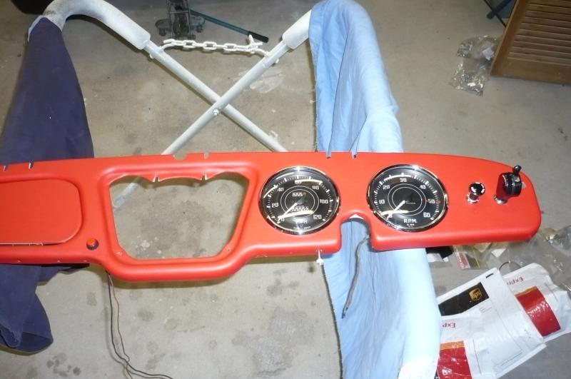

Here's a photo where you can see part of the brace (if its the one I think you're talking about) through the speedo hole
https://i.imgur.com/N6p920v.jpg
