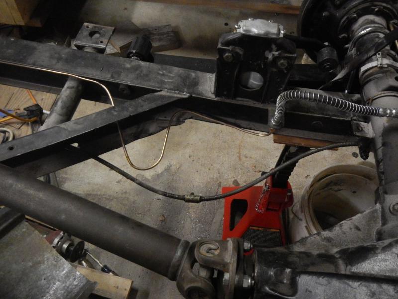

The front to rear brake pipe was a bit too long and as I do not have the flaring tool I decided to make a loop in the pipe to lose the extra.

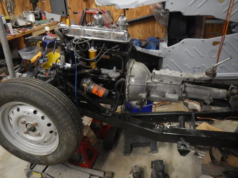

Replaced the Fork. Operating shaft and bearings in the clutch release mechanism. The square headed pin in the old one was sheared off and it took a lot of effort to get the old one out.
Got the motor and gearbox mounted in the frame. I drained the gearbox oil and noticed it was kind of black. Probable long past time to change it. Will any 80/90 weight GL4 work in the gearbox. I think that there is a tractor 80/90 GL4 for old Fords available locally.

Pipe too long.

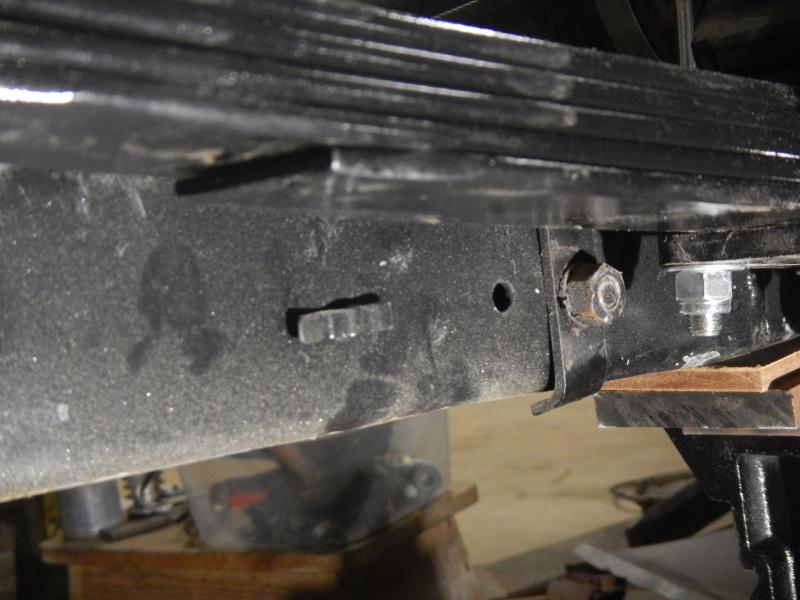

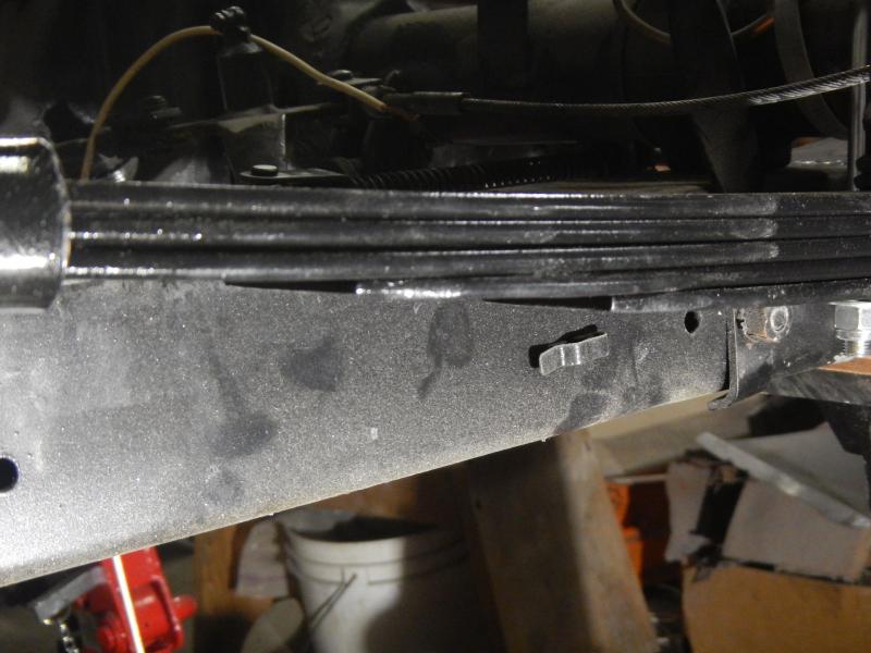

Any idea what this clip is for? It is right behind the axle retaining strap on the passengers side.

David,
That clip is for the fuel tank overflow tube. Once you get the body on and the fuel tank in ,you will be looking for that clip.
Yup, sure does. I blocked mine off to avoid that; let the tank vent through a small hole in the inner cap.

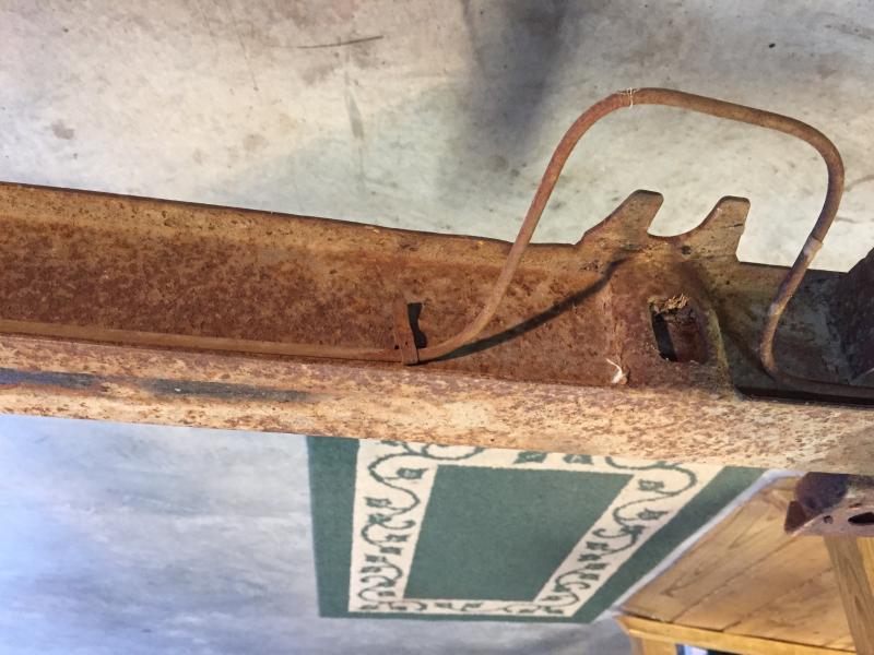

For the "long" front to rear brake line did you leave the loop where the jacking point on the frame is? See the upside downpict.

I did do the loop for the jack. If I had known I would have made the loop bigger.

I found the spring tab. Lucky it did not get caught up in the repair in that area because I did not realize what it was. It was so bent over and that area was a bit trashed when the PO replaced the floor.
I have straightened it out now.
Thank you for the Heads Up on that.

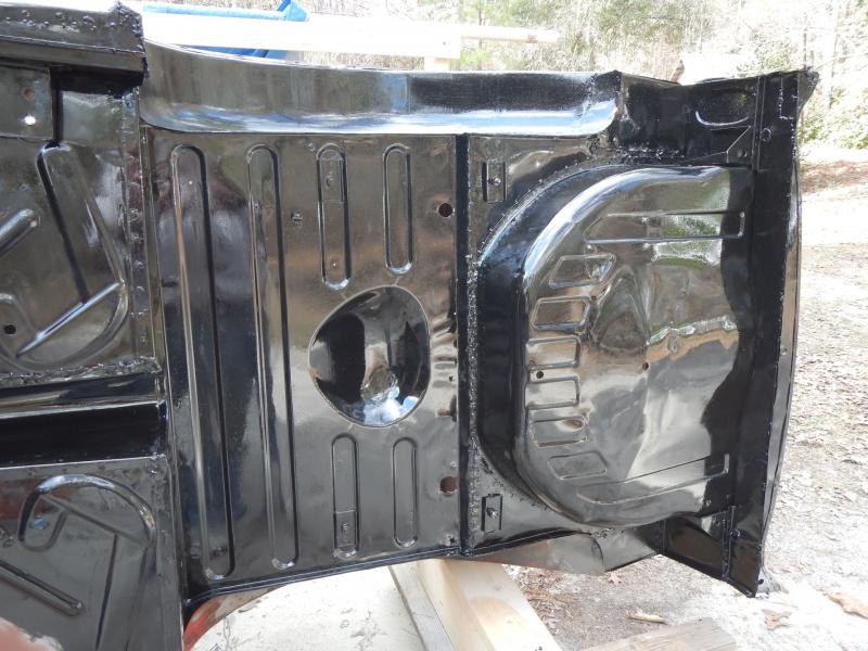

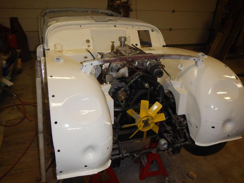

I have the under body fixed, painted with PUR15, primed and painted with the final colour. The body is mounted on the frame and I have the inside of the body painted.
I have to fit the doors and cut out the braces, Hopefully nothing moves when the braces are cut out.
