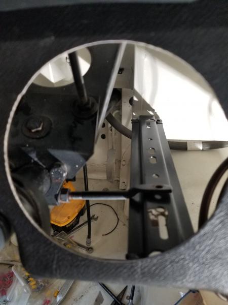

Trying to get the Dashboard braces fitted and have an issue with the piece that attaches to the steering wheel support. The braces do not appear to have a hole that will align with the rod. I presume I have it set up correctly.
There is a half hole in the end of the brace that seems to match a hole in the dashboard.

All those bolts on the column mount are adjustable. I'd recommend loosening them all, then install all the bolts, including the one you are having trouble aligning. Then start to tighten them progressively. I am pretty sure you have to move that brace to the bottom of the dash strut....I'll look for a pic.
Found it. Yep, it uses 3 1/8" washers and goes to the bottom of the dash strut:
Also, when loosening all the adjusting bolts, do not forget the 3 holding the large bracket to the dash. The bracket has extra large holes to allow adjustment. Once all are loose you will be able to find a good hole to attach to.

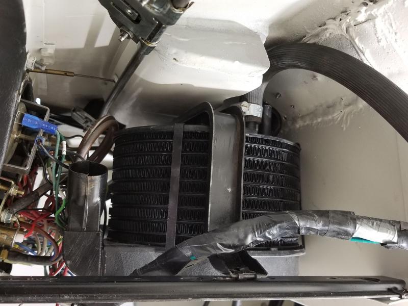

I have the heater in position but am not sure if I have the defrost nozzles correctly orientated. Have a feeling they should go round a bit towards the passenger side.
Anyone have a good photo for reference?

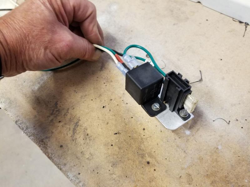

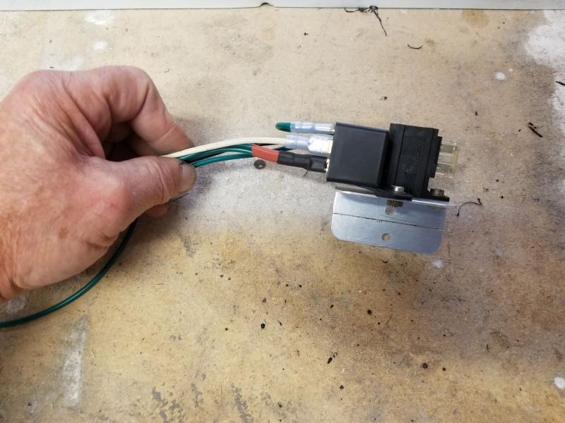

I am going to wire a relay in to feed the heater and possibly a USB + 12 volt power outlet. It will come off the fuse block at A2 but the relay will be controlled by the ignition switch. Hopefully that will prevent me having a dead battery because I forgot to turn the heater off. Am including a fuse as well.

Yes, the defroster outlets go on the side, so the doors on the bottom open left and right. Here are some photos from Frank Angellini
You might want to consider making the USB outlet hot all the time; in case you want to (say) charge the phone you've been using for navigation while you eat lunch. My wife's car has it shut off with the key, which annoys me. It can be a long term risk for running the battery down, but only if you leave something connected for several days.
For anyone else who is wondering, the normal TR3 heater wiring is through the fuse block and ignition switch, so it normally shuts off with the key.

I presume that the heater supply hose that goes to the drivers side loops over the top of the heater? It is very tight in there and I feel that an elbow at the heater connection would make things easier. It seems the hosed are in danger of kinking because of the tight bend they have to make between the heater and the bodywork.

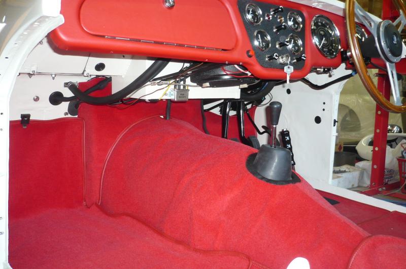

David, you can see where the hoses come down from the heater in this photo and there is no sharp bends,I dont have any photoes of the heater in place

I was referring to the connection at the heater where the hose goes straight up and then has to turn to the side. It seems the hose is in danger of kinking.

I have corrected the defrost tube connection position since this photo was taken. The hose to the other connection is squeezed in between the heater and the bodywork.
