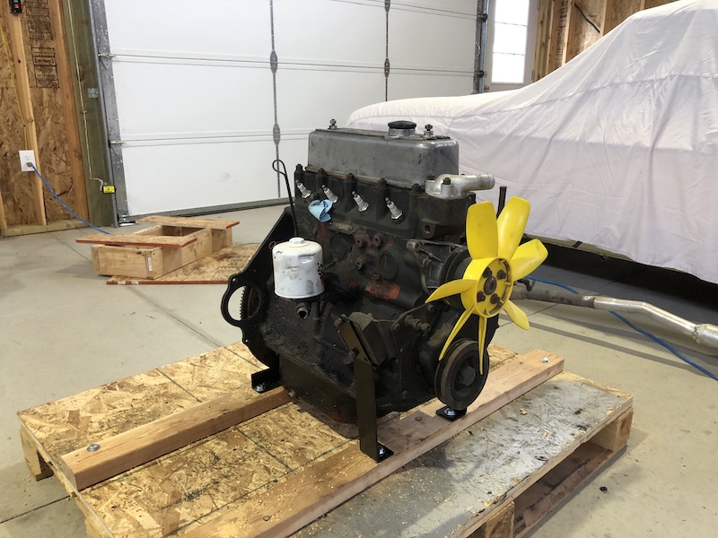

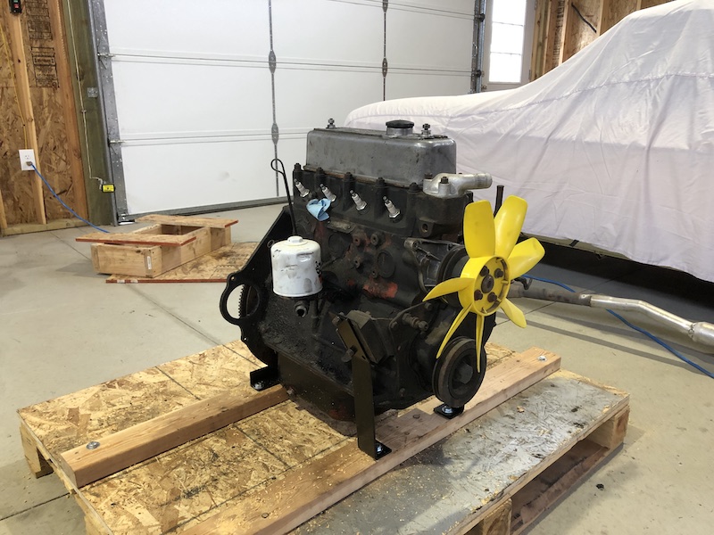

Looks impressive. (Is it worth removing the fan - plastic blades are vulnerable - don't ask me how I know)
I think they'll be okay. This will be snug in the back of the pickup and I've since wrapped the engine in that shipping plastic wrap to keep it all snug.
Looks like you used about $1000 worth of wood
on that engine support.
I was chuckling about this myself. It's on a beat up pallet from work with some scrap OSB screwed down on top for support. The 2x4 was also scrap, quite warped and purchased back when lumber was cheap.
I was very careful with my measurements, however, as I certainly didn't want to buy any more wood!

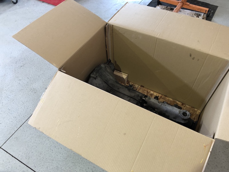

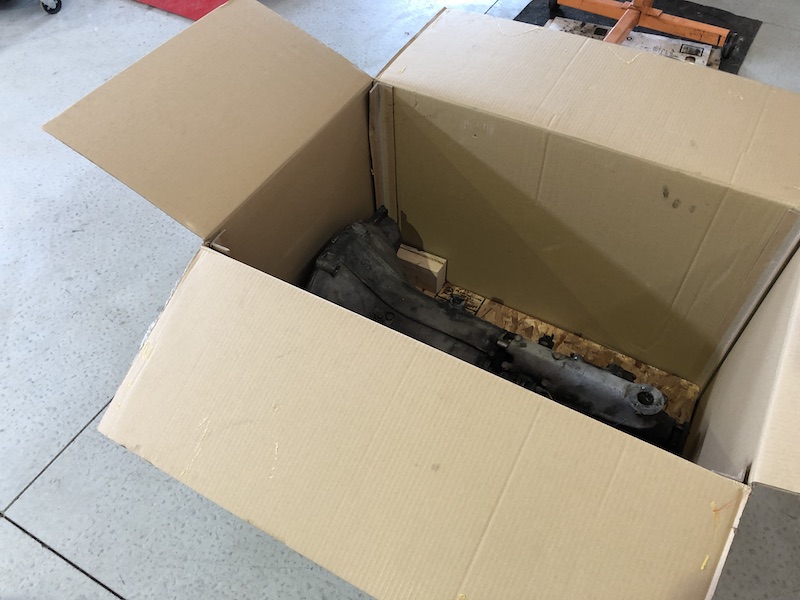

Got the engine and transmissions all packed up and ready for hauling down to AZ for the rebuild. Transmissions you say? I happen to have two OD transmissions, the original from the car and a spare I picked up from a parts car. I'm bringing them both down so that they can use the best one as a base for a rebuild (or for parts if necessary). I've got a couple spare blocks as well, but hoping that the original one won't have issues and will be fully rebuildable.

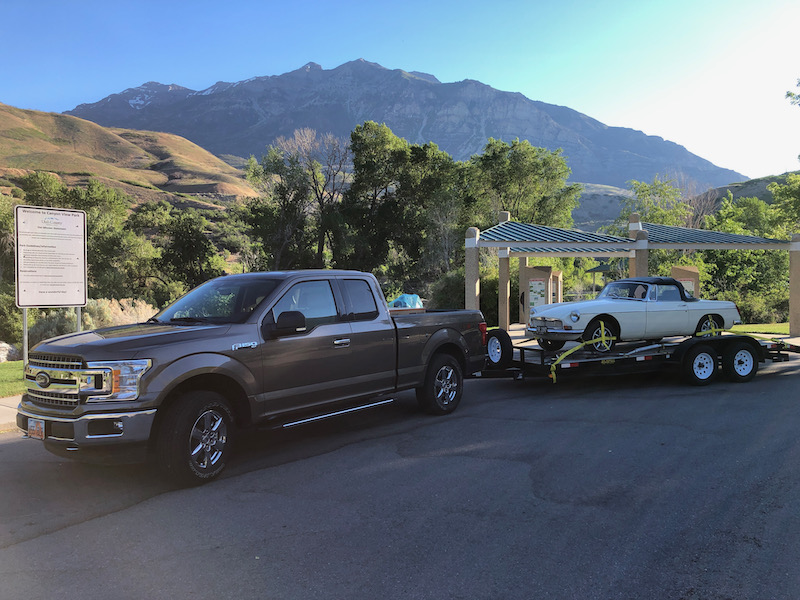

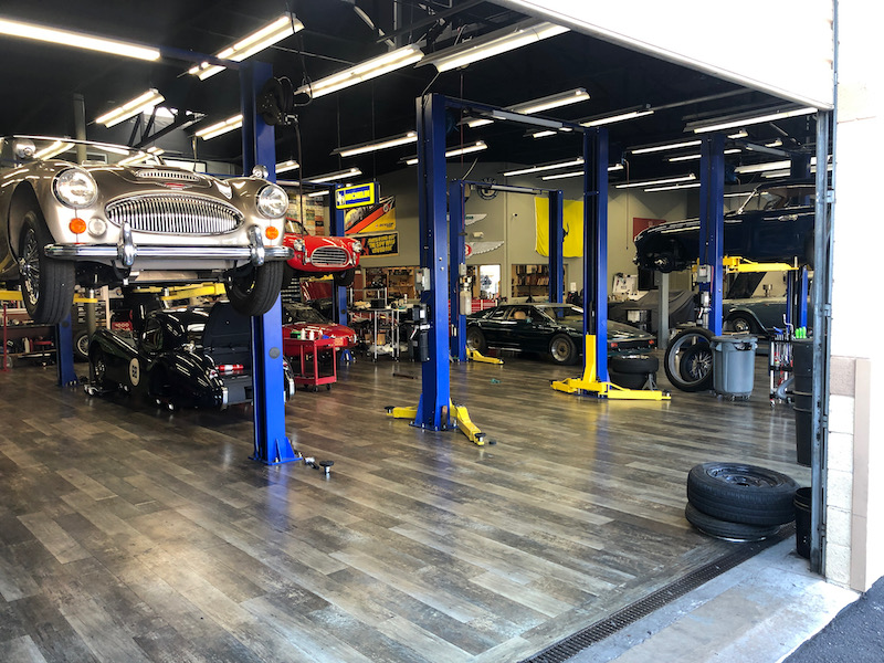

Made the trip from UT to AZ last weekend, safely delivering the car to the shop for work. Borrowed my FIL's nice F150, traveling in style! My friend and I co-own the trailer -- we both own old British cars so it's handy to have. ;)
The shop was working on some really nice stuff, ranging from a MG TD to a TR3 to an AC Aceca and an Aston DB2/4. I think my little B is in good hands.
About 45 mins from my house, Mt Timpanogos in the background

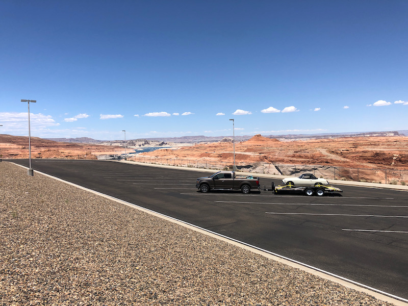

Lake Powell (Glen Canyon Dam near Page AZ)
The shop

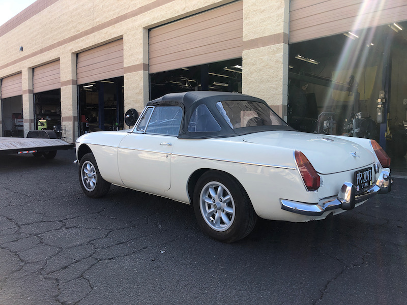

My B, off the trailer and waiting her turn
The main work I'm having them do is a full engine rebuild and possibly a transmission rebuild as well. They're at least going to open up the box and see what it needs. I happen to have a spare as well (both OD) so I dropped off both in case my original one is too far gone.

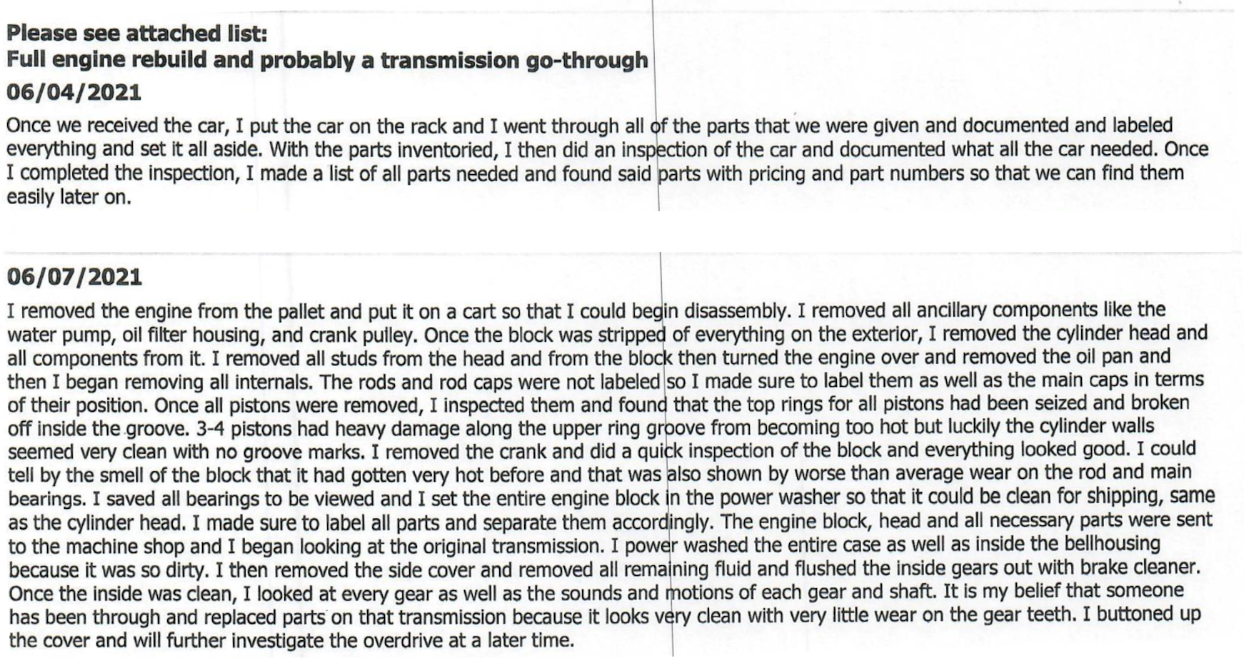

June update from the shop (image as they sent me a PDF for the June bill). In short, all is disassembled and cataloged. Looks like I made a good call to rebuild this engine instead of keeping on driving it. Seized piston rings, worn bearings, but cylinder walls and block look OK. Also nice is that the transmission seems to be in good shape -- it was shifting fine before, but I figured we'd go through it with everything out. May be a nice savings if it just needs a looksie and servicing.
I like the detail they're giving me. My friend had similar work done by this shop and he received the same level of detail, so I was expecting it. Still, it's nice to see a clear record of what they're doing. Makes it a bit more pleasant to pay the bill.

The report is a bit more verbose than we'd do but finding a shop that does it at all is rare. Ours were terse by comparison. We also shot many photos as things progressed, I would guess they're doing the same.
