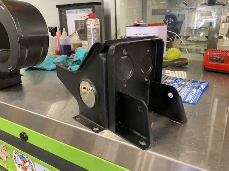

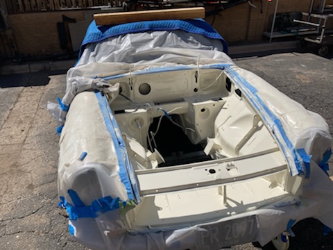

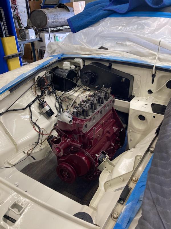

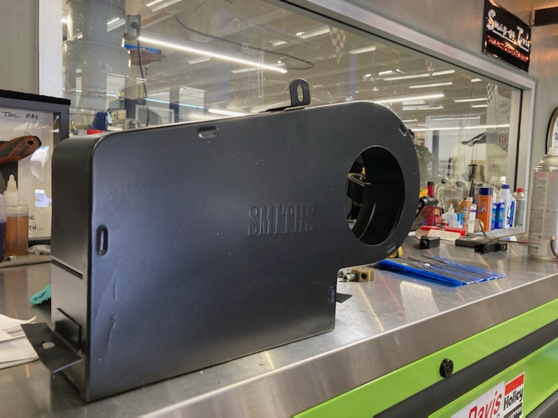

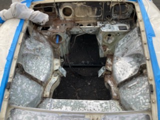

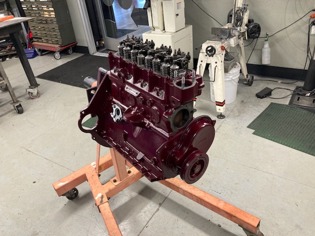

We're making progress! From the shop:
These photos are of prepping the engine bay, priming the engine bay, putting color on the engine bay. We also inspected, resealed and cleaned the four speed over drive gear box. We attached the engine to the transmission and installed into the car.
I'm really glad I decided to get the engine bay painted while they were in there. Wasn't originally going to do that for budget reasons, but ultimately decided to just get it done.
Looks sweet, Drew! And so much easier than waiting and fighting all the masking of engine, wiring and plumbing later.
