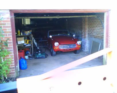

I was pleasantly surprised when I found my bro had cleared out a little spot under the house for Nigel to rest. (It's not really a garage, just a garage door opening into the unfinished basement.) The furnace is behind the car, so it'll be toasty to work on. :smile:

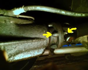

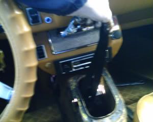

After taking the bonnet off (sorry, no pics of that; I had my hands full!) I took the driveshaft loose from the differential side. This is peeking through the rear wheelwell. Arrows show the bolts. (Hey, you never know, these pics could help someone)

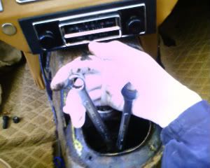

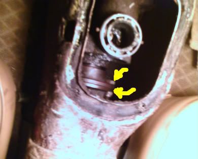

Took the shift gaiter and lever out. This is looking down the hole. The arrows show the driveshaft bolts on the transmission side.
And that's all the time I had for today. Tomorrow is supposed to be bright and in the 70s here, and I have the day off of work, so I anticipate much progress!

-- Your front u-joint bolts are much easier accessed through the shifter hole than up from the bottom through the inspection hole.</span>

Picking up from yesterday, I pulled the front u-joint bolts, and yes, it IS easier from the topside!

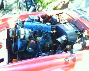

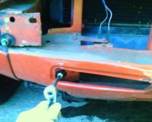

I discovered what that little round holes behind the fascia slots in a 1500 are for: Getting to the lower radiator bolts!

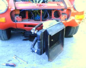

Grills and radiator out in 20 minutes, hoses attached. Aren't these cars amazing? (With a couple exceptions, which I'll point out later...)

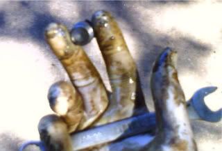

The First Sign of the Apocylpse: shiny metal bits sticking to the tranny drain plug.
The Second Sign of the Apocylpse: uhmm, transmission fluid isn't supposed to be a silver slurry, is it...?

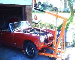

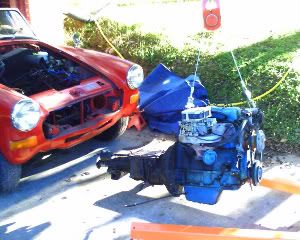

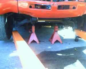

Answering the Big Question: yes, it does fit. Barely. The legs skim the inside of the front tires, and it needs to be jacked up just a couple inches for the legs to clear the stabilizer bar. (Actually, with the bar unbolted from the A-arms, it might fit, but I didn't try that.)
Ready for action, four hours in...
...and this was as far as it got before the u-joint flange got caught on the crossmember. Argh!

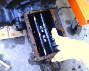

I couldn't help a little preliminary peek. Reverse is a little chipped, the synchro teeth aren't really sharp...hey, is this gear supposed to wobble around a half-inch? No, I didn't think so.
