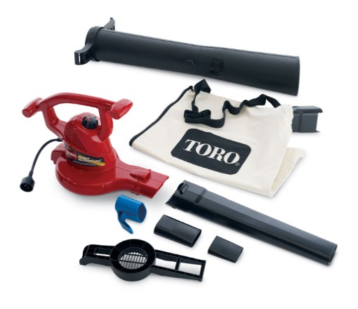

Richard, don't listen to those guys. Here's what you need.
A Toro leaf blow, model 51609.
Air speeds up to 235 mph and air volume up to 390 cfm.
This is the most powerful one I could find. (I use it to blow the water out the spokes after I wash the wheels.)
Retrofit it in place of the Smith's blower! For the purists, paint the red plastic body black and do some creative wiring. Then hold on to your socks!

Patrick67BJ8
Roger,
The electric powered leaf blower has way too much current draw for the Healey generator. The gas powered one solves that problem! The driver OR passenger can strap on the turbo boost model with backpack option and eliminate permanent mounting. Painting the backpack the interior color helps camouflage it! With exhaust pointing towards the Boot should be good for better gas mileage. Ear plugs are strongly encouraged!
